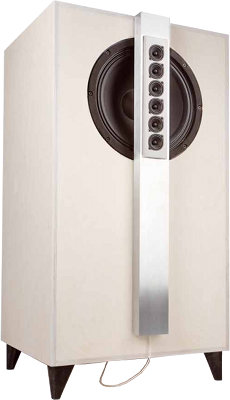

Hi all,
Recently i started my very own first project based on Phi by Klang und Ton design. Thread link > Help chosing high SPL drivers for 3way classic loudspeaker
Nominal sensitivity 95db @1w/1m
Xmax for speakers is 20w @115db, so we can conclude they are pretty sensitive 🙂

Let's start with Joppa's Rule, which states that in "typical" listening spaces an amp/speaker combo should be capable of producing 102 dB. SPL peaks at a 1 M. distance. Upwards of 6 WPC are needed.
As a DIY project is on the horizon, don't rule out PP EL84 or 6V6 amps that have been or will be triode "strapped", as the interim solution.
BTW, crossover complexity could make circuitry containing loop NFB, with its better damping factor, desirable.
