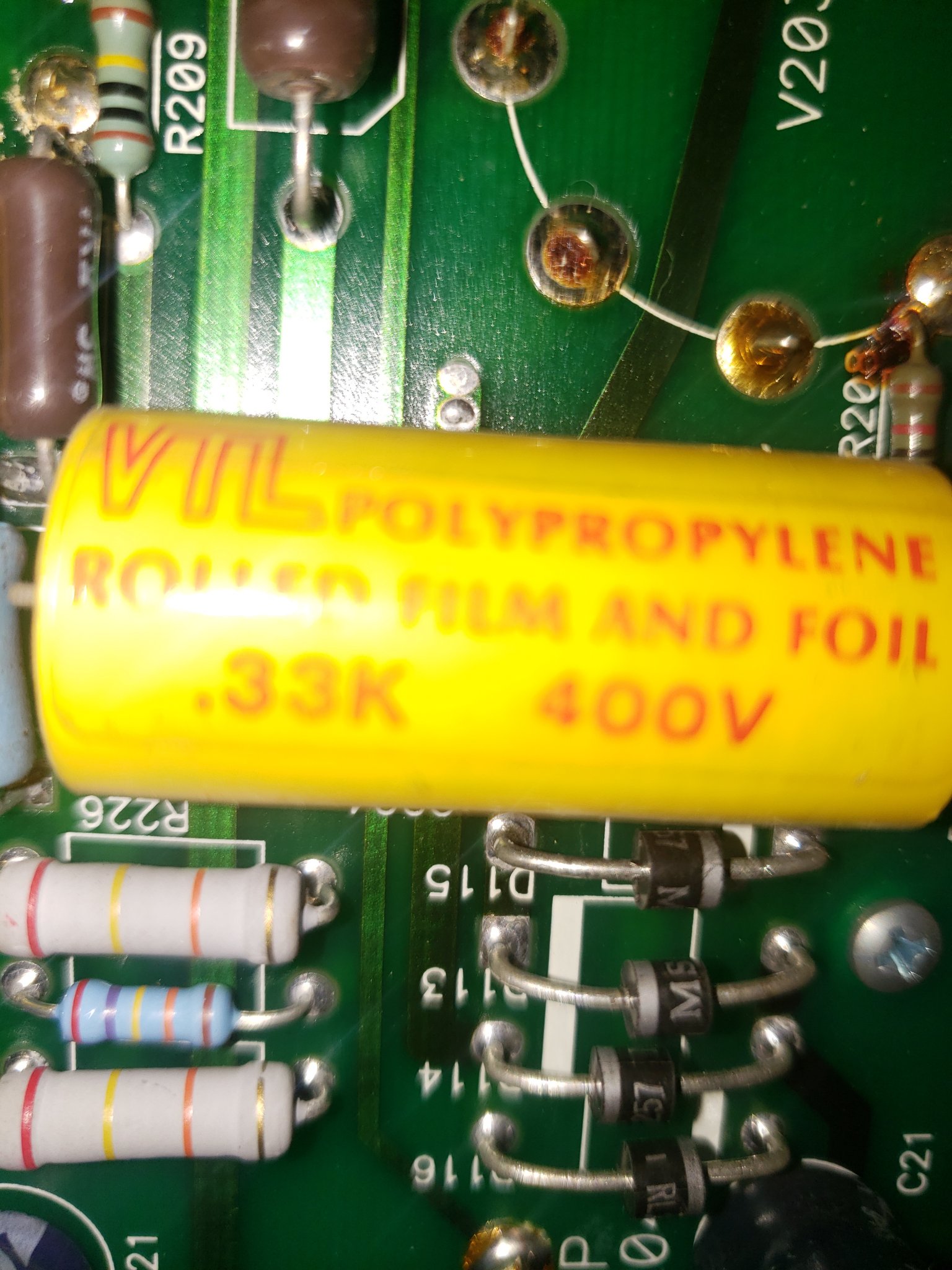

I have a VTL ST 85 amp that I want to upgrade the coupling caps in. The current caps are VTL branded show .33k 400V. All of the possible caps from the likes of Mundorf, Solen, Infinicap etc. seem to be labeled in microfarads or uf. If the common nomenclature for the K after the .33 is picofarads, then what is the microfarad or uf. conversion? Is it a .33uf cap? .00000033uf? Thanks in advance.

Ok, so that is a .33 uf 400V cap with 10% tolerance? That simplifies things a lot. Thanks.Capital K means 10% tolerance.
