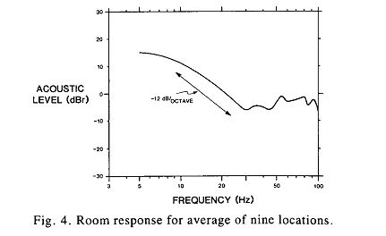

forr, what you're saying matches Rob.
Apparently, most rooms have gain from 30-60 hz. I should go for a oversized/tuned low/EBS vented such as referenced on
http://www.danmarx.org/audioinnovation/theories.html
forr said:To avoid to build speakers un-necessarily going too low, this is an average room response published in the JAES paper,
"Subwoofer performance for accurate reproduction of music"
by Fielder and Benjamin
That pretty much equals my room, but the gain stopped at 12Hz so I guess room construction plays a part.
