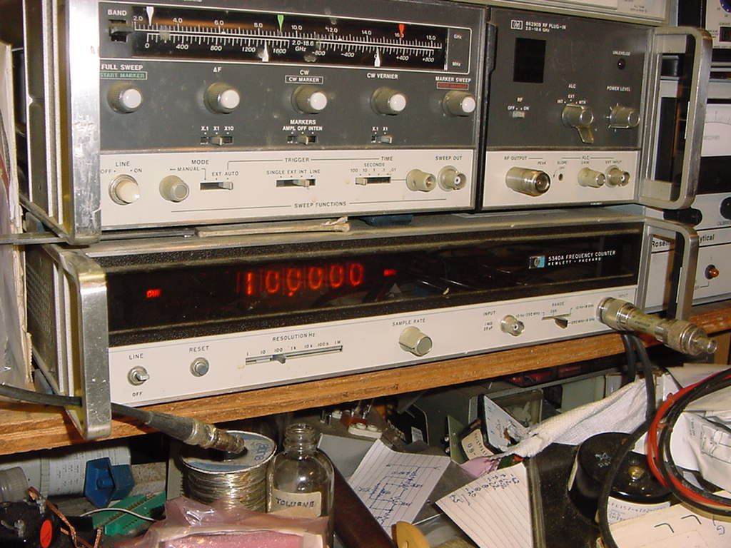

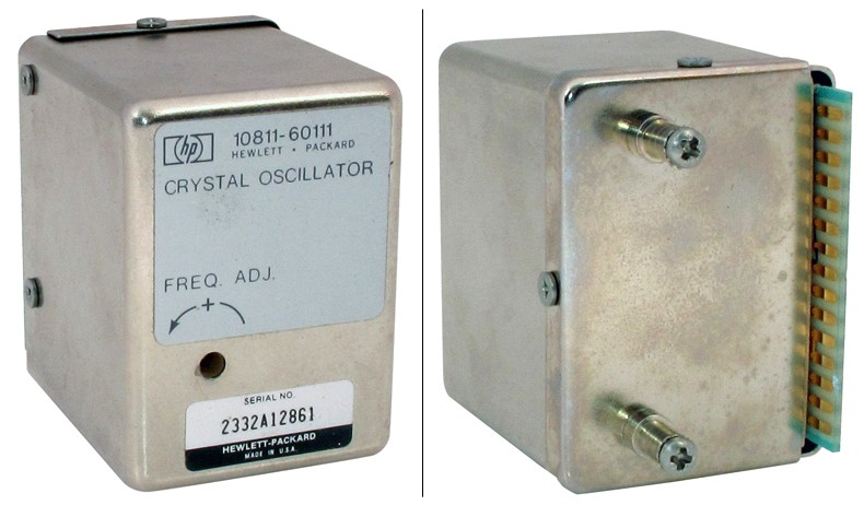

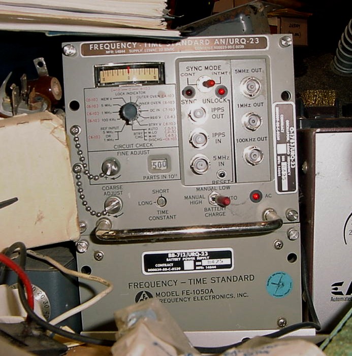

Almost anyone working in electronics will find a frequency reference useful at some point for something. I've had several of them at my bench for many years. Although I don't use them much anymore, the timebase in my microwave counter has a high stability TCXO that is always on as long as the counter has AC power. The output cable is on the left handle. Then there is a stand alone 5 meg source with 1 meg and 100K Hz divided outputs. It's an AN/URQ-23 from the military with battery backup. The crystal is enclosed in a Dewer flask. I was told it was part of the early patriot missile system. I also have a small 10MHz rubidium oscillator somewhere that I never did hook up. Maybe I should get to that someday. All it needs is a small 24v DC source and a cabinet.
Numerous rubidium sources can be found on eBay. murphyjunk in California has a nice one pretty cheap. He sells it with the Winchester connector that's hard to find alone. This oscillator will need to be mounted on a heat sink because they were used in aircraft and so have an extra heater, but not a big problem.

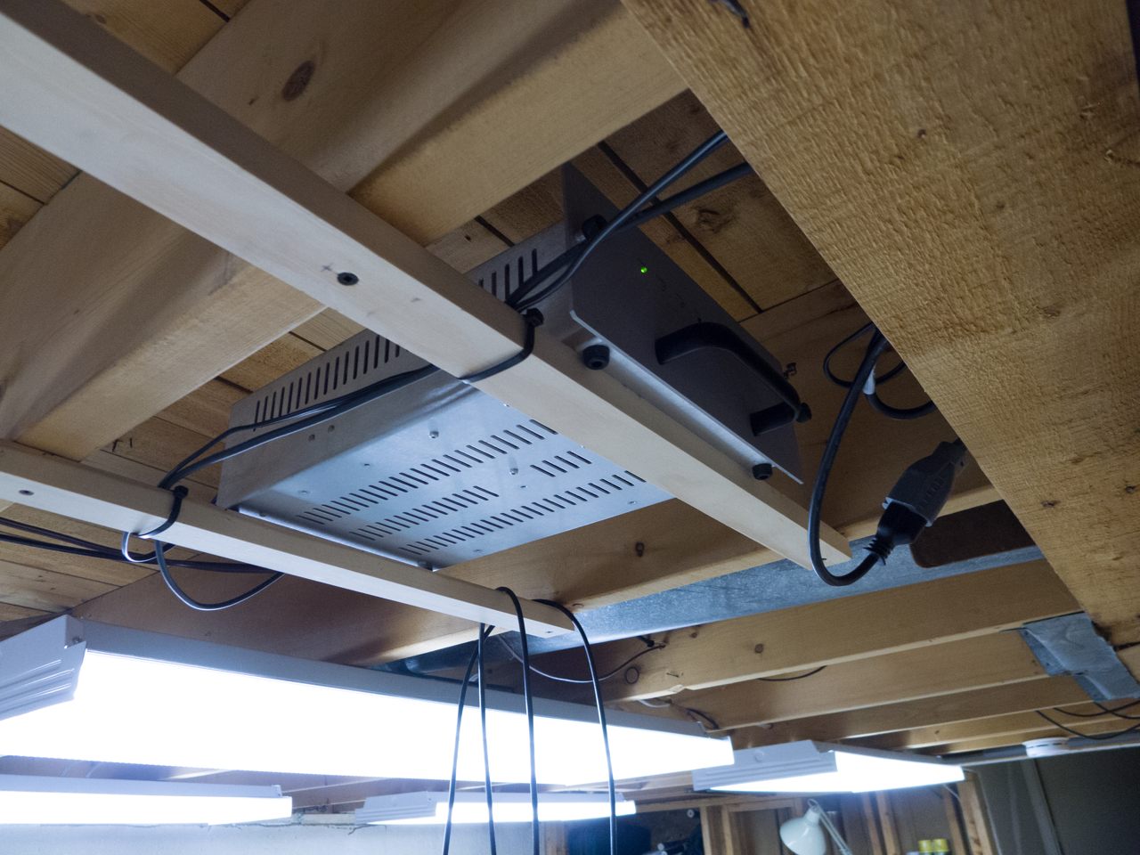

Years ago you could buy surplus Hewlett Packard Z3801A GPS based frequency standard used to synchronize CDMA cellular land network wireless base stations.
I picked up a couple of them at a hamfest. They required some jumpers on the main board and 48vdc power. There is free software (Satsat) for control and monitoring. They output a nice 10mhz signal. I use one on my DMR repeater and the other for Oscope and spectrum analyzer.
There are some Chinese versions out there and you can still find the HP and Trimble units.
