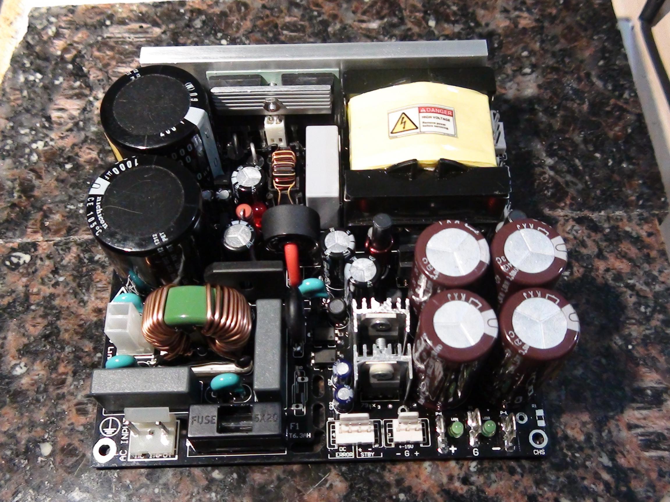

Dont know if my SMPS is an option.
600W unregulated SMPS
65US$
Regard

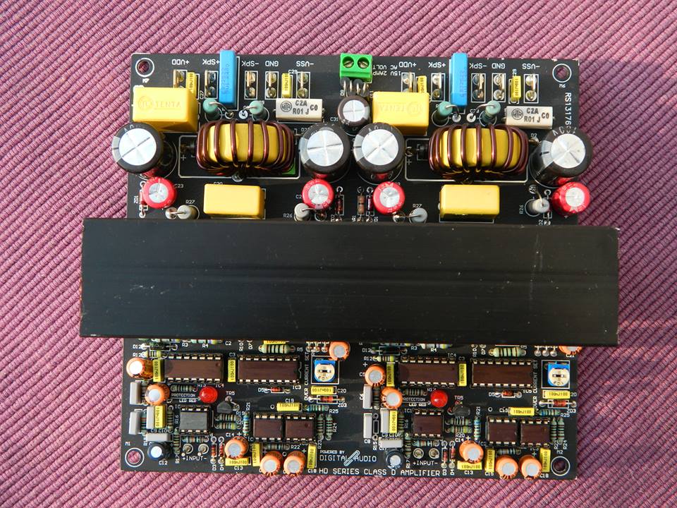

You could DIY a full bridge from two half-bridge amp modules and a bridging circuit. You will need a 2ohm stable amp, for example the LJM L30D (actually digital this time!):
http://www.diyaudio.com/forums/class-d/280531-l30d-irs2092-irfb-4227-iraudamp9-mydiy.html
Sold on Ebay and AliExpress, perhaps other places.
Two of these amps, operated out of phase, should give you what you are after and should be capable of well over 1000W into 4R with +/-65V SMPS rails.
