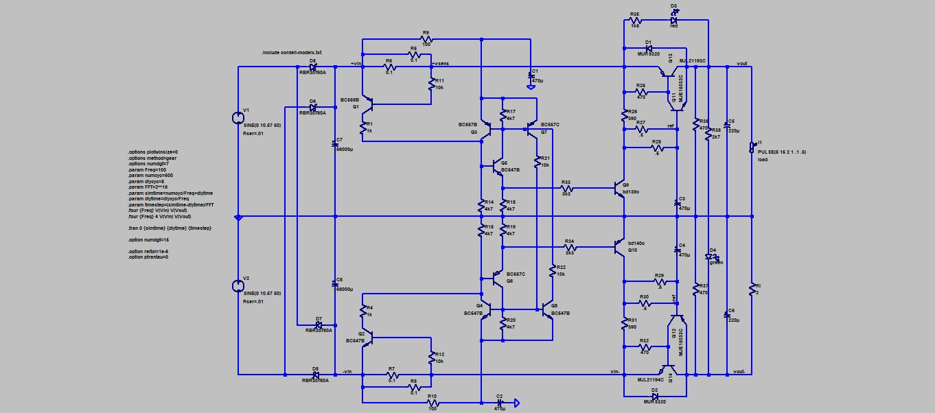

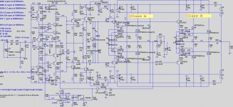

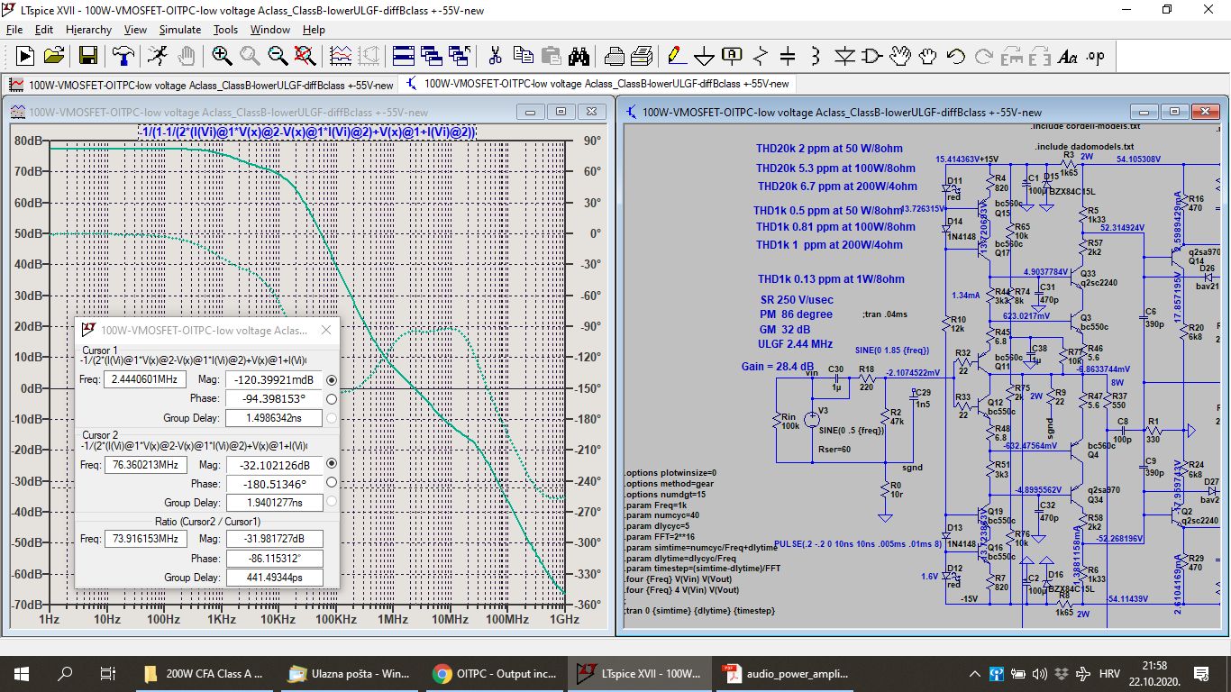

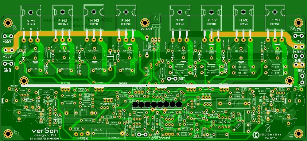

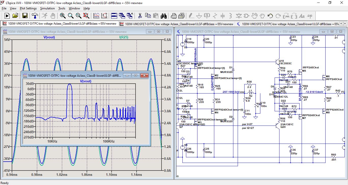

This amplifier I built two year ago. It is Class A OPS bootstrapped by Class B.
It uses my OITPC compensation and it needs low voltage floating power supply for the Class A OPS.

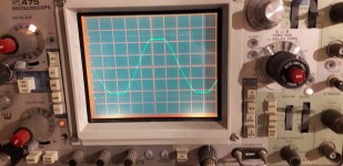

1. Shows the Loop Gain plot

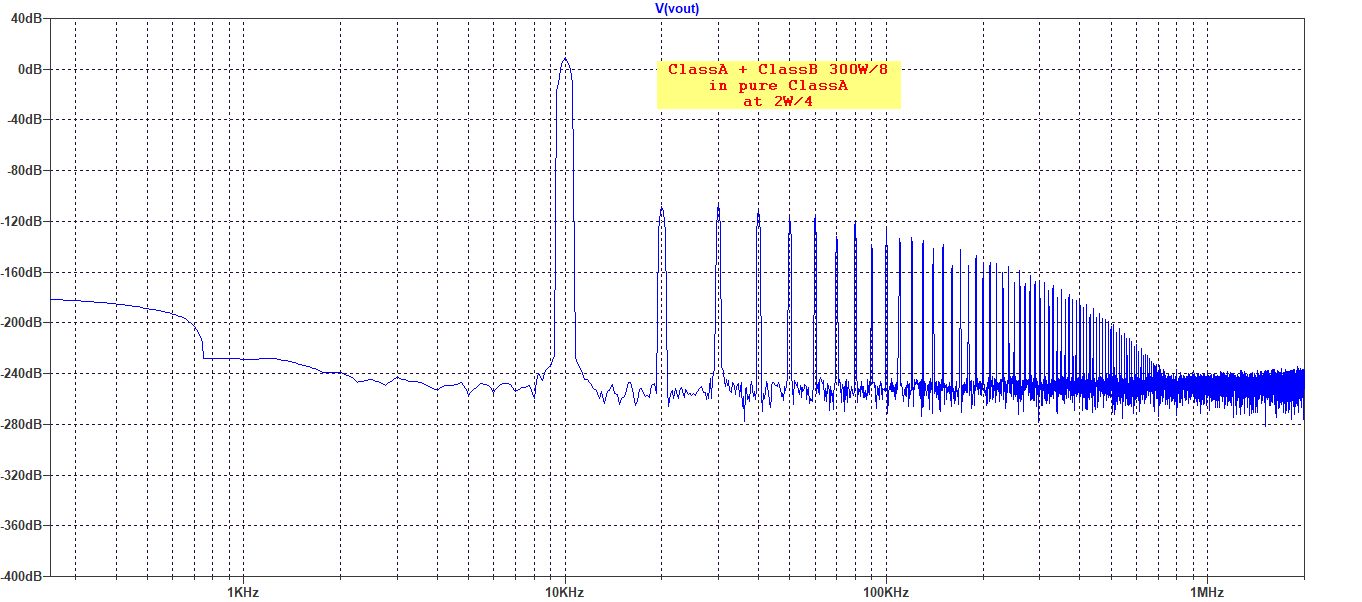

2. FFT at 10kHz on 2W/4R

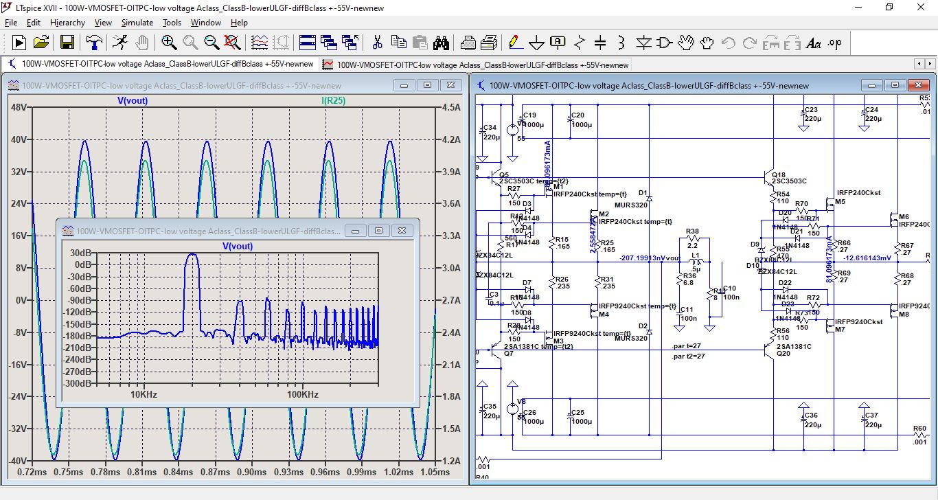

3. 100W/8R
4. 200W/4R

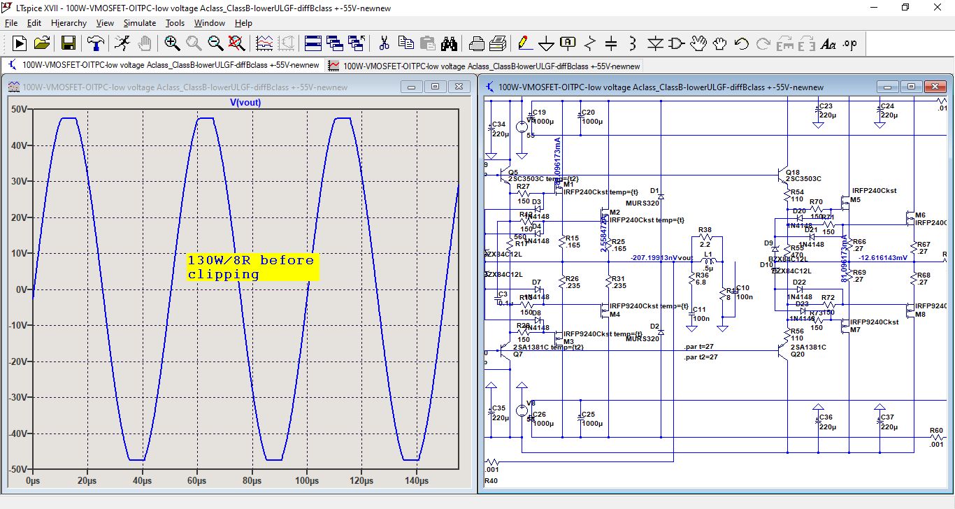

5. 130W/8R before clipping
By the way Class A OPS bias current is set to 2.5A
Damir

3. 100W/8R
4. 200W/4R

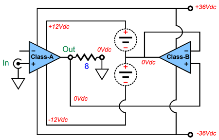

This is a form of class H with floating supplies instead of fixed supplies with series diodes. The things I would watch out for are:
Ed
- Floating supplies can couple supply noise into the signal since "floating" precludes filtering with respect to ground.
- The class A amplifier needs good supply rejection to avoid passing through the class B non-linearity.
Ed
This floating supply is connected to the ground via ClassB OPS.
My intention was not to get better effciencies only, as the the efficiencies of this amp is close to ClassB efficiencies but with sound quality of a ClassA amp with ClassB efficiencies.
I don't think is over complicated, simmilar to my ClassB CFA amps with just two different OPSes, low voltage ClassA and high voltage ClassB.

In post #4 you can see the values of the Class A and Class B OPSs, 2.5 A and 81 mA. That was as I simulated it.

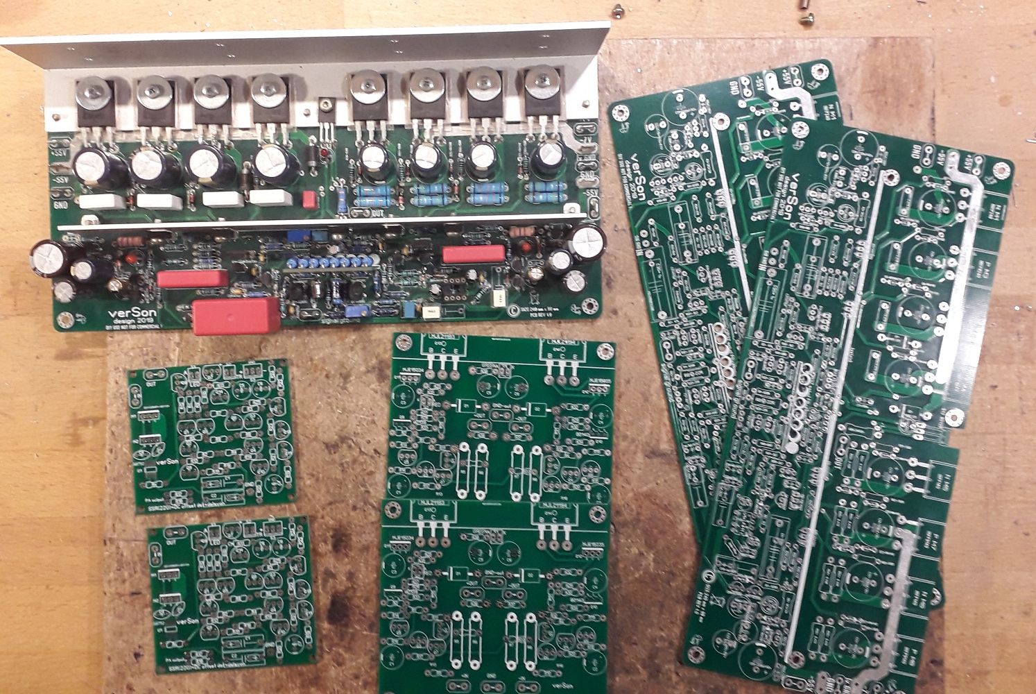

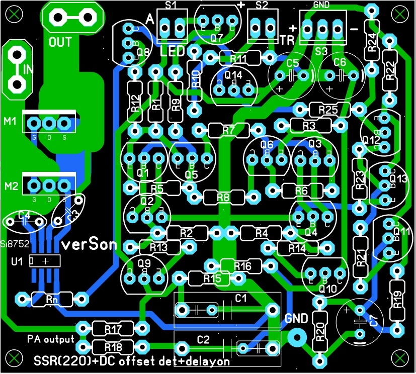

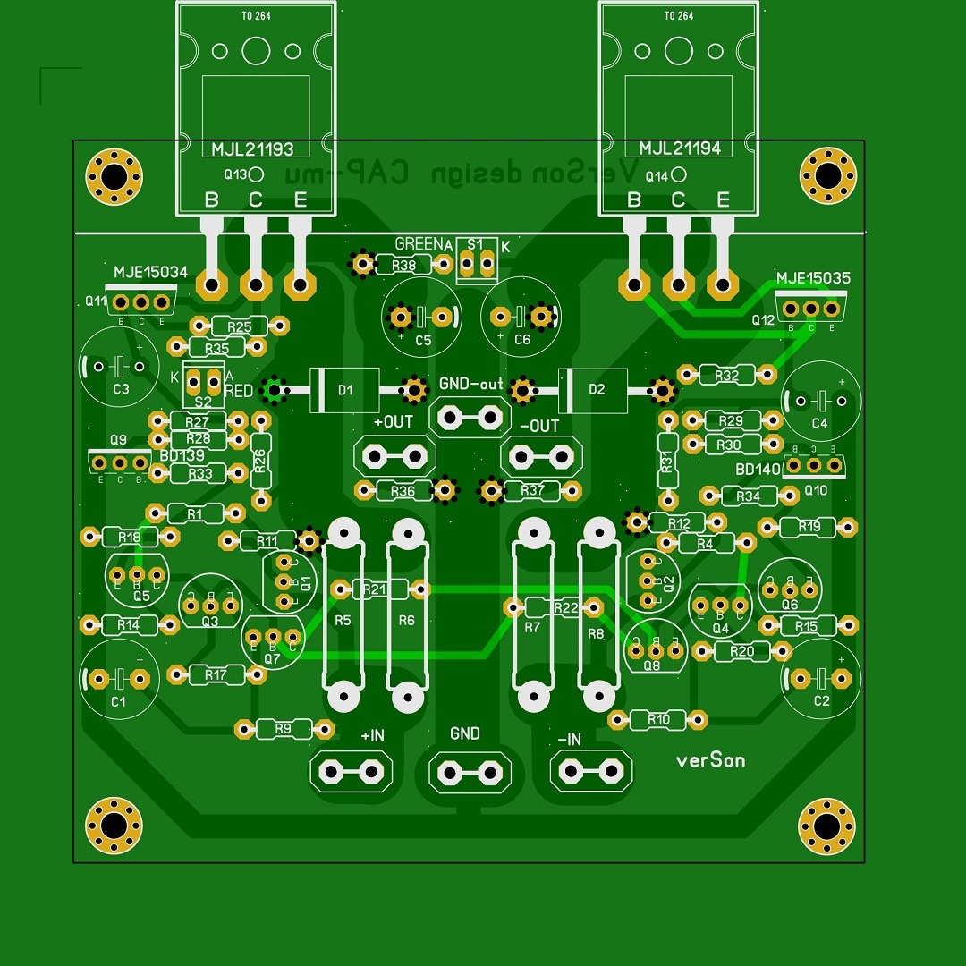

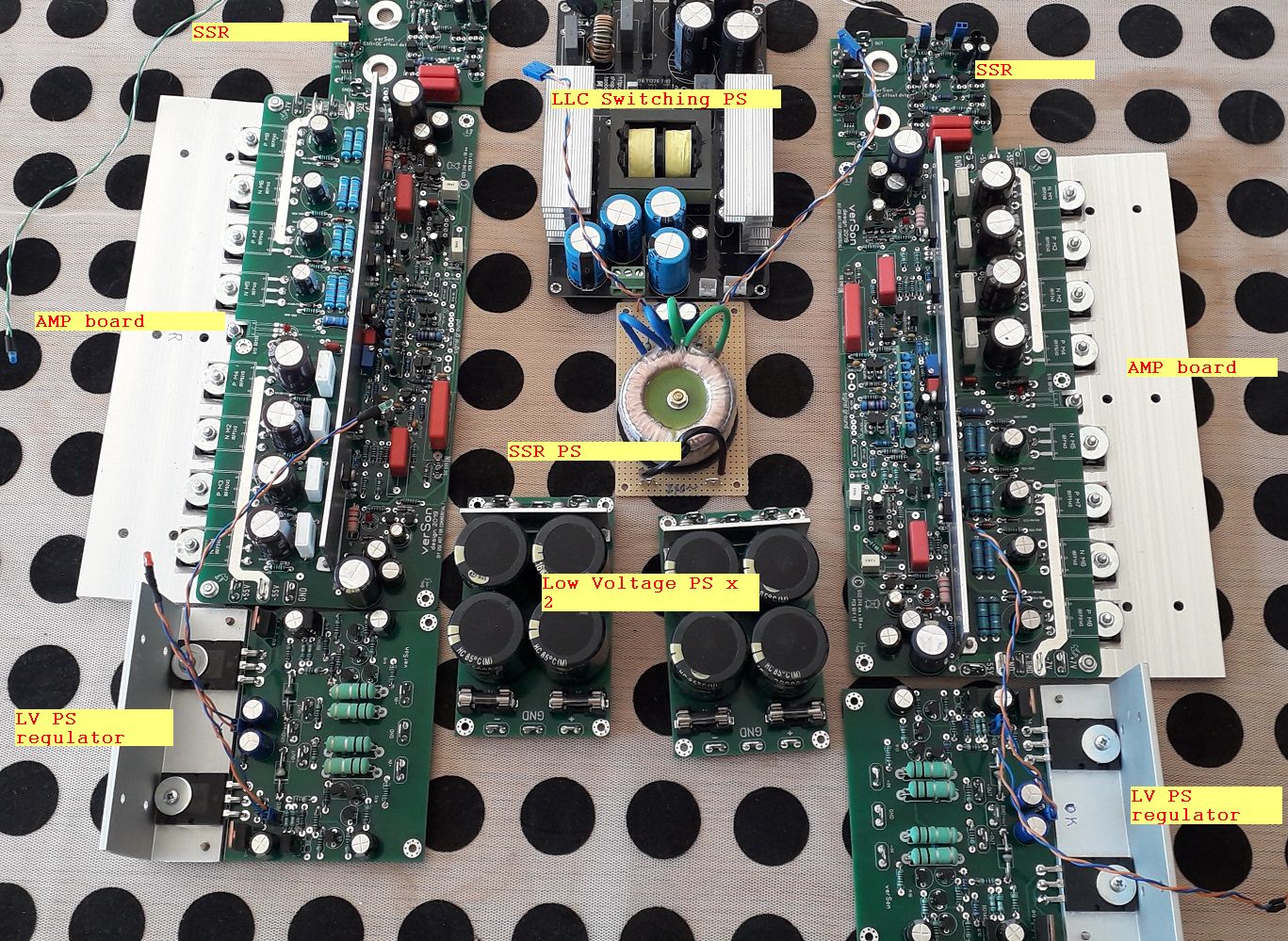

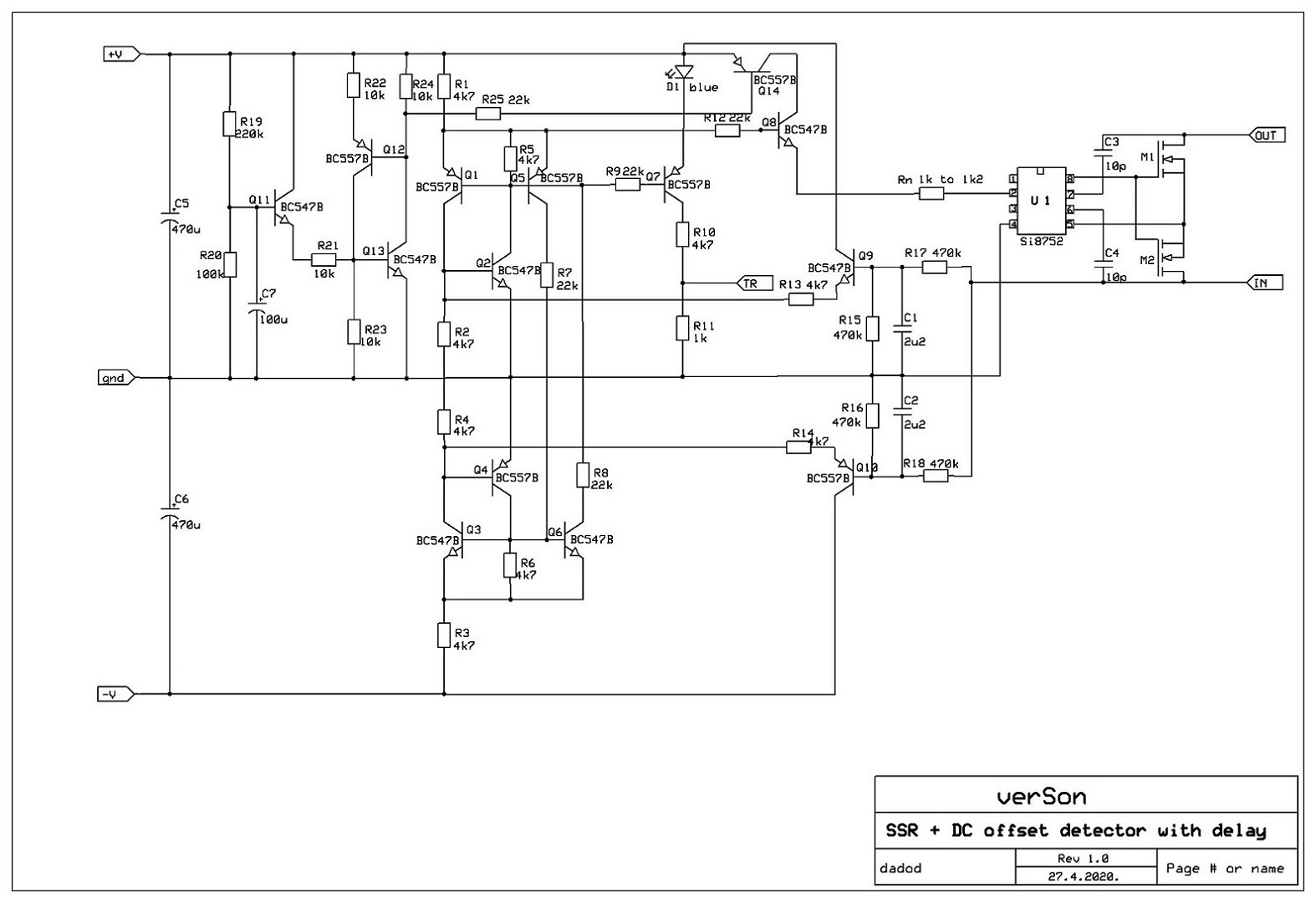

From this project there left some spare boards and if someone interested to build this amplifier I can offer a set for one amplifier.
The set contains two main amplifier boards, two low voltage power boards(capacitor multiplier type) with overcurrent protection and two SSR(solid state relay) with delay on switch on.
The price for the set is 100 EUR plus shipping.
Finished main amplifier board is an example how t looks.
