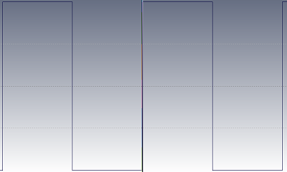

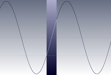

A stable clock is great, but what happens if you have to connect that clock signal to a converter with a cable?
The cable acts as a low pass filter, it has inductance and a capacitance. And at these high frequencies this matter.
The dark parts of the picture represent the amount of jitter.
