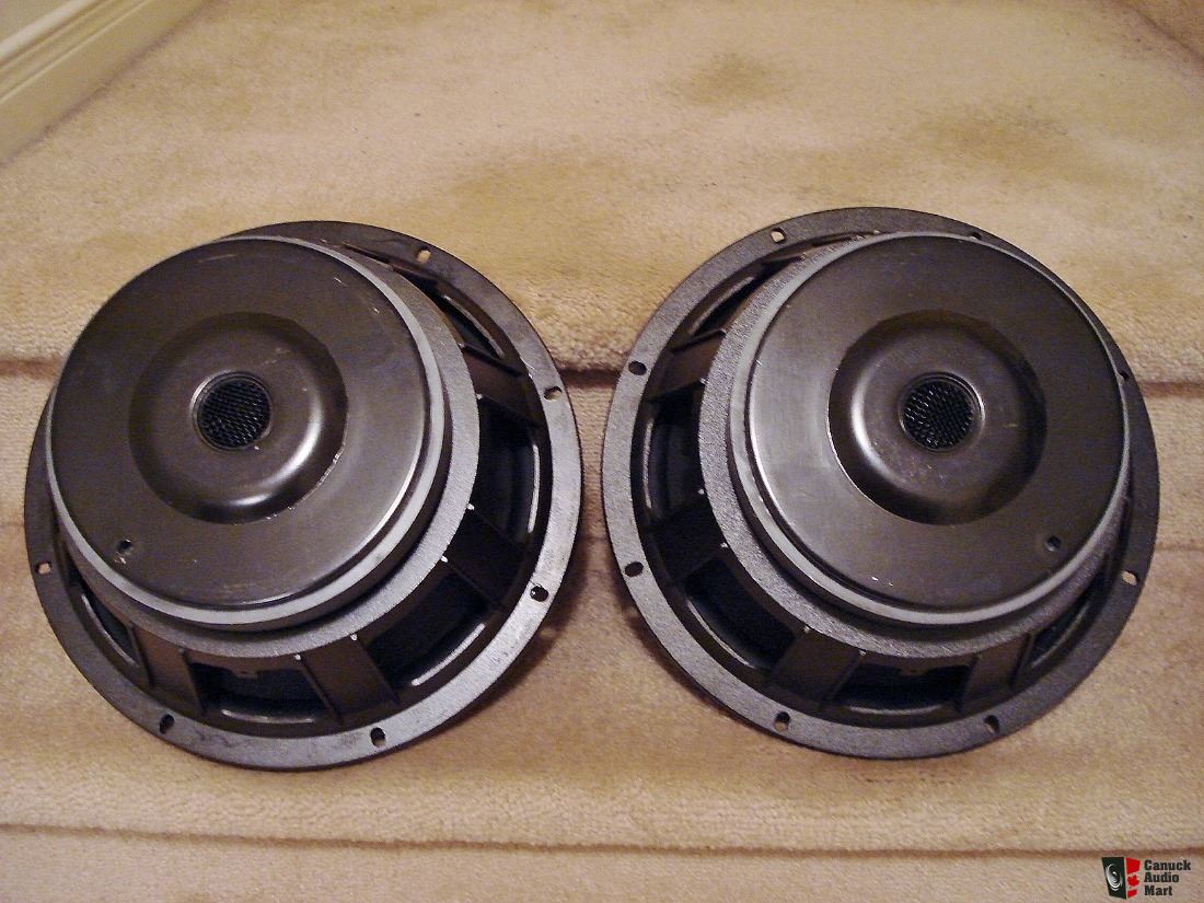

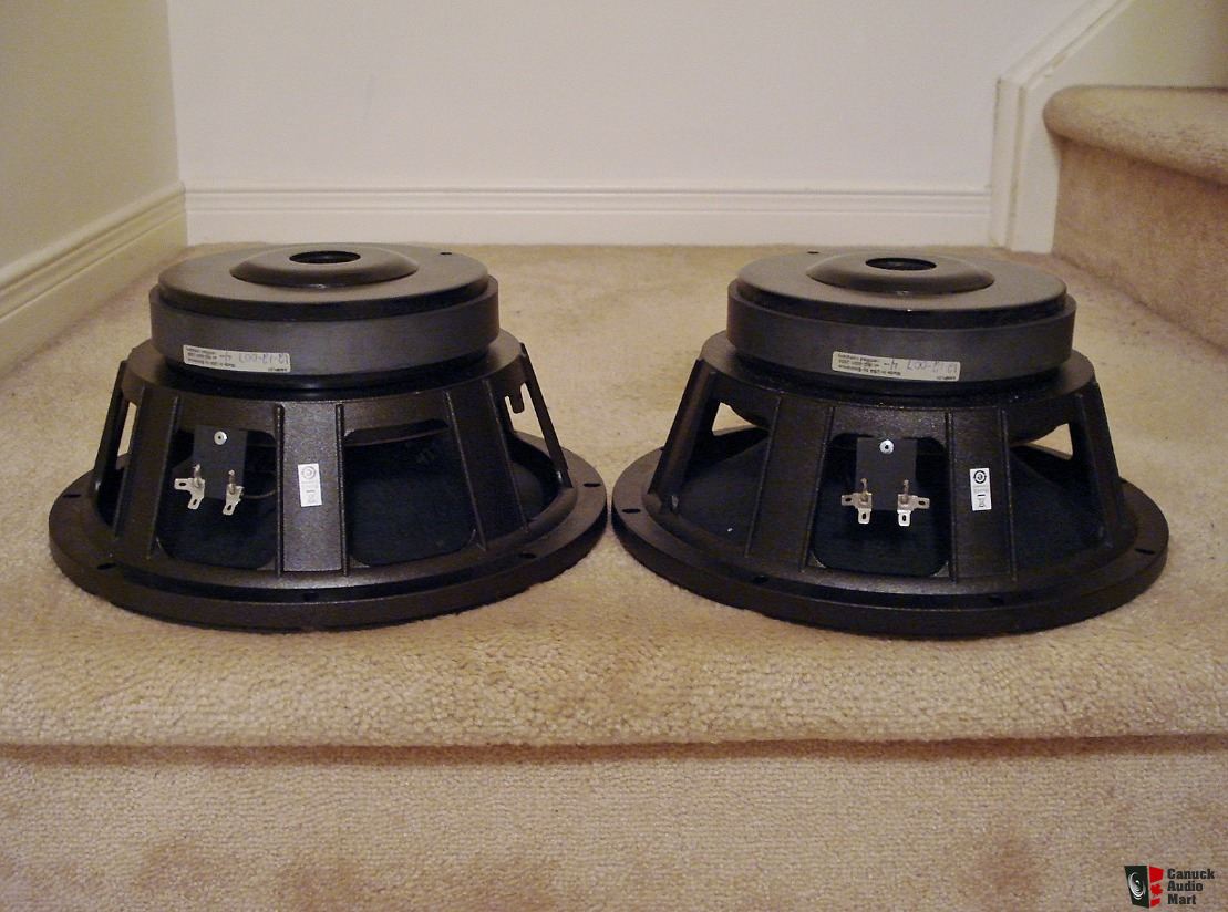

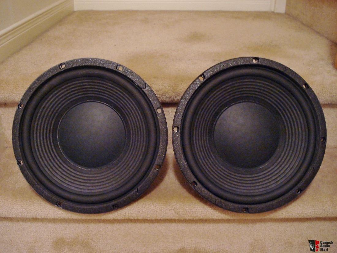

I thought someone might have details for these and parameters. I'm curious if they would work good in subwoofer boxes?
They look the part. But how would they perform with home A/V?
Stick 'em in a box, find out how they perform ;^).
The surround looks like they probably have no more than 8mm Xmax.
Appears to be an OEM variant using the Eminence Kappa Pro-12 frame, which weighs 16.60 lbs (7.53 kg).
Cone looks heavier, surround may be more compliant, so may be considerably lower Fs than the Pro-12.
Don't know about nowadays, but use to get the specs from the factory; even proprietary ones if obsolete.

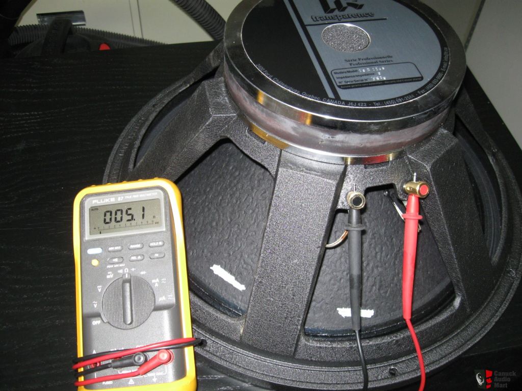

For my own personal project I had been looking in jbl domains. This company TRansparence is getting more of my attention.
Possibly this driver http://www.tr.ca/2006/english/produ...06/english/products/loudspeakers/15b-1200.htm
How good would that big 15 work sealed? I will by a program so I can quit asking ;( The "free" ones only always seem dodgy.
