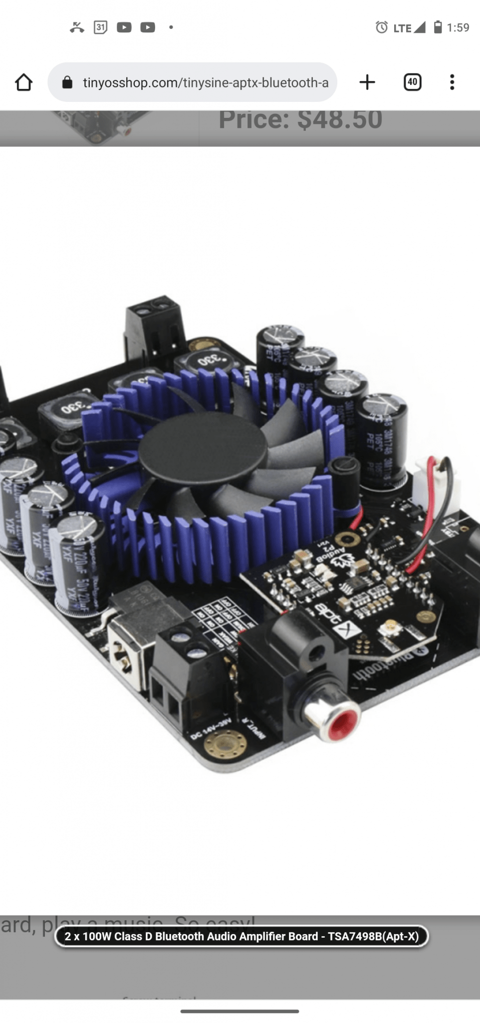

Tinyshop stuff looks promising but I am a bit worried about the fan. The amp will be in a sealed enclosure.

There are some heat sinks, but I don't think you'll have heat issues running off a 19v power tool battery.
Some tiny shop amplifiers have a heat sink and a smart fan that is supposed to kick in if temps go over 65 degrees. Because the amp will be in enclosed 20L box I am worried about heat accumulation.

I attached a pic of fan on amp. 100w x 2 preferable amp

I don't blast music loud. ) But usually prefer to make things with lots of headroom for potential heat issues or someone else blasting loud music now and then

Is there a chart of temperature and power. How hot the amp gets during a particular temp. Maybe it won't really reach 65c that often

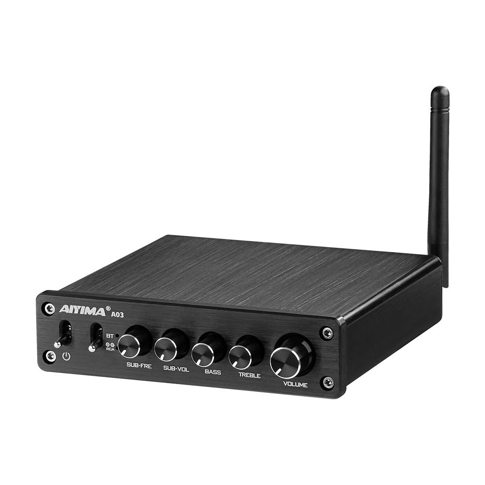

AIYIMA A03 2.1 Channel TPA3116 Subwoofer Bluetooth Amp HiFi Power Amplifier DC12-24V 50W x 2 + 100W (A03 Black+DC 24V Adapter)
I found this interesting amp. Is there anything subpar to tinyshop.
It doesn't seem to have aptx. My phone has aptx.
But seems like aptx missing is not a big deal if you have Bluetooth 5.0
https://www.amazon.com/XY-S100H-Cha...cphy=9004365&hvtargid=pla-1716849037588&psc=1
I like that it has line level out..to run another sub or system. Has any one seen this board used by other brands? Any issues or problems with these?
