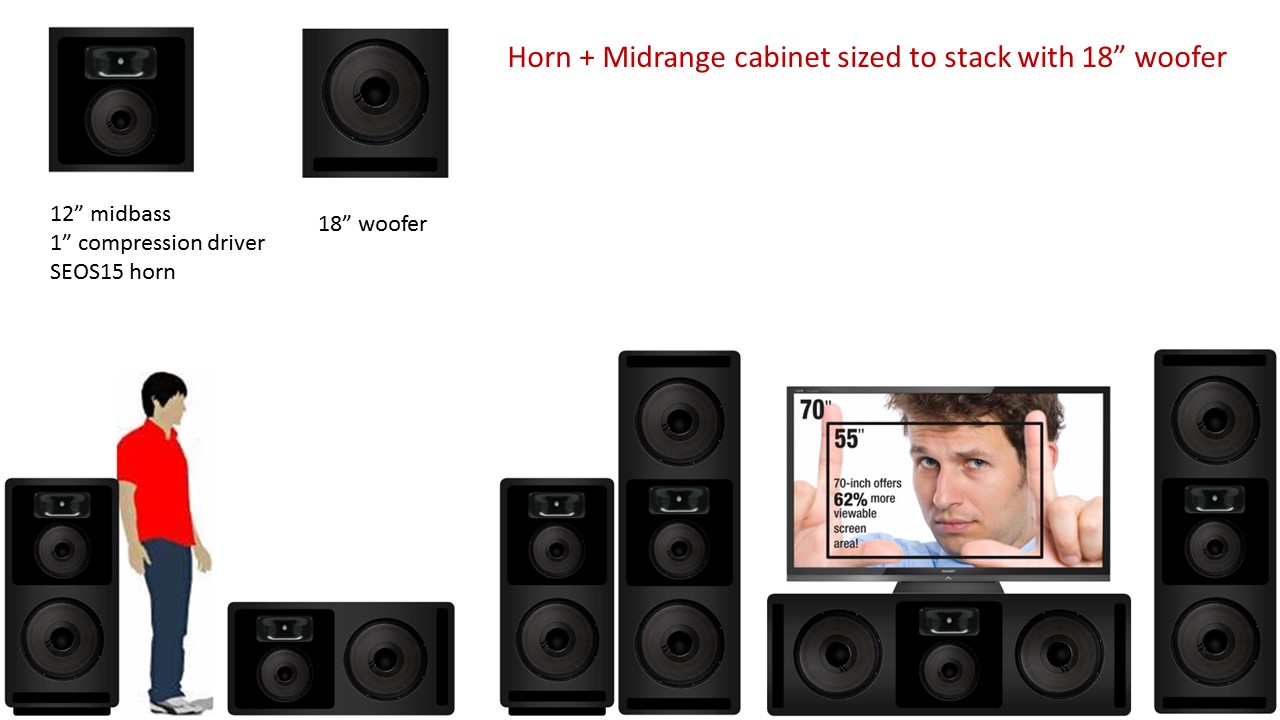

Mark Levinson has made BIG & TALL attractive with his Daniel Hertz M1 speaker. 1" horn + 12" midbass + 18" woofer
The Tweek Geek audio Boutique in Colorado uses a pair of counter-force 12" woofers to match the area one 18" woofer.

As this is got HT I would omit those 18" drivers as the frequency range <80 Hz should be taken over by your subs. Bass reflex is very useful to control cone excursion when used with appropriate high pass filtering and aids driver cooling if operating at sustained high power (by selection of a high tuning frequency). Reducing cone excursion reduces the modulation of higher frequencies the midwoofer has to produce and reduces harmonic distortion so increases fidelity.

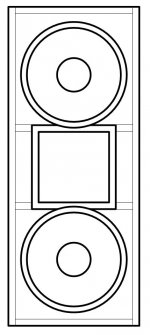

Current speaker I have are 2x 8" and just don't have the kick I'm after.
Hard bounds for this design are as follows.
1. This is to be a 2-way design.
2. Horns are to be RCF HF94's.
3. Woofers are to be 12".
4. Cabinet width is to be around 15-16".
I'm leaning towards the following.
A ported design as most pro audio woofers seem to be more suited to this alignment and have much more output in the 100-200Hz region. My only concern was whether the extra group delay would cause issue when integrating with my subs. FYI my subs are sealed and will be placed throughout the room to give best frequency response in main listening positions.
A 1.4" compression driver as this will give me greater flexibility in the crossover and allow lower frequencies if needed. I'm thinking the HF1440 would be suitable and shouldn't restrict me higher in the frequency range.
I'm also looking at keeping the center to center spacing between woofer and horn as close as possible for better polar response. I can get this down to about 275mm.

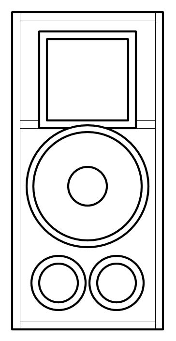

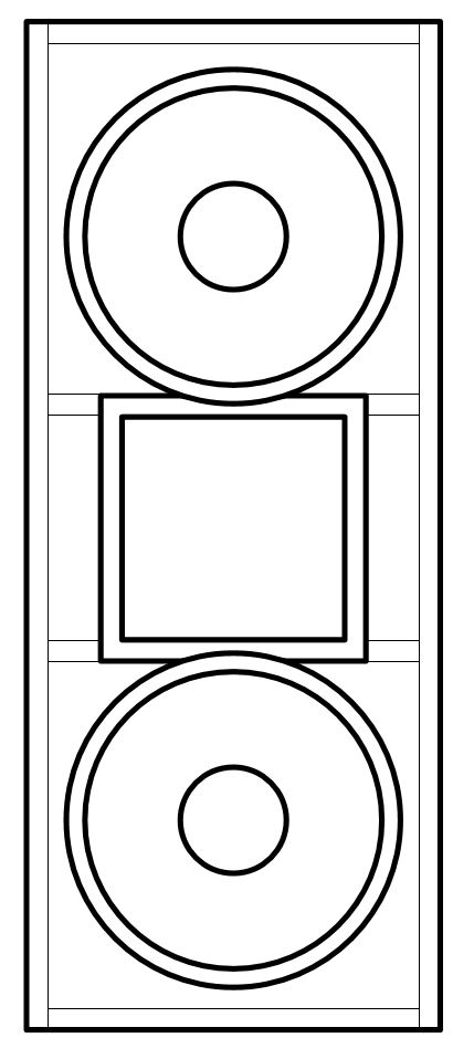

Basic design I'm considering for now is shown in the attached picture.
MTM will give +6dB more output, double the cost, more narrow vertical directivity. Vertical directivity could be too narrow though if crossover point to the tweeter is high. You could always go 3 way which would lower modulation distortion.
Have you considered coaxial? this looks pretty great if your not set on the horn:
FaitalPRO | Coaxial Loudspeakers | 10HX230
The problem with going over 1/4 wavelength spacing is not on axis, this can be corrected with appropriate phase shift for each driver not matter how far they are apart. The problem is the narrowing of vertical directivity and that there will be points illuminated off the listening axis. The reflected sound field is important and if the speaker puts out loads of energy into the room in off axis beams this is going to have a strong variance with frequency. A lot of effort has been expended by Danley, Genlec, EAW etc. producing novel designs focused on getting driver spacing as low as possible.
