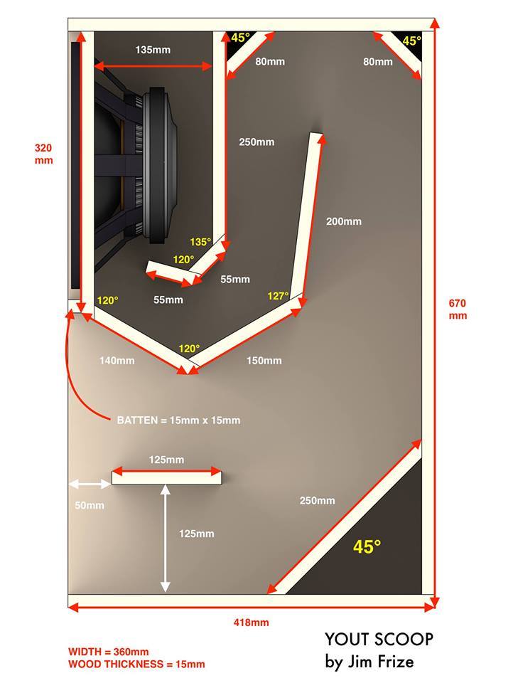

I'm aiming to build a 4-way sound system inspired by typical systems used for dub/reggae music but in a smaller size. The system will be an home system, hopefully usable for small parties with max 20 guests.
I've already found a box design that I would want to use for mid-bass (kick) (already build but not loaded with the raccomended driver): the design
I've spoken to Jim Frize (the designer of the box mentioned above) a couple of days ago and he suggested me to pair it a whit a 2x12 inch scoop or a double 12 inch ported enclosure to hit the low-bass.
However, I'd like, just temporarily, to pair it with a single 12 inch mini scoop for economic and transport reasons. I know that, going this way, I probably can't hit low enough but it's ok for now on been my first build ever.
I've seen a lot of build plans for a 12 inch mini scoop just searching on Google "12 inch mini scoop" but all raccomended drivers are too expensive for me or not mentioned at all ( something like: "just use a 12 inch driver, no matter which u choose" but if i learned something in the last couple of months, scraping web pages for infos, is that this is not the way to handle DIY SS builds ).
I'm looking for a driver in the 80-120€ price range.
Here some drivers that I've seen but I didn't know exactly if they are good for what I'm trying to achive:

Well, none of the drivers mentioned by the OP are fit for a scoop. You need low qts, strong membrane (mostly high mms) and a lot of force (high BL) and xmax.
The Fane FC-123F01 would be a good candidate, just like the BMS 12S305 or the Beyma SM-112/N. But none of these are cheap enough to fit the budget of the OP.

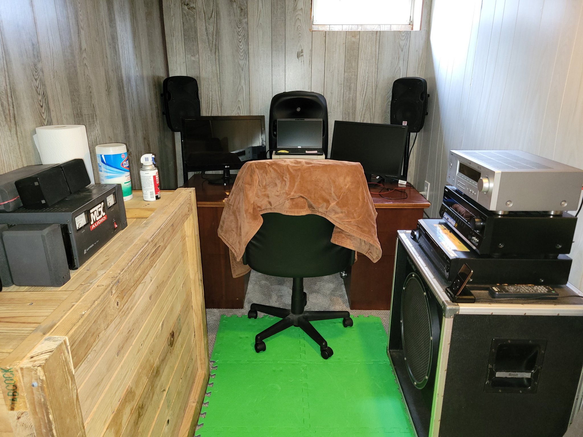

I and the OP are talking about this kind of sounds that he wants to make in a smaller format:
(design and build by Stakx)
I know the guy behind these and heared them and they go very low and very loud. This is how a dub sound more or less is build (altough most do it diy, not a commercial build like this). And those scoops are tuned to 30Hz and get there.
But i agree that scoops are not the most easy or efficient or clean way to get that low. There are many better options, certainly for hifi use.

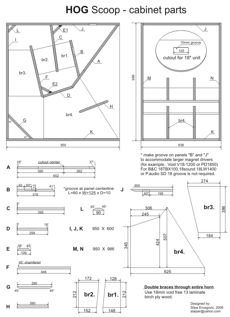

Many thanks to all the forum members who will want to help me
Hello gigi9696,
There are two scooper models available for download in the website below. You can modify, resize and tune them according to the driver's T/S you intend to use. In the tutorial session you can find videos explaining how to use the model if needed.
https://freeloudspeakerplan.rf.gd

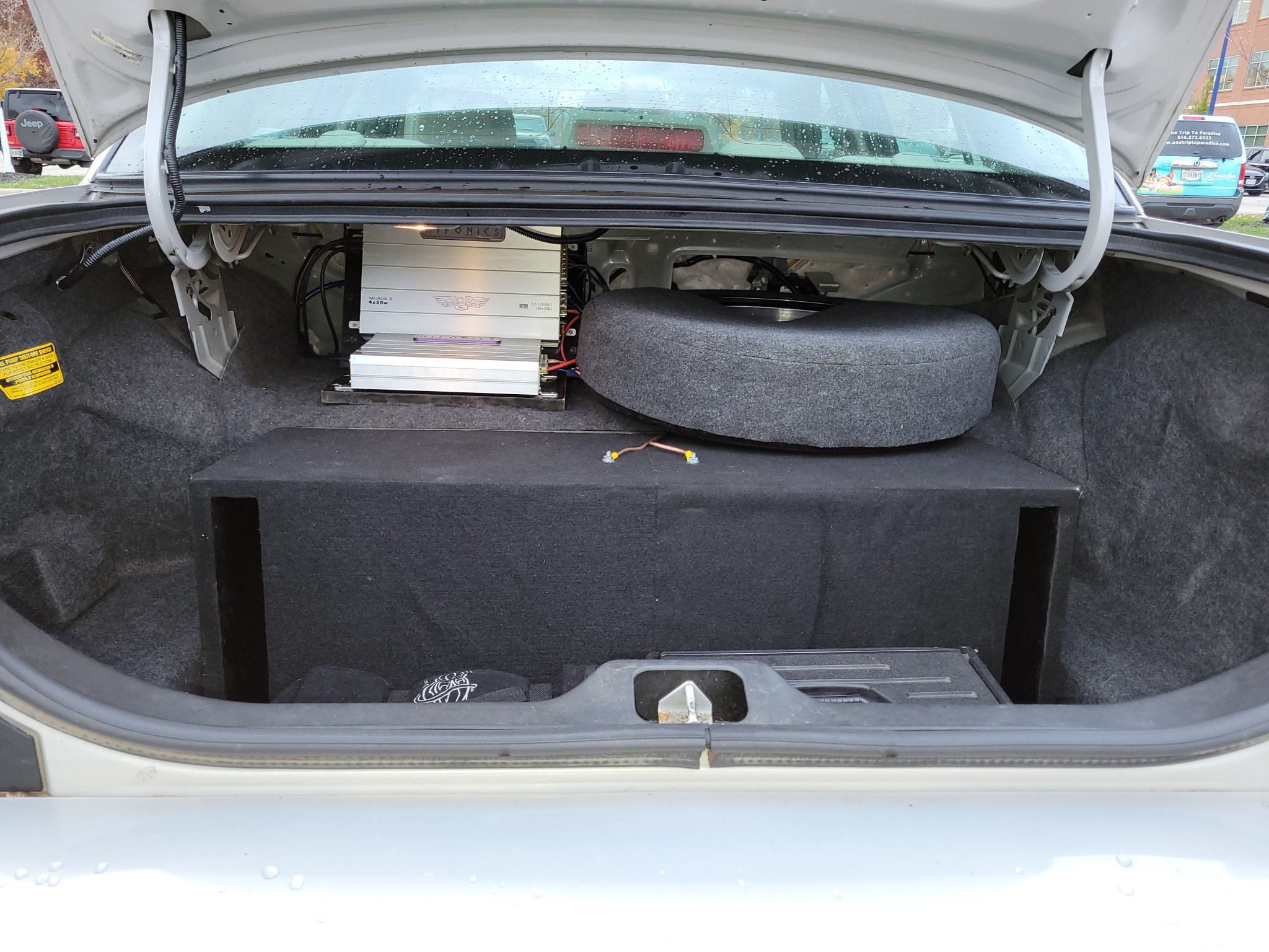

Notice, I have 3 BP's and 1 BR. The 18" BR was a freebie from a church. I built the 2 BP4's and 1 BP6S (15" negative flare tapped horn).
The wooden coffee table on its side has a 2 x 12" BP4 enclosure bolted to it.
My car has a single 12" BP4.
