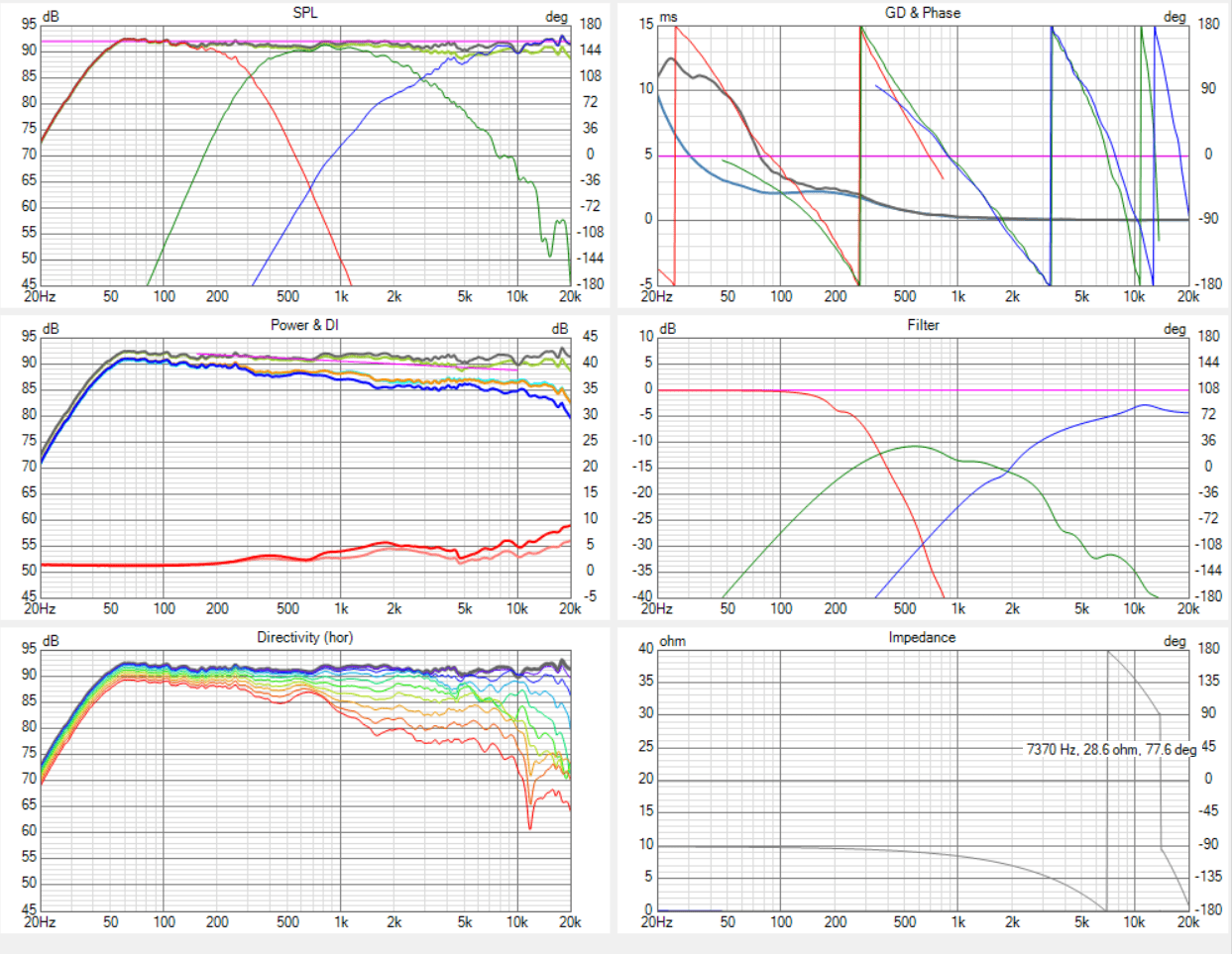

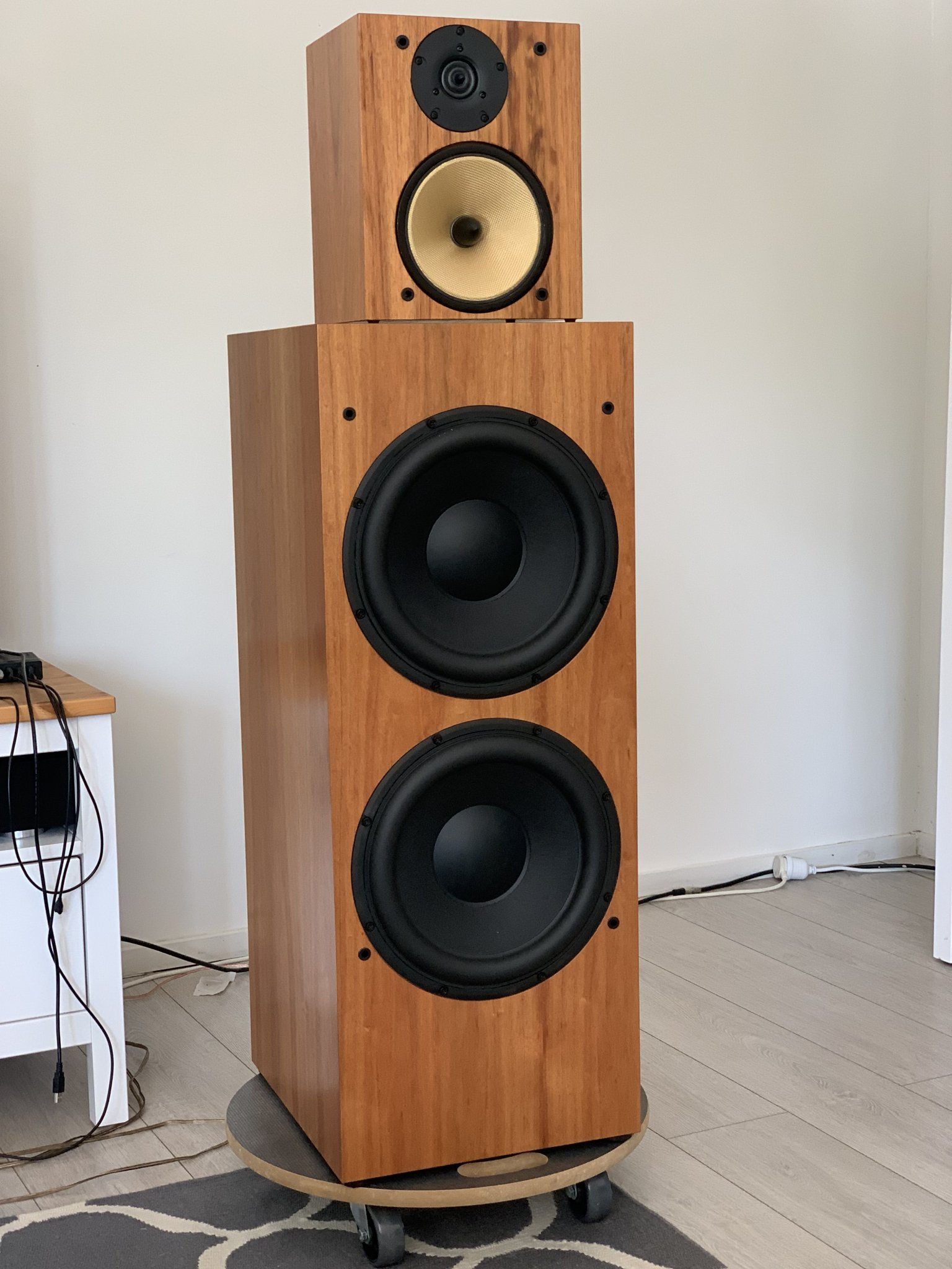

i used the dual 12” XXLS in my recent 3 way. I wanted a sealed cabinet so chose the P830845 variant.
2 woofers in 4 cu ft total hits about 92-93dB/2.83V. Be careful with sub 4ohm impedance if running passive crossover.
Hit 112dB; and I’m not even sure how to measure distortion at that level; because the room is vibrating like a earthquake/tremor that we sometimes get here in northern Australia.
there are other XXLS variants that you can use ported or with a passive radiator. Paper cone or aluminium cone.

but it depends-you’ve stated cabinet size and price; but how low do you want to go and what sensitivity do you want to hit ?
