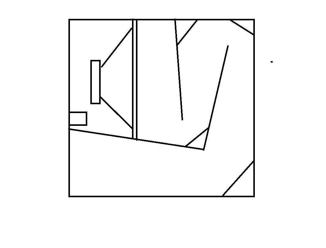

here's a design I came up with for an 18". I call it a scoop hybrid. what do you guys think? This has been built and ready for testing. im just having problems with tunning the ports at the front.
any help is much appreciated.
