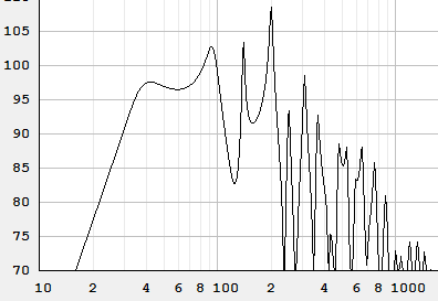

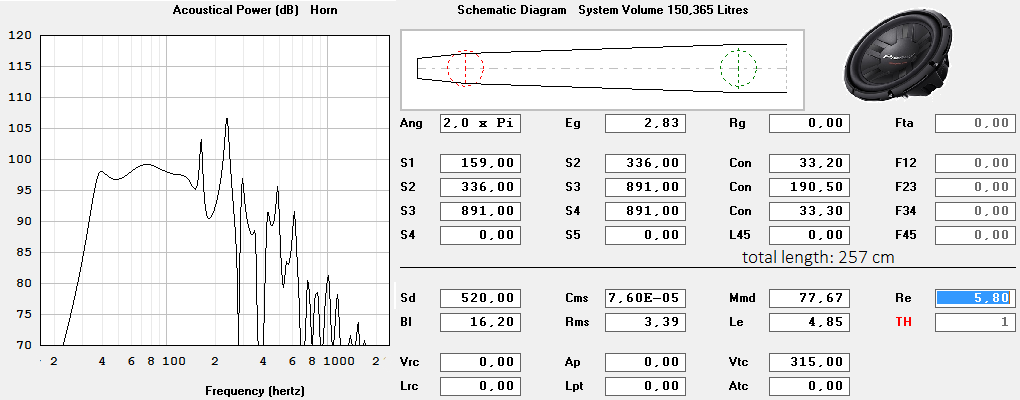

I'm building a 12'' TH for outdoor use, and planning to use the Pioneer TS-W311D4 car sub,(TS-W311D4 Pioneer - Speakers, Subwoofers - Car*Entertainment) I got to thinking: Seeing as the driver with all the "fancy" plastic and stuff on the back of it is pretty big(16 cm deep), do I need to consider this in folding the horn? I mean how much will it impede airflow through the horn, and will I have to compensate for this?
Also on a sidenote, how does this sim look to you guys? I'm still pretty new with this horn stuff, but the design seems to give me the response I'm after(40-100ish hz). And do you trust the specs from Pioneer on this somewhat cheap driver?
Any comments on sim, design, choice of driver and favorite snack are very welcome!

With a 1.05 Qts, this driver isn't a viable TH option unless it's extremely large and then only if all that plastic cladding is removed.
Infinity, JBL, Alpine, MTX or similar mobile audio subs with a < 40 Hz Fs, 0.4 Qts is what you want.

Out of curiosity, why is that so? The sim looks good, so why not use the driver? Not disregarding your comment, just trying to further my understanding. I'm pretty new to this horn thing ;-)

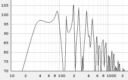

Is this a better choice then?
http://www.ground-zero-audio.com/components/com_jshopping/files/demo_products/GZTW_30TX.pdf
It has Qts 0.53 instead of the 1.05 of the Pioneer. 30 sec in HR got me pretty much the same response as the Pioneer.

That's a pretty deep null above 100 Hz. I probably wouldn't opt to build this.

Well, unless you already have a good understanding of basic band-pass speaker design, then short of a lengthy tutorial I don't have time for, about the best I can think of is that one normally only design cabs to amplify a point source [cone/dome] driver's rising response portion of its BW = 2*Fs/Qts or ~81.9 Hz, i.e. not even one octave, so this ‘one note’ high Q alignment is theoretically only suited for peak SPL competitions and even then would be larger than typical since Qts dominates speaker cab design.
That said, one can obviously make grossly misaligned speakers and now with the advent of relatively inexpensive digital EQ one can [re]shape its response and some folks have done so with mixed results, so yours may/mayn’t perform as predicted and/or cause premature driver failure due to non-linear loading, especially when it’s a TH, and worse, when the driver is compression loaded like yours is [S2 is smaller than driver Sd].
As I noted though, one can properly horn load high Qt drivers if made large enough to offset its very weak motor, but why not spend all that extra $$$ in materials and maybe electronics towards a driver much more/best suited to the needs of the app? The only reason I can think of is if you live somewhere that has a very limited driver choice once shipping, etc., is factored in.

It's a lot better, though still pretty far off the ideal, though of more importance is that any of these inexpensive driver's actual specs tend to be somewhat worse in reality, with Qts normally being somewhat, to grossly, higher since most of its manufacturing cost is in its motor assembly.
Best then to buy one of the drivers or at least brands such as the JBL GTO series or similar with proven results if it's an option.

Seems like it would be an advantage to getting a super steep acoustic XO since he's only interested in a ~100 Hz top end.

I'm looking at maybe getting the JBL GT4-12 instead then, since I can get two of them pretty cheaply(meaning two horns instead of one).
Specs are here http://www.team-bhp.com/forum/attac...read-before-posting-new-q-gt412_f1_page_1.jpg
They sim pretty nicely although I would the high corner higher, maybe 150 hz- this was a 30 sec sim though, I'll try to optimize it, if you guys agree with this choice of driver?

Again, its HF response limit is defined by 2*Fs/Qts or ~107.5 Hz and shows up as a huge dip in your response that you can't get rid of.
Note too that typical TL/TH alignments are basically just ~two octaves due to its intrinsic 3rd harmonic dip, so tuning will need to be around 30.5 Hz, making the driver's Fs around 37.5 Hz and to keep it from being so under-damped, a <0.4 Qts is desired.
Attached is a GT12-4 2:1 CR [max recommended] TH text file to import with Fs, Qts changed to give you a 'frame of reference':
