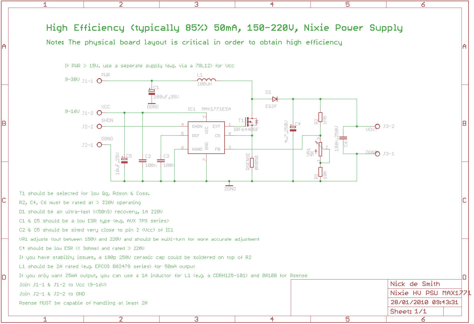

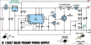

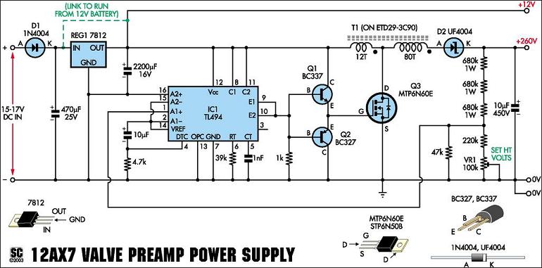

UC3843 is perfect for that, a flyback switcher is just what you want for low power. It will run quite nicely from 12V, and provide plenty of power for something like that. The Vadj pot will provide a factor of 2 adjustment, which was probably something like 150-300V in that schematic.
Only change I can think of, besides removing the heater winding if you don't need it (however, I would still suggest a 6.3VDC regulator, or a 12VDC LDO, for the heaters since automotive power is NOT generally within 10% of 12V), is potentially adding a 4.7k to 47k resistor in series with the leftmost 0.01uF capacitor (this is the feedback compensation capacitor). The purpose is simply to stabilize the supply against transients and preventing oscillation. Stability is easy to test if you have a digital oscilloscope, or a quick eye on a triggered analog scope -- just adjust it until, by repeatedly switching power to the circuit, the output voltage stabilizes the fastest with minimal overshoot.

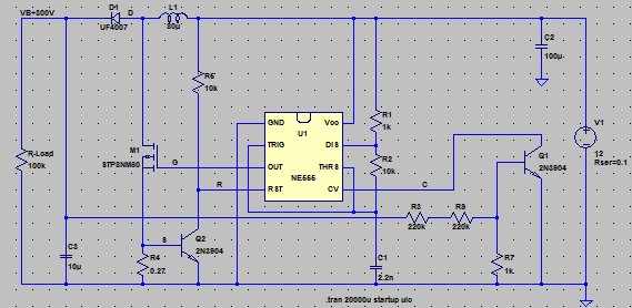

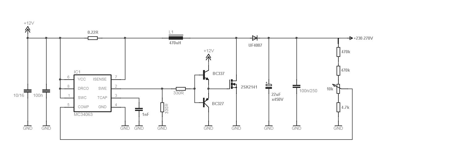

Actually, you don't need the transformer, cause mains isolation is not an issue here.
A simple Boost Converter will do.
I did build one with a 555 timer and it does well (regulation is not perfect but simple, there is some 10% drift with temperature).
I also built one with a 3843, which delivers anything from 1mA to 150mA.
Other proposals from the net.
Add pot to adjust voltage. Adjust caps to select switching frequency (50kHz or so).
Inductors are small, don't use power transformer.
Here's a collection of circuits ...

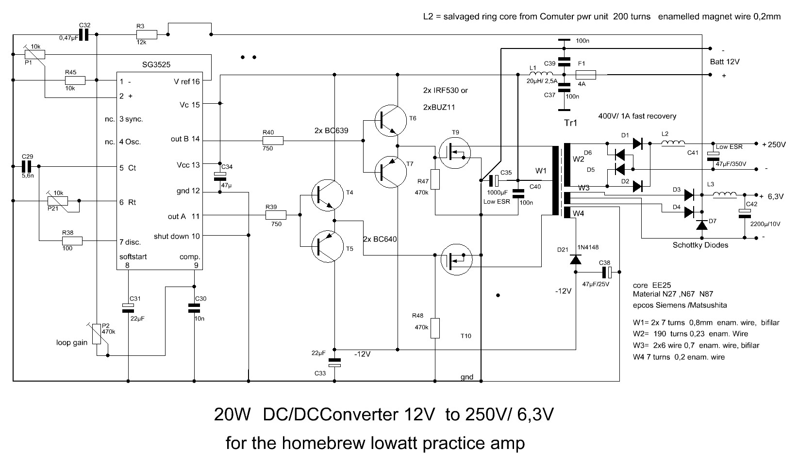

Hi yourownfree,
here is a converter that I made for a battery operated guitar practice amp the other day. It run most every amp with 6V6 or EL84 , even an old valve radio will work with it.
The output regulation refer to the 6V heater voltage. I made two off this converters . They work with a good efficiency. A full charged 12V lead battery with 7,5 Ah keep the amp for 3,5 hr running.
regards
Wolfgang
DF6ZC
Here are the circuit diagram:
