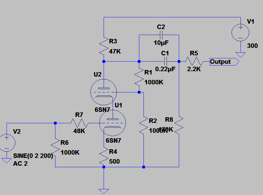

To be more direct, I wasn;t impressed with the result of UL cascode (50% feedback) in 6sn7. And I want to learn more in the case of 12at7/12ax7 etc.
The following ltspice circuit runs 47K plate load on a 6sn7 UL cascode, biased around 4.1mA plate current for both tubes. 2V pp 200Hz input yields around 42V pp 200Hz output. The Mu is 21, which is similar to what an one stage 6sn7 grounded cathode can give you.

No doubt. You have a feedback loop nested within another- sort of a recipe for instability.
Except for the distorting driver, it will, as Atmasphere says, surely be instable. If going the cascode route why not go for high Gm-tubes?
The UL connection itself is not so bad even if it doesn´t do so extremely much for linearity but it helps.
Unfortunately you´ve got all wrong as you can´t have the capacitor from the upper grid to ground! No feedback at all that way. See sulcorebutia´s circuit above, it is correct.

thank you all for your thoughts however some of them i don't understand
(1) Distortion in the Driver stage. I don't understand what type of distortion you are referring to since the standard THD and IMD measure exceptionally well.
(2) I amuse you are referring to the Driver stage tube and the cap bypassing the lower half of the Voltage divider? is this cap not installed on almost every other cascode circuit not using the grid leak method? is it not present so as to provide the required low AC impedance to ground?
(3) yes there are alto of feedback loops however having the feedback distributed locally around each stage not only linearized it but also requires less overall loop feedback for the same Distortion performance.
(4) yes I'm thinking the neon Lamps may have to go as they have had previous fail to ignite issues and you can just imagine what that did to output tube current.
(5) the stability issues in this amp are limited to the 8 ohm tap when they appear. the Loudspeaker connected presents a complex load as it is 24 dB per octave filters crossed over at 2.5K.

You had some thoughts, hope this will help:
1 The cascode, with the mediocre 12AU7, of yours will have in the ballpark of over 0,5% THD at clipping point for the 6L6. This without any NFB from your SE-amp. A more suitable E88CC UL-cascode will lower THD to maybe 1/10. Another thing the one-triode stage will have a Zout of maybe 4k while the cascode will have the same Zout as Rl=91k.
Take a singletriode GC-stage with 1/2 E88CC and THD will be less than 1/3 of the above at the same gain. Using a CCS on top will lower THD even more to maybe between 1/4-1/5 the cascode. So is it worth the effort using the elaborate cascode as also the overtone structure of the it is worse?
2 What you have is an almost conventional cascode. Remove the cap and you have an UL as 50% of the signal is fed back to the upper grid. Check Broskie, think he has something about it. A patent is held by Bill F. at Conrad-Johnson.

Hey Merlinb,
What should be the problem😉?
Check ppl´s circuit again. First of all, cascode gain is Rl*Gm giving us not more than 36dB gain due to the lousy Gm of the 12AU7(at this low Ua and Ia Gm is really low).
Then there is local current feedback through the unbypassed cathode resistor, -7dB. Then feedback by UL, -5dB. This leaves us with only 24dB=16x gain left. Even though feedback is 12dB THD is still quite high.
This is even less than an E88CC GC, with unbypassed cathode and a 22k anoderesistor, that should have 25-26dB gain.
