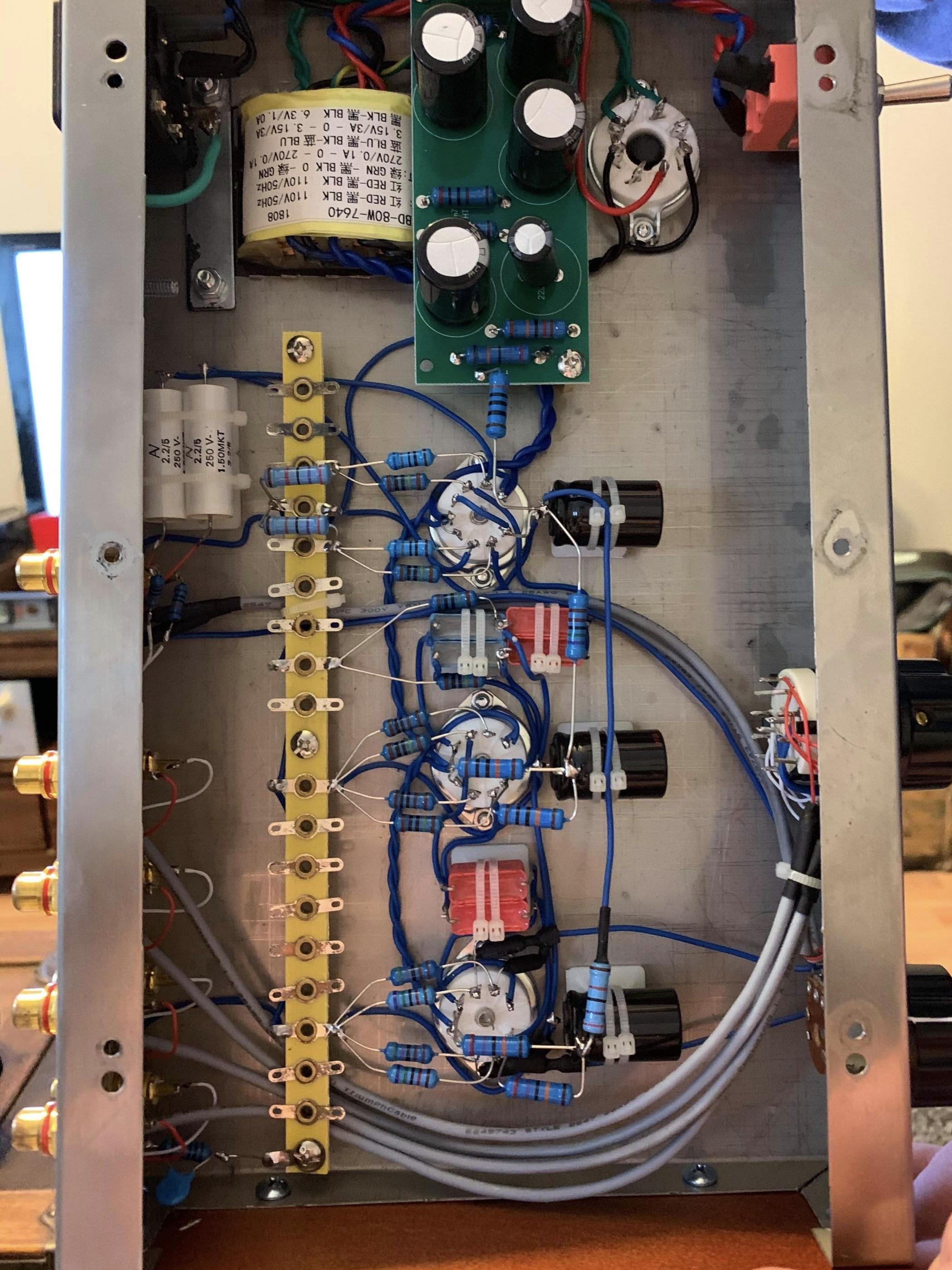

Anyone know which of these tubes is the left and the right ?
Trying to figure out because I have a pair of 12AX7 that are the same and one different. So I’d like to install the pair as left and right...
Thx

It does not matter to the tube whether you use it for the left or the right channel. Both halves of the tube are the same.

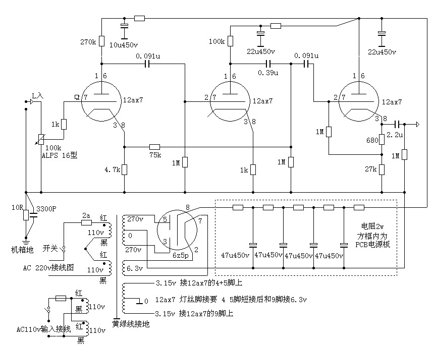

Looks like each half of the 12AX7's is used for one channel, so non of the 12AX7's is used for only one channel.
The 12AX7 at the bottom of the picture contains the first stage (one half per channel), the middle the seconds stage (one half per channel) , and the upper one (no surprise) the last stage (one half per channel).

Hmmm,i've been looking at that very preamp.Based on the Marantz 7.I saw it on Aliexpress but they say no shipping to Canada? May I ask where you got yours?I think it was listed as $110-$145 U.S. plus $57 shipping to the U.S.I built a LTspice sim of the circuit,it has low distortion,dominant 2nd harmonic,positive phase.

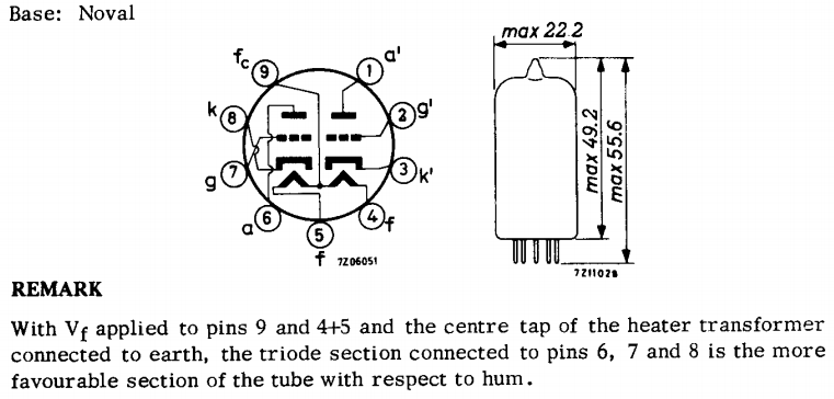

I think you have got the wrong idea PCL200 ,your question originally was -- "what is the first section " well according to Pro-Electron its the one I mentioned and as most European tube manufacturers ( Mullard is Philips ) registered with Pro-Electron they used the same technical designations.
Look at a Mullard ( small ) data book scroll down to ECC81/82/83 and you will see what I mean -- one tick is one --two ticks is two.

If there are two identical triodes in one bulb there is no reason to designate a first one. a-g-k is one side a'-g'-k' the other ' is only to indicate witch a goes with witch g.
Philips indicate "section connected to pins 6,7 and 8" not first or second section.
