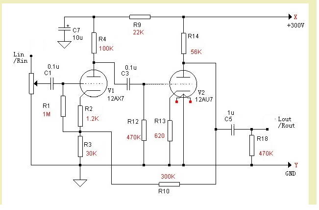

I gave a reference circuit which use 12AX7 follows by a 12AU7.
What if two 12AX7 or 12AT7 or 12AU7 were used instead - would it make the sound better or louder, more/less bass, high pitch etc...

In the circuit cl1238 has given in post 1 there is negative feedback and gain in both stages. So any tube that you plug in , the circuit will still have the same overall gain. But the operating points will vary if the resistors are not changed. That should certainly alter the sound as it will not be optimum for all the replaced tubes. It's just possible that using the 12AX7 at the input will also cause more HF roll off due to it's miller capacitance. Can't just plug in different tubes in without any changes in resistor values. With ideal tubes there should be no difference but these are not ideal tubes . Feedback will cut down some differences and maybe they might sound quite similar after all.

If a circuit is properly designed for 12AU7 then swapping to 12AT7 or 12AX7 is likely to make the sound much louder and significantly more distorted. It should not affect the bass (although the extra distortion may give the illusion of more bass). What happens to treble will depend partly on Miller capacitance and grid stopper value (if present).
