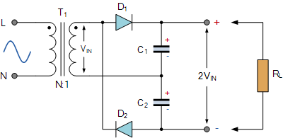

If a DC heater supply is insisted on, select a 6.3 VAC filament trafo rated for 4X the total heater draw at "12" V. "Full wave" voltage double the 6.3 VAC into a huge valued cap. stack, using 2X SB520 Schottky diodes. Follow with a very well heat sinked 1.5 A. rated 7812 regulator.

You know, the combination of Schottky diodes (minimizing the VF voltage drop) reasonably modest first-stage capacitive filtering, then a resistive filtering network (which admittedly only works for a constant current draw) with a follow-on capacitor really seems to optimize things.

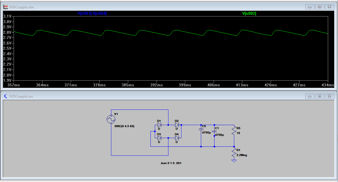

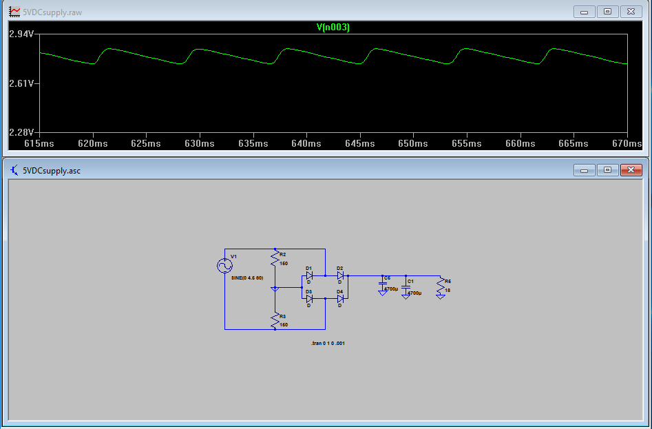

If I model a 3.15VRMS source in LTSpice it gives terrible performance for voltage, under 3VDC. I can assemble the circuit on the bench and see that it puts out over 7 without a regulator. I've attached the circuit.
Why the 100 ohm resistors?
They do nothing good and short 2 diodes.
Either AC and artificial centertap OR DC and the bridge has one end grounded.
But not both.
