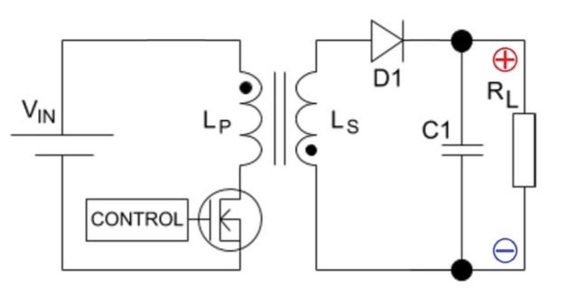

Your schematic says 200 V. The math gets even worse with 400 V. D = 1-(Vin/Vout), so D = 1-(12/400) = 0.97 or 97 %.My plan is to achieve a stable 400ish DC voltage to power 4x 12AX7 (6mA?)
With the tiny current required, I'd probably look at a flyback converter or a charge pump. A diode-based voltage multiplier could maybe be made to work too.

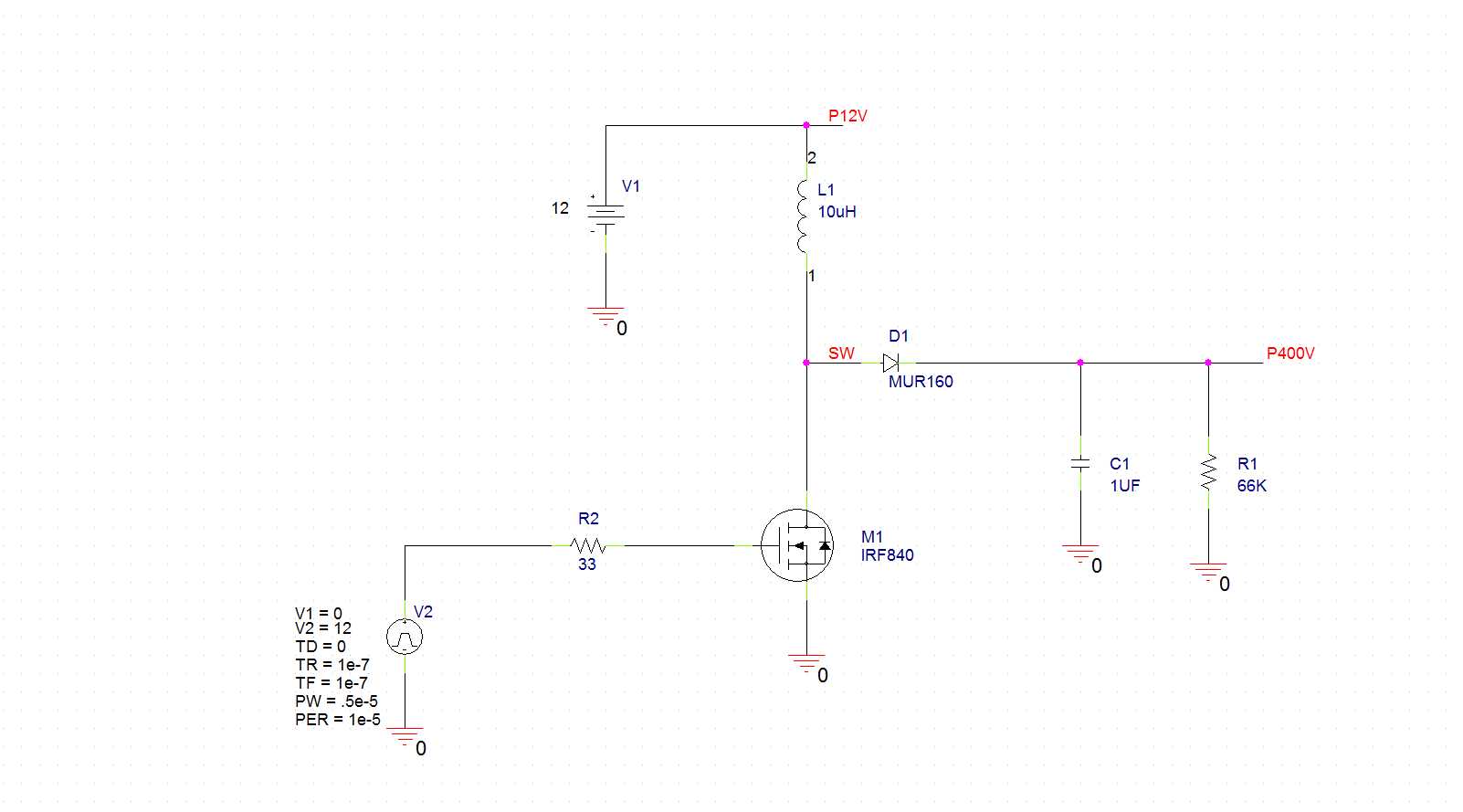

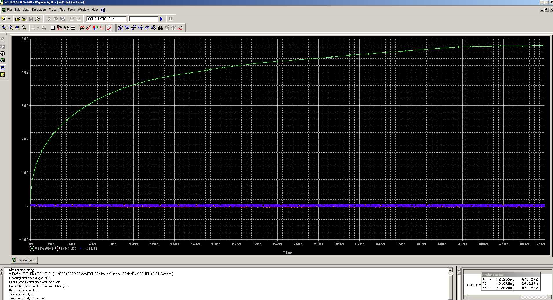

Here is a spice sim showing from 12v input for about 475 volts out with a 50% duty cycle and a 66k load @400V (about 6mA).How do you suggest getting from 12 V to the 200 V indicated on the schematic with a maximum duty cycle of 50 %?
With a real regulator it limits the output voltage to 400 voltage at a bit less than a 50% duty cycle.
I picked the UC3845 as it tends to be a little easier to get a stable regulator switch rate in current control systems if the duty cycle is held to less that 50%.
A stable regulator switch rate is important in audio for low noise.
Yes you can also use the UC3843 but will need to be careful to select the circuit values so the inductor is always full discharged before the next switch cycle starts or sub harmonic switching may happen and that tends to be noisy in the audio band.
BTW
A better MOSFET would run a lot cooler like a IPAW60R180P7SXKSA1 from Infineon @ about $1.50 each.
The on resistance of the old IRF840 is higher than wanted in this application.
My sim shows a peak inductor current is a bit under 6A. So 3 amp inductor is not great.
Inductor IHLP5050CEER100M01 from Vishay is 10uH at 7 amps with 14 amps saturation current. Cost is under $2. Many others will work.

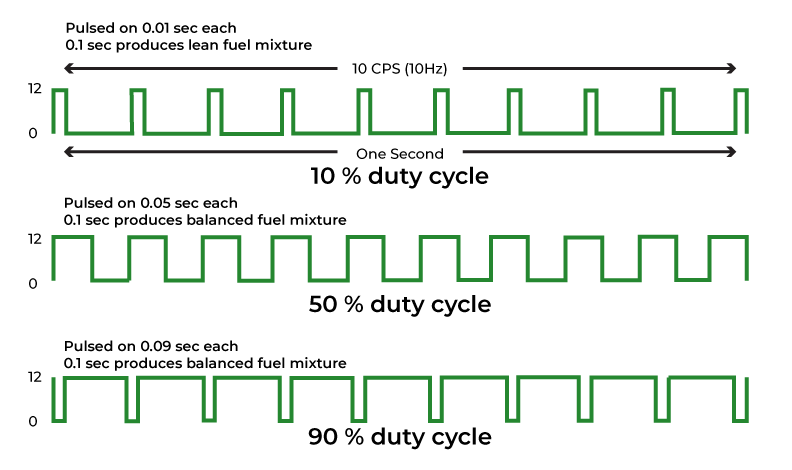

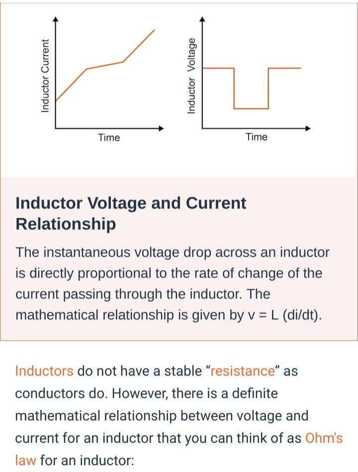

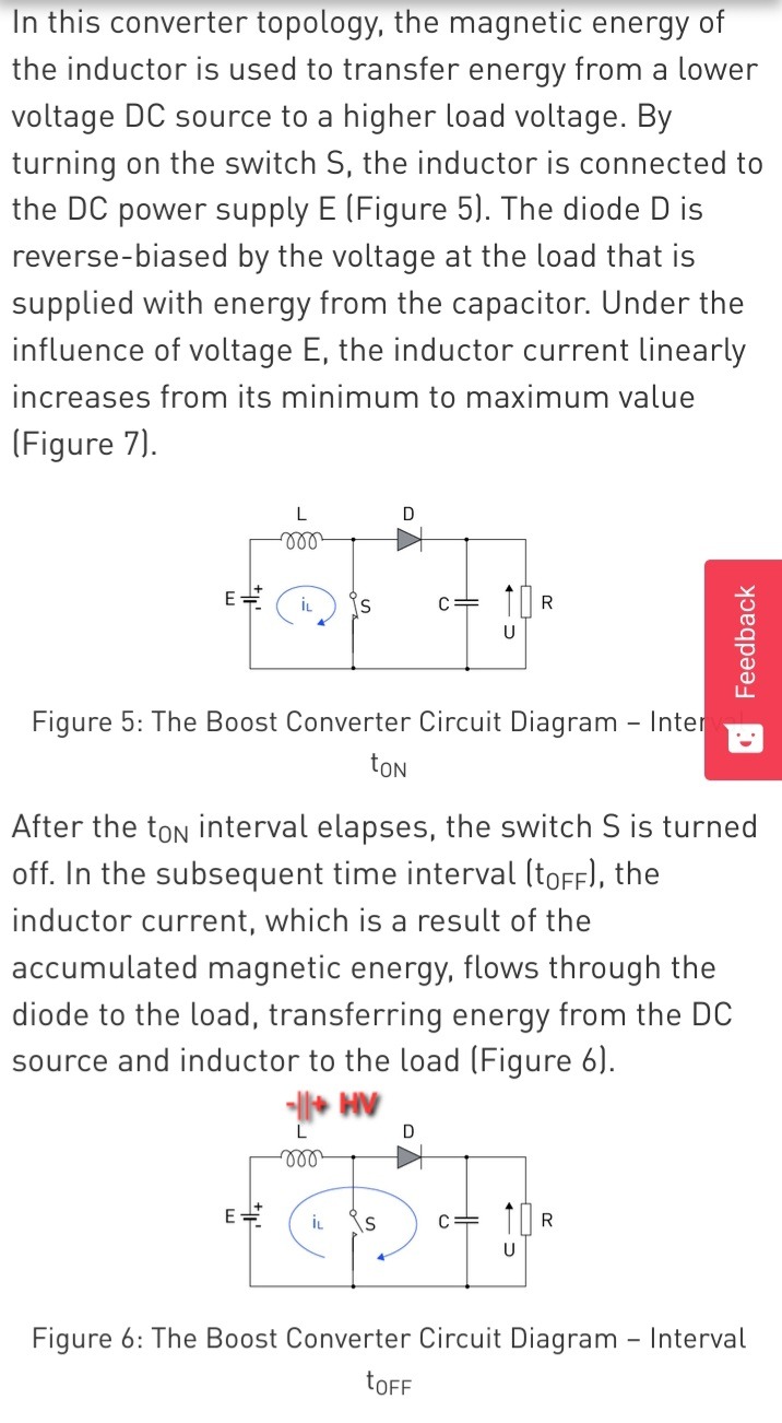

I include some visual to understand clearly.
Increase the duty cycle increases ON state and so the heating produced.
What about aim a very low duty cycle? Inefficiency I guess, since the output cap needs more time to charge.
Keep a reasonably high duty cycle is important to have a more constant DC output voltage value.
50% remind me half wave rectifier. So a good compromise I guess between stable output, Vinput drop voltage D margin (battery reaches 0%), inductor working and thermal dissipation.

About the time of charge/discharge (duty cycle)
So we are aiming to:
- short pulse mosfet ON: high current (12V Vin), inductor charge
- mosfet OFF: high voltage during the discharge of the inductor trought the diode. Energy stored in Output cap.

Thanks for scheme. The values at V2 (pulse generator) are what I sould have to produce with UC38xx?Here is a spice sim showing from 12v input for about 475 volts out with a 50% duty cycle and a 66k load @400V (about 6mA).

I can't speak for @Bluesystems but by "real" flyback controller, I'm think he means using an actual SMPS controller IC instead of a 555 timer IC.With "real flyback" you mean that UC38xx series? So a chip that is INTENDED (not like 555) to perform what I force to 555 to do with BJT tranny? Thats the flyback right?
I bristle a bit at the "flyback", though. The UC38xx series can be used for many SMPS converter types, including flyback converters. It'd be every bit as useful in a forward converter, boost, buck, etc.
Nothing prevents you from making your own ramp generator and using it with a comparator to form a pulse width modulator. You can use the 555 as a ramp generator by configuring it as an astable multivibrator. The voltage across the cap that sets the frequency will approximate a ramp. In reality it's two exponentials, but it's close enough to a ramp. Then use a comparator like the LM311 to turn the ramp into a PWM signal.
If you look at the internals of the UC38xx series that's about how they work. They also add current mode control, which is handy. And duty cycle limit for some of them. And the reference voltage that you'll need for the PWM. You get a lot of puzzle pieces in one IC with consistent performance, which is the main selling point.

Thanks for theroy material guys. Now I just fast checked the boost topology.
Switch ON: the surge current charge the coil (max A measured to size the coil A, uH sized appropriately to let it charge and discharge in a duty cylce without saturation)
The instant voltage drop acros the coil is proportional to the current change. Our current pass from MAX to 0. So the change must be rapid to achieve high voltage.
I know that a coil opposes at current changes. If I supply constant 1A at 12V, the coil act a conductor with a sort of resistance (very low) after the initial current surge (where it act as insulator).
The coil works with mutual inductance
Switch OFF: the coil now has stored a magnetic field opposite in verse to the current verse.
What I cant get is where this magnetic field discharge.
In this image I resambled the inductor as a capacitor/battery ONLY IN THE MOMENT when it start discharge. Is it a wrong approximation?

At the CONTROL pin of the mosfet switcher I could connect a 555 or a proper IC like UC38xx. That is what you mean, @Bluesystems?
[IS THE FLYBACK SCHEMATIC HERE AN ISOLATED VERSION OF MY SMPS SCHEME? AT MY EYES SEEMS SO]
