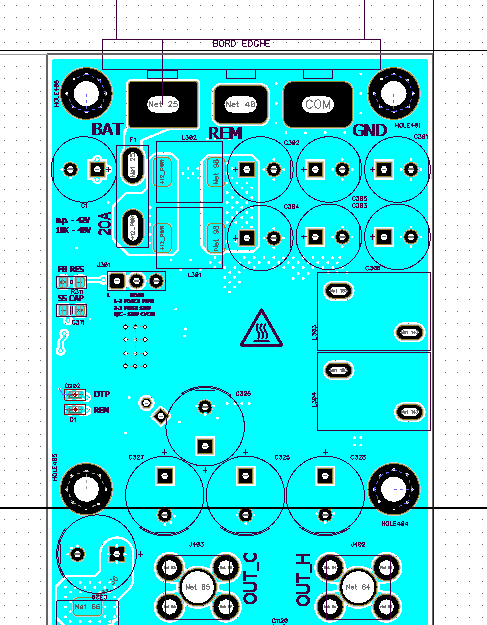

Is there anyone who can help me to design a pcb of boost converter from 12v to 48-50v for tpa3255 class d amplifier chip.

No because it will draw 80+ Amps from the 12V supply. That's starter motor current requiring welder cables, not a PCB.

Look for a proper cheap second hand car amplifier with separate PSU and AMP boards and take just the PSU board.

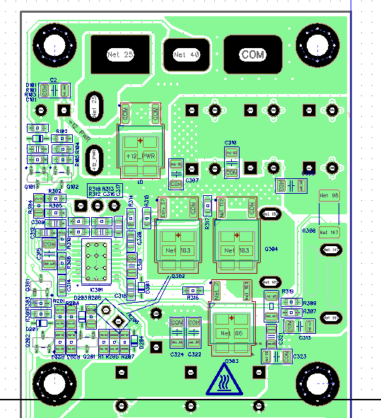

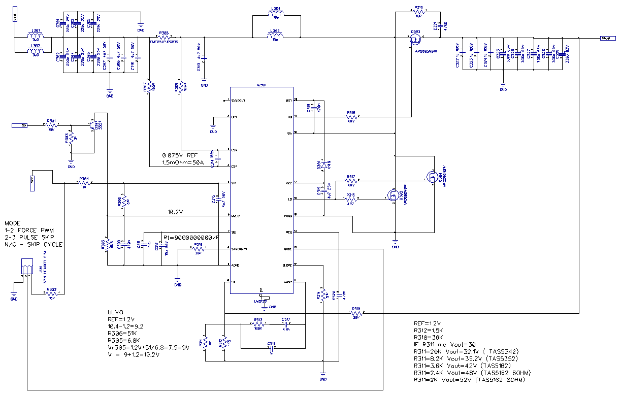

By the way, in order not to "reinvent the wheel", it is better to look at the demoboard from TI, there is a schematic of a car amplifier with a boost converter and tpa3255, including a drawing of the board.

I would still use a SG3525A, TL494A and just have it run x4 fets. and get the same outcome. The price for that chip and the part count is just unnecessary. What is the gain using a boost stage at this power level ? 300W.

You need a straight 12V to 48-50V DC to DC converter, period.
Emphasis on the word "boost" which does not apply here.

Overall - the idea of separating the boards into power supply and amplifier in car audio is a very bad idea.
You will need to add a remote control circuit, and all sorts of protection, click suppressors. Apparently, you didn't think about it at all, and your project still needs a lot of improvements.
- Class D
- 12v to 50v buck boost converter 700-800 watts
