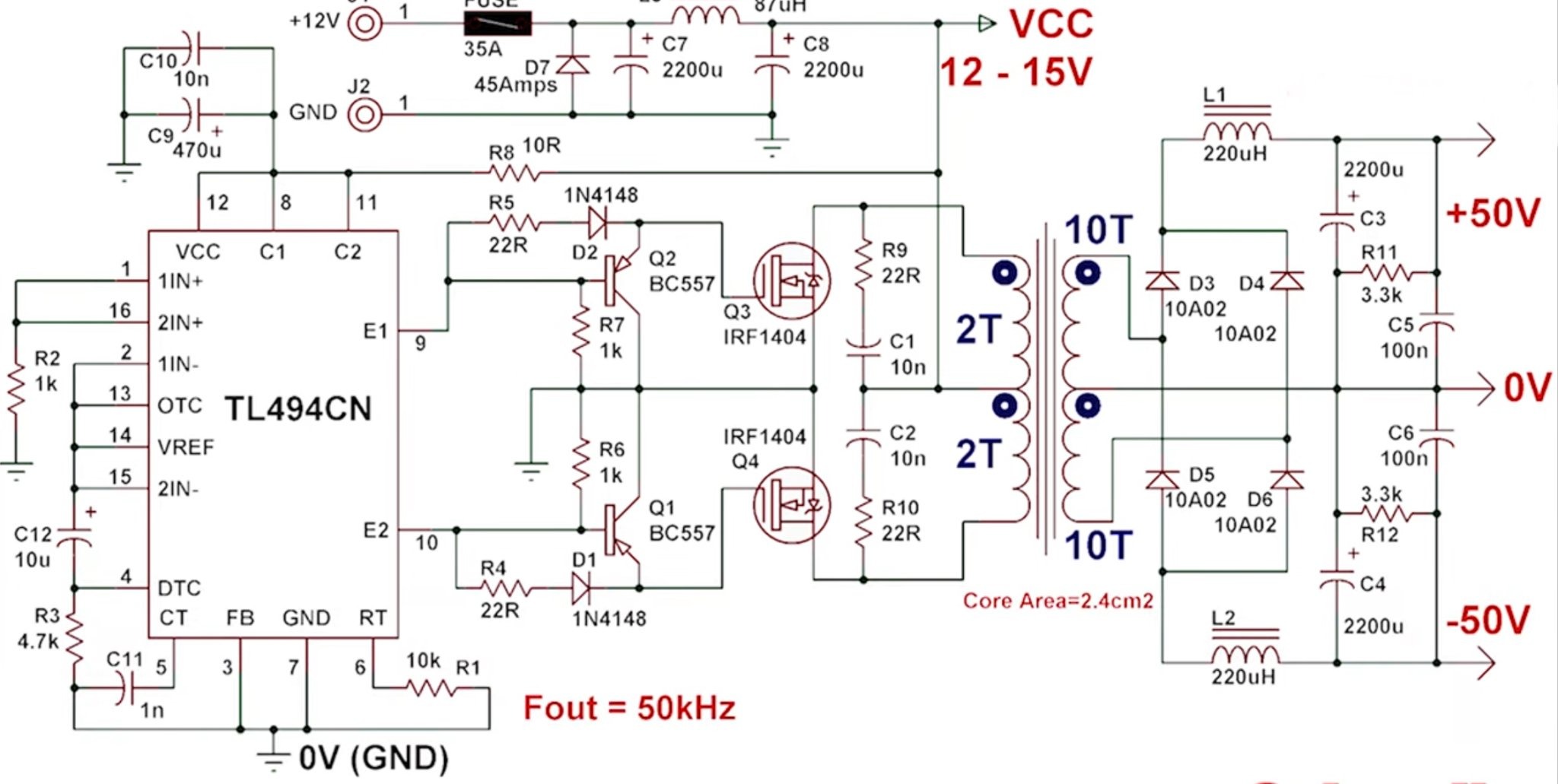

Hello, ive got a nice little amp that needs a ~500w dual rail supply ( has a -60v output, a 0v “virtual ground” output, and a +60v output)
Does anyone know of a relatively simple circuit to take my 12v and split it to a 60v, 0v, 60v output? preferably with soft startup and control feedback? have a milling machine, so can etch pcbs pretty well.
I have seen a few designs that use the tl494 that look good, however im not very confident with transformers so it really handy if you recommend a transformer with said schematic (or, i dont mind winding one)

The easiest 12V setup for someone without much experience would be a 12V 1kVA sinewave inverter powering a transformer with 60V secondaries...

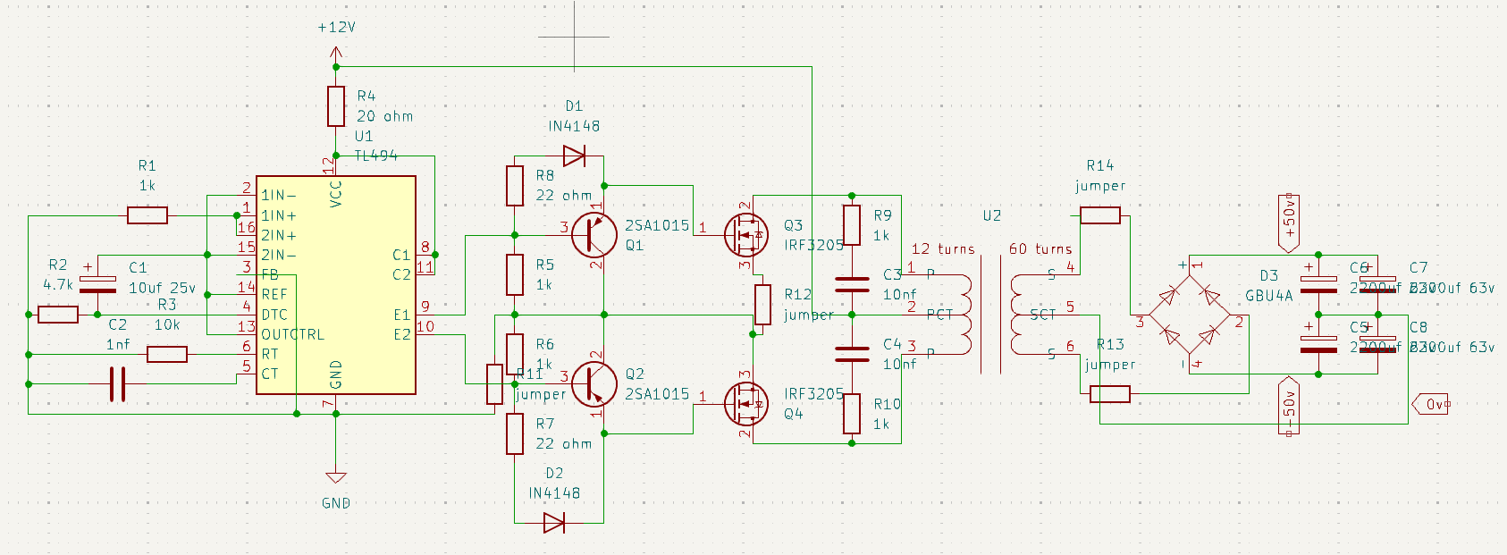

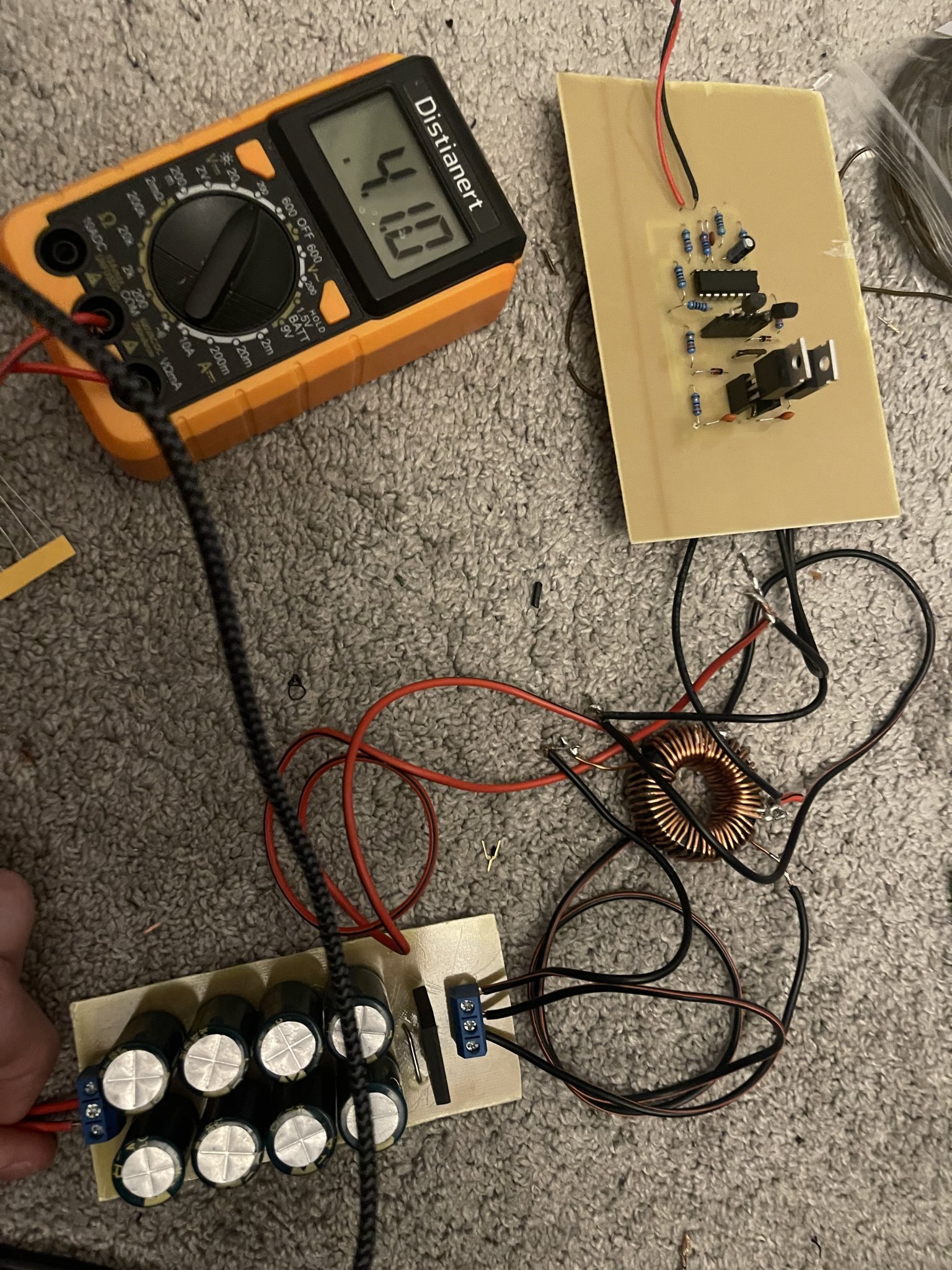

I have managed to make the 12v to 60-0-60, converter, milled it out and have some pretty good results:
The reason it was not working before was simply bad breadboard connections, the circuit works well now milled out of fr4 pcb board, however my tranformer is not wound very well so im only hitting +/-41v at the moment. Happy to drop the gerber files if anyone is interested
Exact circuit diagram that i am using:

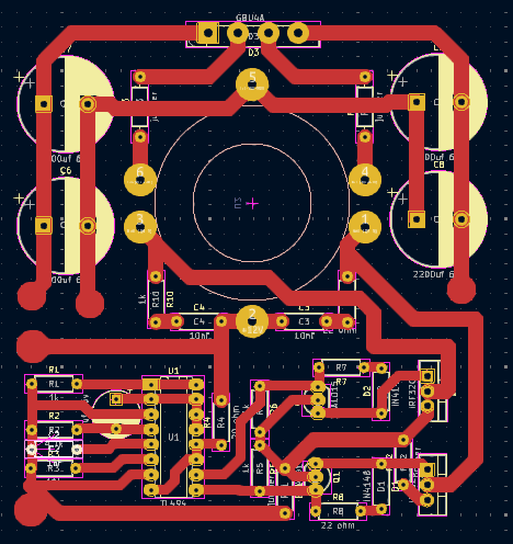

here is the board and schematic file:
Also, if your planning on making it i don't really recommend it as it still has issues:
  • no feedback (i would love if someone could let me know how to implement this)
  • because there is no feedback and because the transformer is hand wound, you can get strange output voltages with one side lower, e.g 45v-0v-55v
  • for some reason, is drawing 5 amps at 8v with no load on secondary of transformer (this doesn't seem right, if any can see an issue causing this :))
  • pcb traces that lead to mosfets source or drain need soldering otherwise they will burn out.
