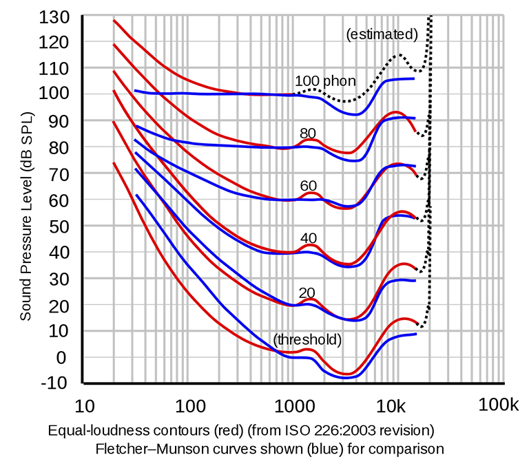

Just going over some studies and pages related to hearing, and loss with age.
The average middle age and up individual cannot hear past 14khz.
Further, the sensitivity above 2khz begins to drop off with a slope of around 18db/oct and once you reach your 60's, a frequency of 4khz would need to be almost 20db louder compared to 250hz to sound the same as when you heard that tune in your twenties.
Holy crap.
And if you smoke or have high blood sugar it's worse... a smoker with the diabeetus who is exposed to over 85db on a regular basis would likely really love an uncompensated dipole.
"Due to the impact of continued exposure to loud noise over time, usually the younger we are, the better we hear. The ‘normal’ hearing frequency range of a healthy young person is about 20 to 20,000Hz. Though a ‘normal’ audible range for loudness is from 0 to 180dB, anything over 85dB is considered damaging, so we should try not to go there.
As we age, it’s the upper frequencies we lose first. So by the time we hit middle-age, we can expect to hear up to around 14,000Hz. Age related hearing loss (or presbycusis) naturally develops as we age and our hearing can begin to deteriorate as a result of external factors, including the environment and existing medical conditions."
"Sounds with frequencies above the realms of human ears are called ultrasound and those below are called infrasound. Though we’re capable of distinguishing between 1400-odd pitches, most of the important speech-related sounds fall within a narrow, relatively low spectrum.
The highest note of human speech is a soprano singer’s C7 (around 2048Hz) and the lowest note is the C2 of a bass singer (around 64Hz). Though we can’t scream much above 3000Hz, US singer Tim Storms has sung a note at 0.189Hz. Ironically, no human will ever hear it, although it is possible to feel it."
The above comes from The Normal Hearing Range | Hearing Health Blog | Amplifon
I would like to know what everyone thinks the implications of this are with regard to our beloved hobby, measurements and subjective impressions of different speakers?

My personal experience (left 10 kHz, right 7 kHz) is that I hear sounds above those frequencies, but they are aliases. By boosting sounds above the natural range, so they can be heard, what is heard is rather uncomfortable and annoying. I would support deliberate roll off of frequencies outside of what I call the natural range, rather than boosting them.
So you find compensating for the loss sounds unnatural? Interesting.
I'm 54 and I would have to agree. Too much treble or even a bright recording annoys me also.
On the face of it, you would think compensating might help. But my guess is it seems to be the opposite, as we've adjusted to our hearing in everyday life and it doesn't seem normal if compensated in a loudspeaker.

It seems that in the 2khz to 4khz range, the age related decline is actually flattening the most sensitive range of our hearing and bringing it more in line with frequencies below that.
Above that it's making the cut off even steeper.
When considering certain individuals subjective preference for particular speakers, it certainly needs to be taken into account. A small mid that gets in your face a bit when transitioning to half space radiation in the most sensitive area of hearing may become more tolerable, or even preferred.
Or less tolerable because it seems more unnatural as the individual has adapted to the loss of sensitivity...I definitely have some experimenting and reflecting to do on this.
I appreciate the different takes everyone has on this. I've definitely started to lean toward small full ranges in my designs. A good 2" to 4" fullrange that gets out to 12khz or higher is...well...actually a true fullrange for me lol
