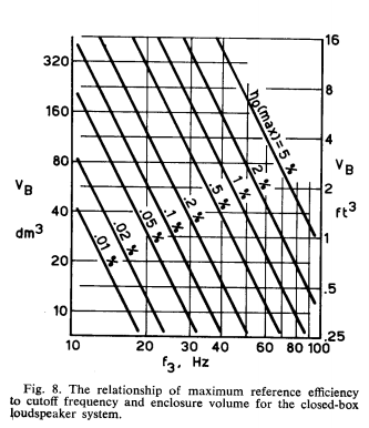

Hmm, per the attached, ~20 Hz/70 L = ~0.01%/100 = ~0.0001
112 + 10 log[~0.0001] = ~72 dB, so ~40 Hz/0.1% = ~82 dB
