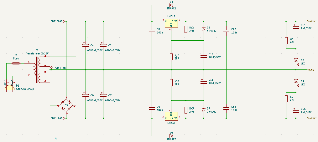

You can download KiCAD, find chip specifications on web and create your own design like I'm doing. (I know - I could have such psu already from ALiEx... few times, but satisfaction I cannot buy). Here is what I designed so far (it may have errors, so just showing up where I went from zero):

- next option is build something on LM317/LM337 - quite easy to build, acceptable performance for most audio applications (example: https://xtronic.org/circuit/adjustable-symmetrical-power-supply-using-lm317-lm337/ )

Assembled LM317/LM337 adjustable power supply modules are readily available.
Here's one example: https://www.ebay.co.uk/itm/26467282...7779&msclkid=dbc42c9f872b117e619c4f102e0202ea
However, you need to add a power transformer with an 18V/0V/18V secondary (see circuit diagram in link and choose the input primary voltage to suit your location).
