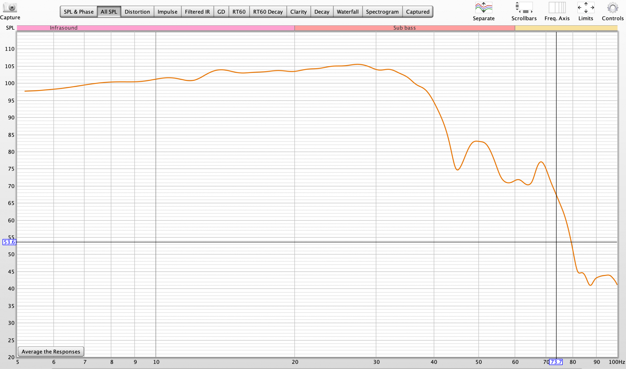

Just found some older simulation I made in REW. A good simulation may give you better information than some subjective experience.
If you go for a closed 150 liter enclosure and loosely fill it with some damping, you should calculate with about 10% more, like 165 liter.
If, for example, you use a Dayton UM18-22 chassis, you need some serious power. In most cases this will be a medium size PA amp, as these are more reliable and cheaper than some low volume build exotic HT stuff only made to deliver such power short time.
This means around 1000 Wrms / 4 Ohms. 2X 500Wrms /2 Ohm will do as well, if you use separate voice coils. Multiply by 4 if you like.
Modern D-amps with switching power supplies have made such power manageable. A transformer driven A/B or H class amp would be quite heavy around 20kg and even at idle heat up your room.
The same power, build in modern components, does not even put half that on the scale and use much less power.
If you really go for 4 subs, I recommend to use 2 stereo amps instead of a 4-channel. If one fails, you only just change over some wires and continue with 6dB less maximum SPL.
This may seem a lot of power on first sight, but for linear response, down to 20Hz, you need a lot of excursion. The more than a pound heavy membrane has to overcome the resistance of the suspension and compress/ expand the air volume in the cabinet. Moving it more than 20mm in one direction needs power. The UM18-22 can do even some more, that what program power is made for. Always go for an amp on the high side of RMS power. Better for the speaker and the amp!
If you were in Europe, I would recommend some local specialties, like Thomann, maybe even Behringer or Crown, but in the land of Sony and Yamaha, you may have other options.
So what do you get? 4X 18” Dayton, 4x 1000 Wrms will give you constant 120dB at 20 Hz in 1 meter distance, even more for peaks. Because of pressure camber effects, I can not predict the real level for your guests, but such SPL should instantly make anyone head for the emergency exit, as long as they are still able to walk
You will have to fix, damp and remove a lot of rattling from the room, I promise.
An interesting alternative, if you get tired of raw power, would be two subs on the front and two at the rear wall, out of phase and delayed. So the sound generated at the front will be absorbed from the rear speakers, making the room resonant free.
We save that for later...

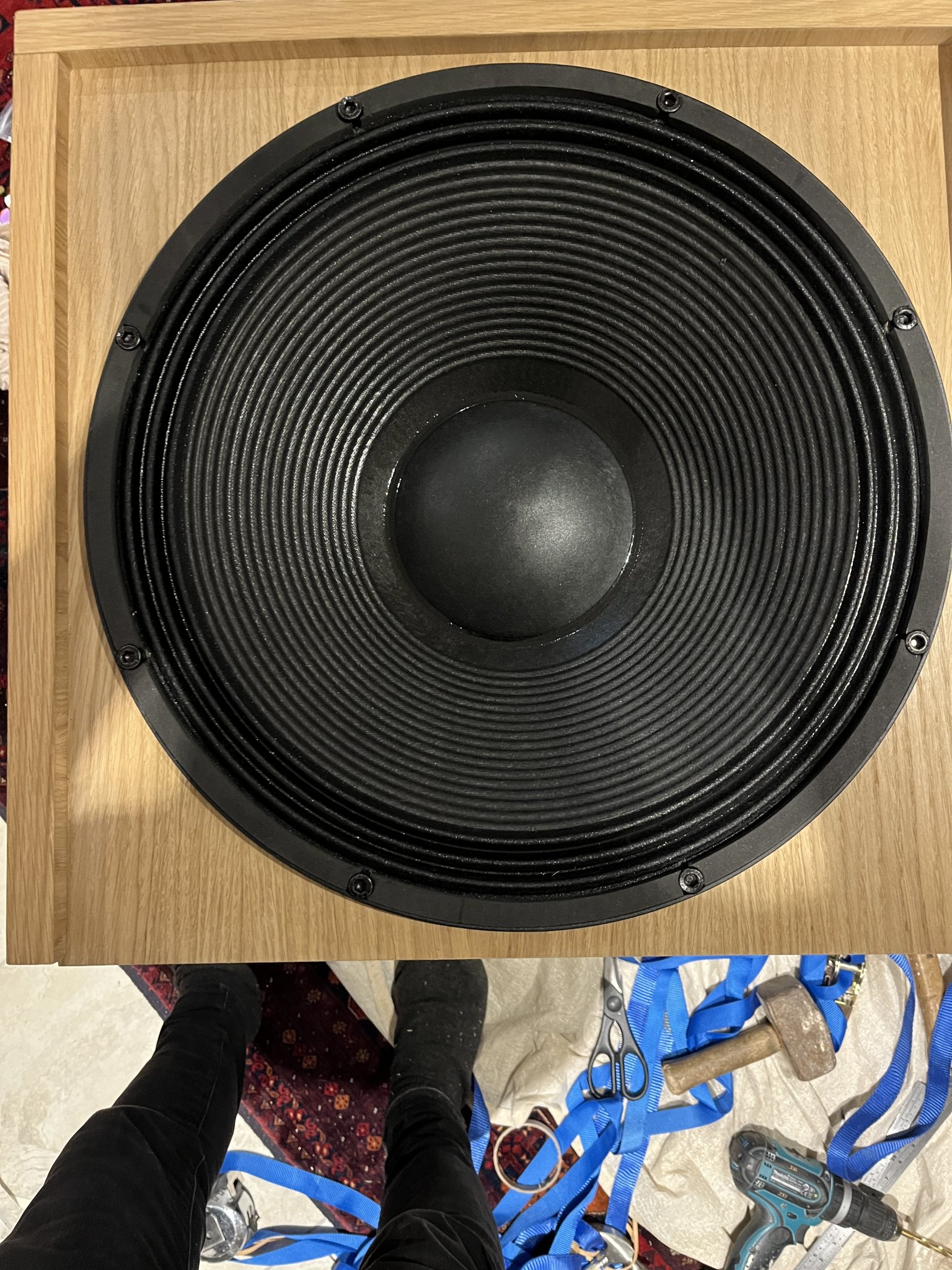

BMS 18N862 in a rigid sealed enclosure, I am building a second, 4 would be insane, I get down very low with one, I can follow the Harman curve down to 5Hz with one off these. I am adding a second for a little more cone area and help with the sub 20Hz workload. I will use these to 40Hz. This enclosure is 140L internal
The above mentioned BMS 18N862 is one of the best 18" you will find for Sub duty, and the price is not totally outrageous 500$ each or so depending on where.
Low distortion, low and linear inductance, well behaved response, klippel measurements are good, 19mm xmax, but takes some power to drive it. Also pretty much loved everywhere you can read about it. Cone is fairly light weight and inductance low so it plays cleanly higher then most 18", especially those commonly used for subs. Hard to go wrong with this driver, works well as sealed and ported.

I added volume and db until I started to show compression. Then backed off until no compression I'm 104db at 10Hz and 100db at 5Hz, 20Hz I am 107db. I am rolling off at 41 Hz at 48db/Octave
Looking at the measured distortions I was nearer 10% at 10 Hz as you get near 100 db. This was at the MLP so 3.5m away from the sub. The amp I a gutsy 500W into 4 Ohm and this is a 4 Ohm driver.

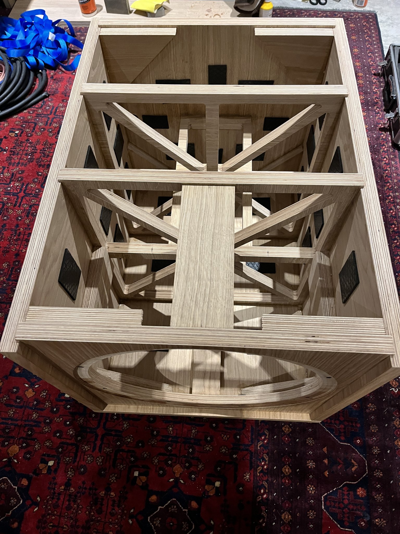

After everyone telling me I was over engineering the cabinet, Since I have had many conversations where those with more knowledge than me like Faital Pro designers. Who have said, great you built a low frequency enclosure properly, most just use a weak, lightly braced MDF box and dont get the performance .....
