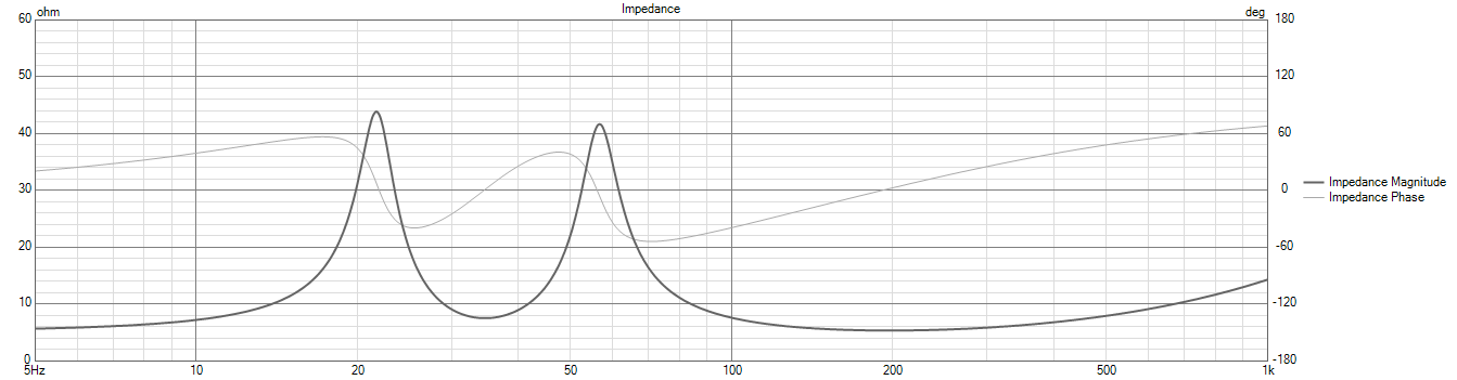

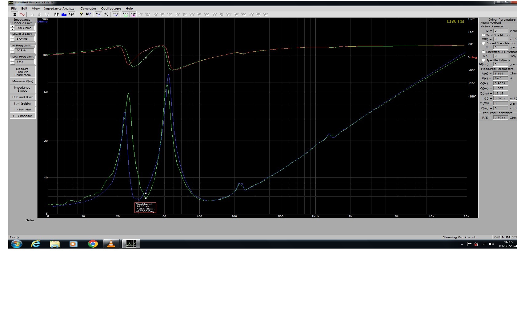

I built a pair of subwoofers, 200 litres, BR, F3 34 Hz, the sound is not "nicely rubbery" as I imagined. I measured with DATs and it gives me a peak at 20 Hz and a peak at 50 Hz, the FS of the 18sw100 is 35 Hz... I don't understand

If you shorten the ports to move Fb (box tuning frequency) from ~28Hz to the drivers 35Hz Fs, output will increase considerably (though the F3 frequency will also rise) and the impedance peaks either side of Fb will be more matched.

By "nicely rubbery" sound, you may be used to an "underdamped" system, an Fb above Fs, which will cause a peak in the low frequency response around Fb, and "ring" longer than your "tight" overdamped response.
the manufacturer recommends 33Hz tuning, do you think 35hz is better for EDM music?
in the simulator to get 35hz of F3 I have 38hz of FB
You trade SPL level for lower extension.
Most people won't notice a few Hz lower, but may notice a few dB less output.
Coming in at 34.3 Hz Fb is a good compromise 😉

Looks like you have a resonance just above 200 Hz. Box or driver?
dave
Most likely the port's pipe resonance(s) due to it's length and diameter.
The pipe resonances phase go in and out with the driver's response and cause narrow band dips and peaks in the combined frequency response, something like this example:

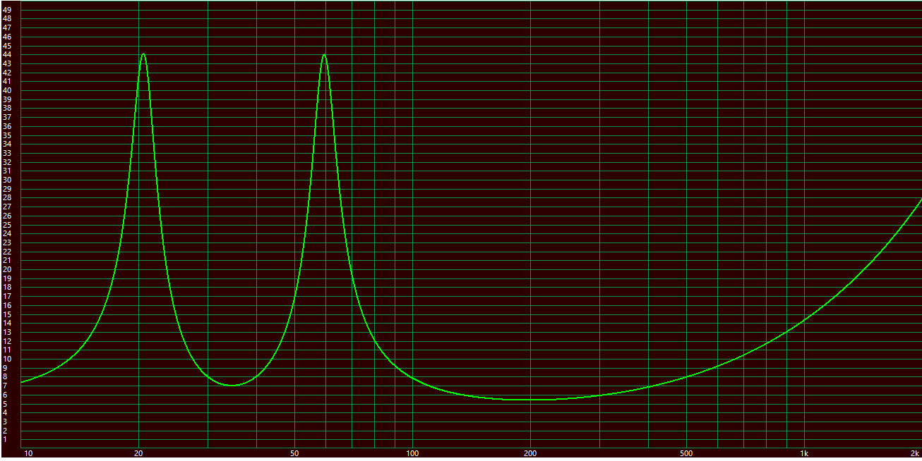

As mentioned earlier, your impedance measurements indicate that the tuning is around 30 Hz. It could even be as low as 29 Hz. That's well below the manufacturer-recommended tuning of 33 Hz. As a result, you've probably lost about 1dB of response at 35 Hz. If you tuned the vent in this enclosure to 35 Hz, you'd probably get a flatter bass response in the 45–100 Hz region. This might add back a bit more punch to the bass response.
Of course, if you're applying a low-pass filter to your subwoofer, then the lower tuning may actually give you a little bit more low-frequency extension once the subwoofer's response is blended in with the main speakers. That will depend on the type of filtering that you apply and its cut-off frequency.

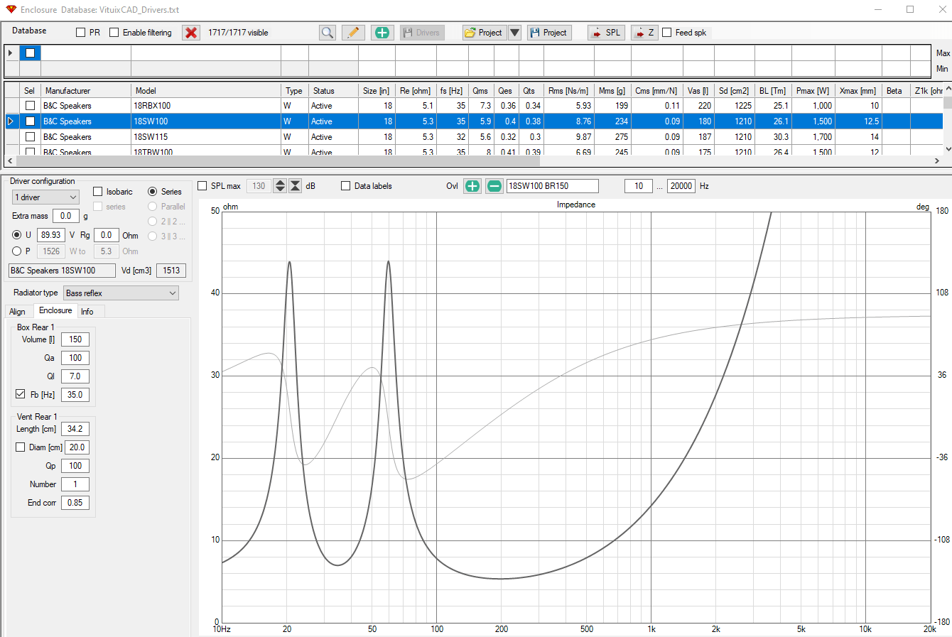

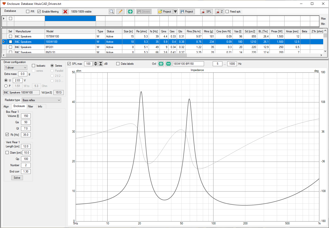

For example, using VituixCAD's enclosure simulator and the B&C Speakers 18SW100 woofer, I get the following impedance curve when the free-air resonance frequency of the driver (fs) matches the resonance frequency of the box (fb). Here the impedance minimum between the two peaks is located at 35 Hz (fb=fs). It is apparent that the two impedance peaks are not equal in height. This appears to indicate that the previous diagram is incorrect.
I checked the Thiele–Small parameters for the B&C 18SW100 in my edition of VituixCAD. They seem to be the same. It turns out that I had used an enclosure absorption loss of Qa = 50. This was enough to alter the heights of the impedance peaks so that they were no longer the same. When I changed to Qa = 100, the impedance peaks became equal in height.
