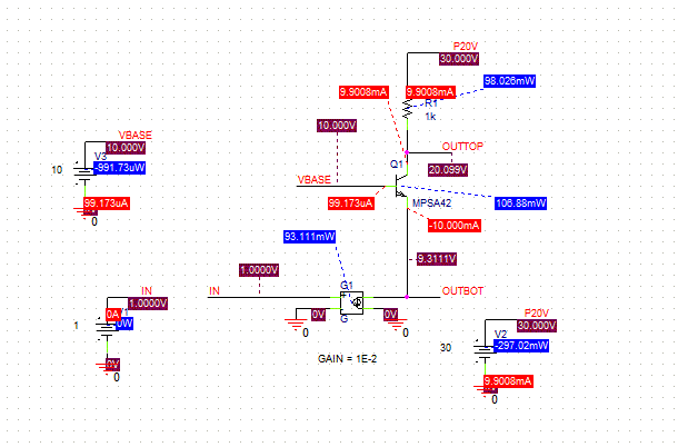

To keep the design small and simple I decided to limit the front end to a single stage.
I also wanted to use significant amounts of local feedback to reduce the total global feedback required around the output transformer to improve stability.
That meant I would need a lot of gain in that single gain stage. I figured I would need over 44dB of input gain.
A pentode stage can provide a lot of gain however the output impedance tends to be higher limiting bandwidth.
A triode with this type of u did not seem possible.
Cascode stages can provide a lot of gain. One has to be careful of the output impedance or bandwidth will be limited.
In a Cascode stage total gain is largely a function of S in mA/V of the lower device divided into the top load impedance.
This means S, load impedance, bandwidth and gain can be traded as required.
The higher the tubes S the lower the load impedance can be and so the wider bandwidth for the same gain.
As I wanted a lot of gain and wide bandwidth I looked for the highest S tube I had on hand so the load impedance could be as low as possible.
The 6Z51P pentode operating in triode mode measures a S of 18~23mA/V with Va=85V and Ia=7.15mA.
Two tubes were arranged as a LTP. With a load impedance of about 23K ohms two 6Z51P operating in triode cascode mode yielded a balanced stage gain of 53dB and produced a balanced output of 48.7 RMS, 0.4% THD @1K with no feedback.
The low 23K total impedance provides wide bandwidth.

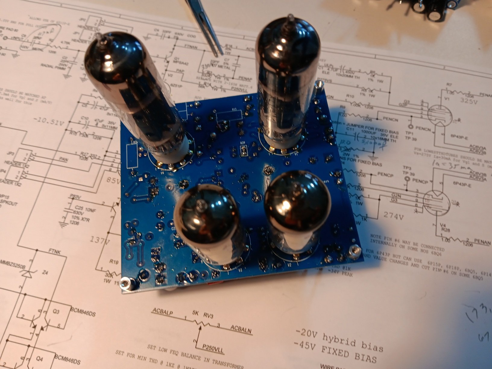

I used a pair of BJT for the top of the cascode.
This balanced input stage is coupled to a pair of 6P43P in PP using UL feedback for the screens with fixed bias.
The PP load impedance is 5K ohms and the plate supply is 330~342V.
The screens are feed from a regulated 275 volt supply and capacitor coupled to the UL taps on the transformer.
The amount of UL feedback was selected to result in 208V on the screen at the full power at lowest plate voltage point of the output swing to insure adequate plate current was available for full power output.
The bias is fixed and provided from a regulated power supply.

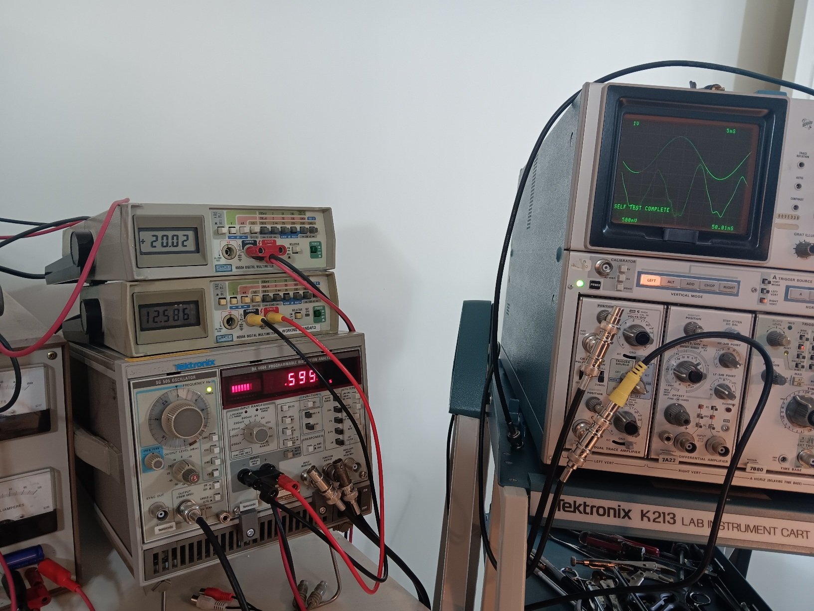

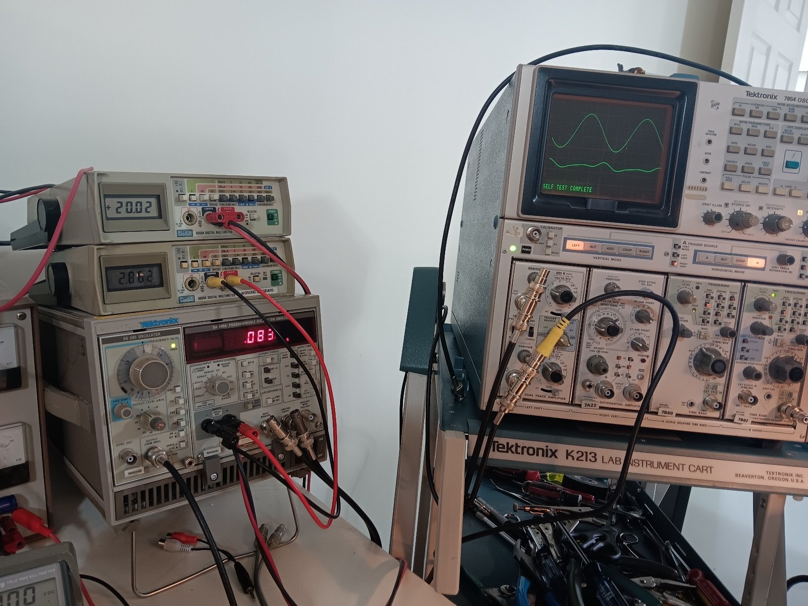

THD at 1 watt 1Khz was 0.0119%
THD at 1 watt 20Khz was 0.083%
THD at 1 watt 30hz was 0.0998%
THD at 19 watt 1Khz was 0.09%
THD at 19 watt 20Khz was 1.01%
THD at 19 watt 30hz was 0.599%

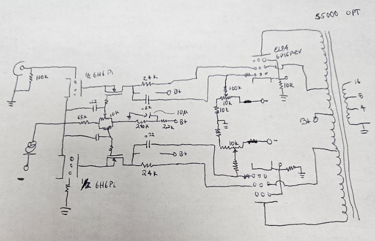

I would not mind seeing a schematic.

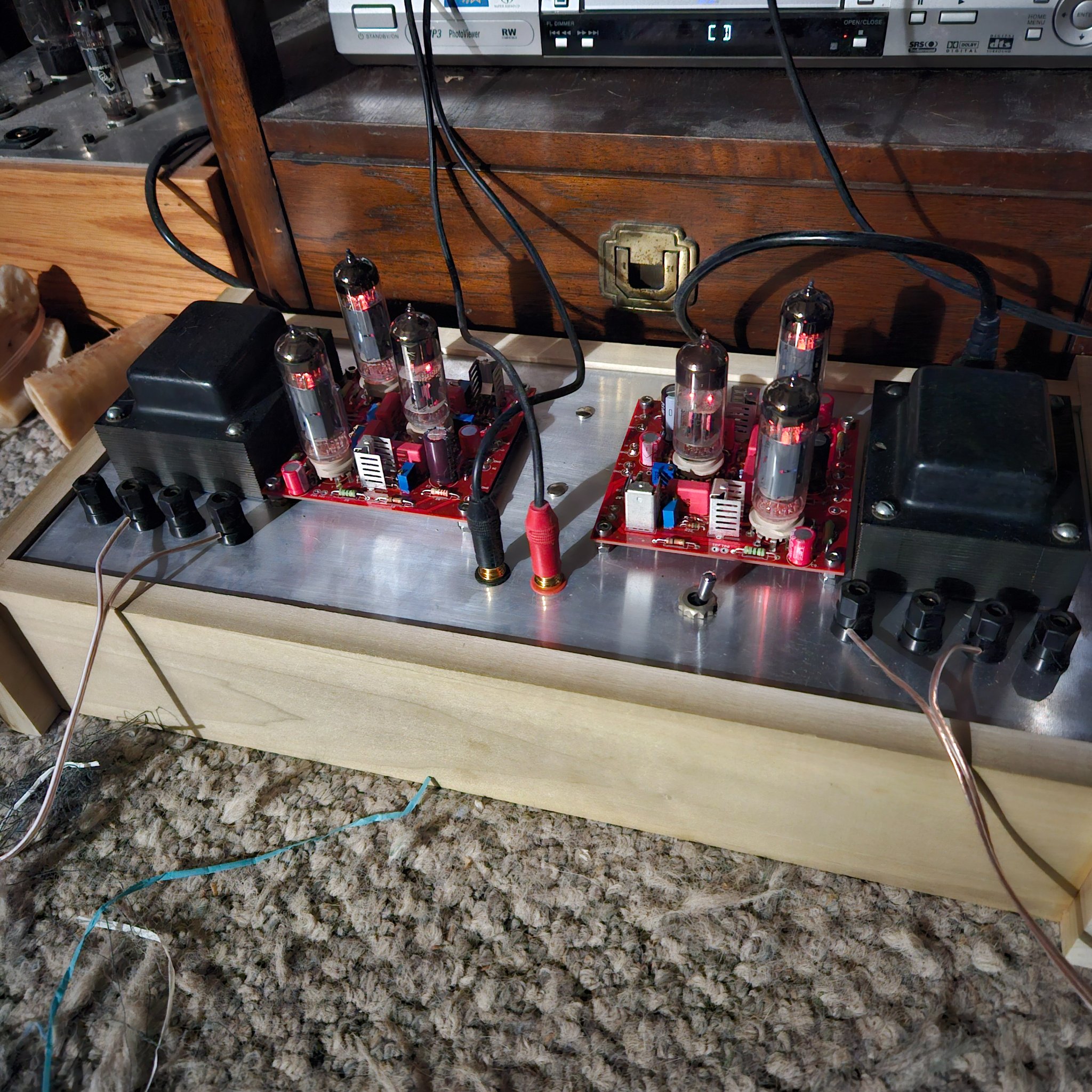

Thanks for your interest.Cool, pretty nice looking for "slightly rushed". I just painted my build black. LOL.I just did a slightly similar project.....slightly rushed
Have you made any performance measurements?
Is the front end of your build a pentode/triode combination tube?
Any chance to see your schematics? Best part of this forum is learning from others work.
The schematic of the amplifier was included in my first post as the attached PDF file.
Unfortunately the forum can not provide a preview for attached PDF files so they are very easy to miss.
I did not post the power supply regulator schematics as there so many ways to provide regulated rails.
If you have interest I can post the power supply schematics as well.

The front end is a triode/MOSFET cascode. Effectively a pentode without the ability to swing its plate below screen voltage, but with no screen current. 6H6Pi and FQP1N60. Rides on a CCS to do phase splitting, and the LTP E-Linear rigged to the 28% taps of the OPT. Finals are 6P15P-EV running B+ of 300V thanks to an Aliexpress SMPS that does heater voltage as well. No measurements yet, power is adequate for open baffle EV Wolverine 8".

I understand the BJT base current reduces the gain a bit but by such a small amount I feel it can be ignored.A small mistake in the text... 😉
The base emitter resistance also reduces the gain as it allows a tiny signal on the lower triode that reduces gain however the amount of loss with a BJT is very small.
Oh I think I see my errorIn a Cascode stage total gain is largely a function of S in mA/V of the lower device divided into the top load impedance.
The total gain is largely a function of S in mA/V of the lower device multiplied by the top load impedance.
Math was never my strong point.
This is a interesting circuit you have.The front end is a triode/MOSFET cascode. Effectively a pentode without the ability to swing its plate below screen voltage, but with no screen current. 6H6Pi and FQP1N60. Rides on a CCS to do phase splitting
I will have to spice it to see fully how it works.
Thanks for sharing.
Enjoy spicing. I would love to see the results, especially if you could try a few other MOSFET's. I did a fairy exhaustive search when the FQP1N60 was current, and a smaller one when this amp came into being and did not find any I liked better. The CCS tail load is an IXTP08N50D2 over a DN3545N3 cascode.
