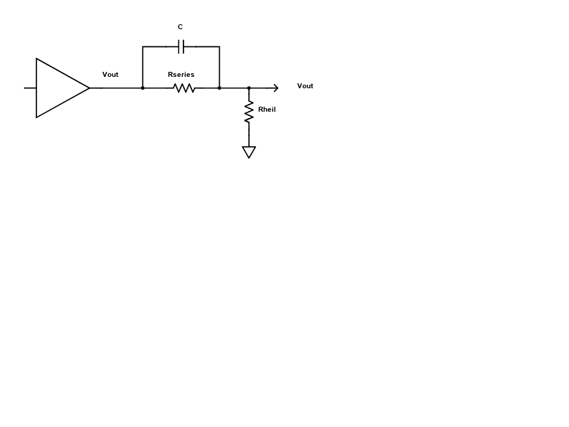

Converting AMT tweeters into headphones. Why would you need a low pass filter, since they drop off below 1kHz?
To boost the highs, you have to cut the lows instead.
The factor for cutting the lows is: Rheil / (Rheil + Rseries).
In dB that is: cut (dB) = 20 x log (Rheil / (Rheil + Rseries))
Choose the capacitor for the frequency where the cut starts.
I read that using a resistor in series will make it possible using just the capacitor without adding a coil, is that true?
Yes. It is more popular with tweeters when you use a series resistor and a shunt inductor as the only crossover components.
It can also be done with woofers but it is not popular. The thing with the series resistor is it should be high enough so the amp is not uncomfortable. With a tweeter you are already using a resistor to reduce the level. This is how you decide the value.
With a woofer you should use a few ohms at least, this resistor may get hot. It will change the bass at resonance a little, this is easier with the tweeter because the inductor reduces the impedance peak.
