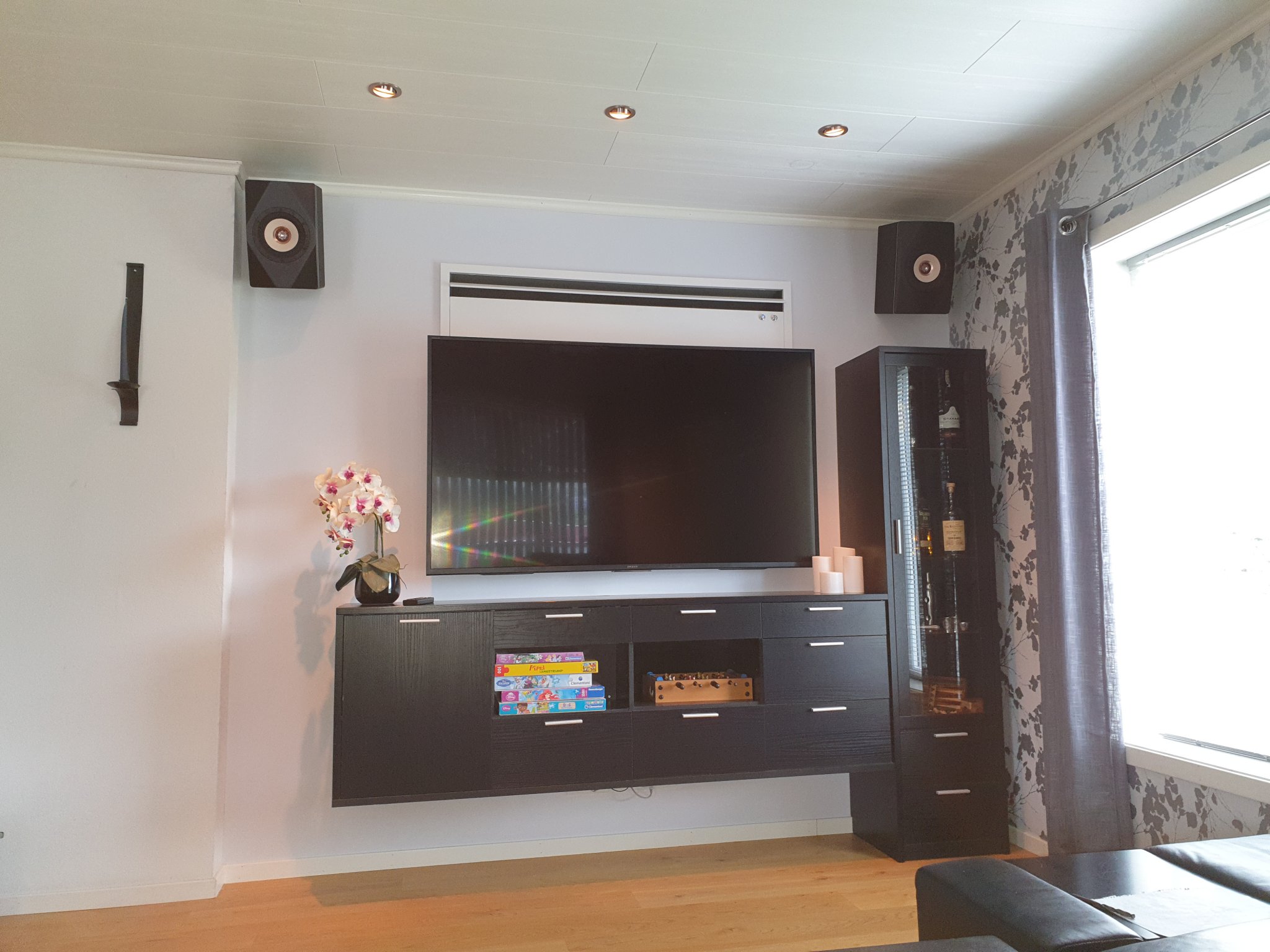

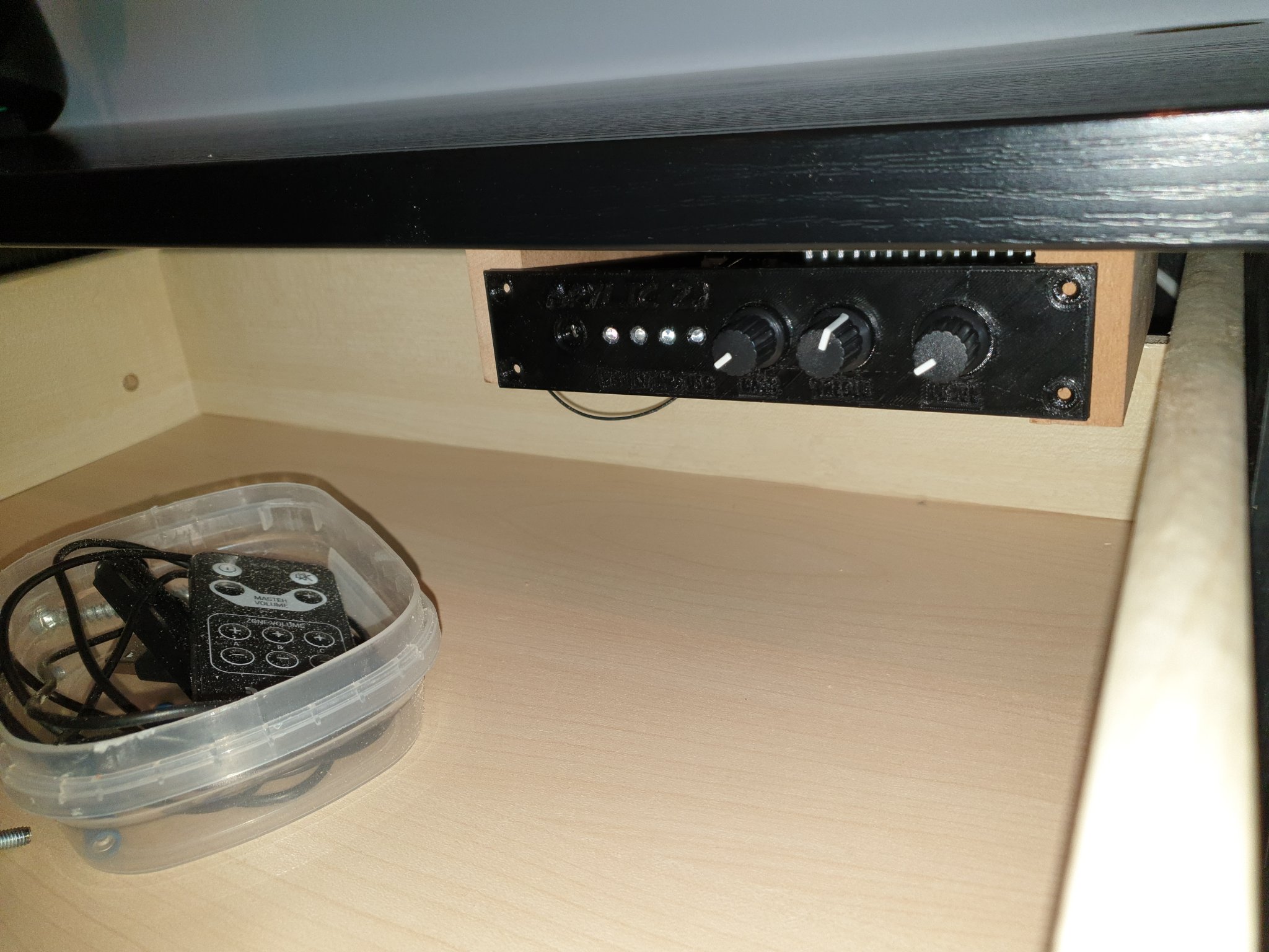

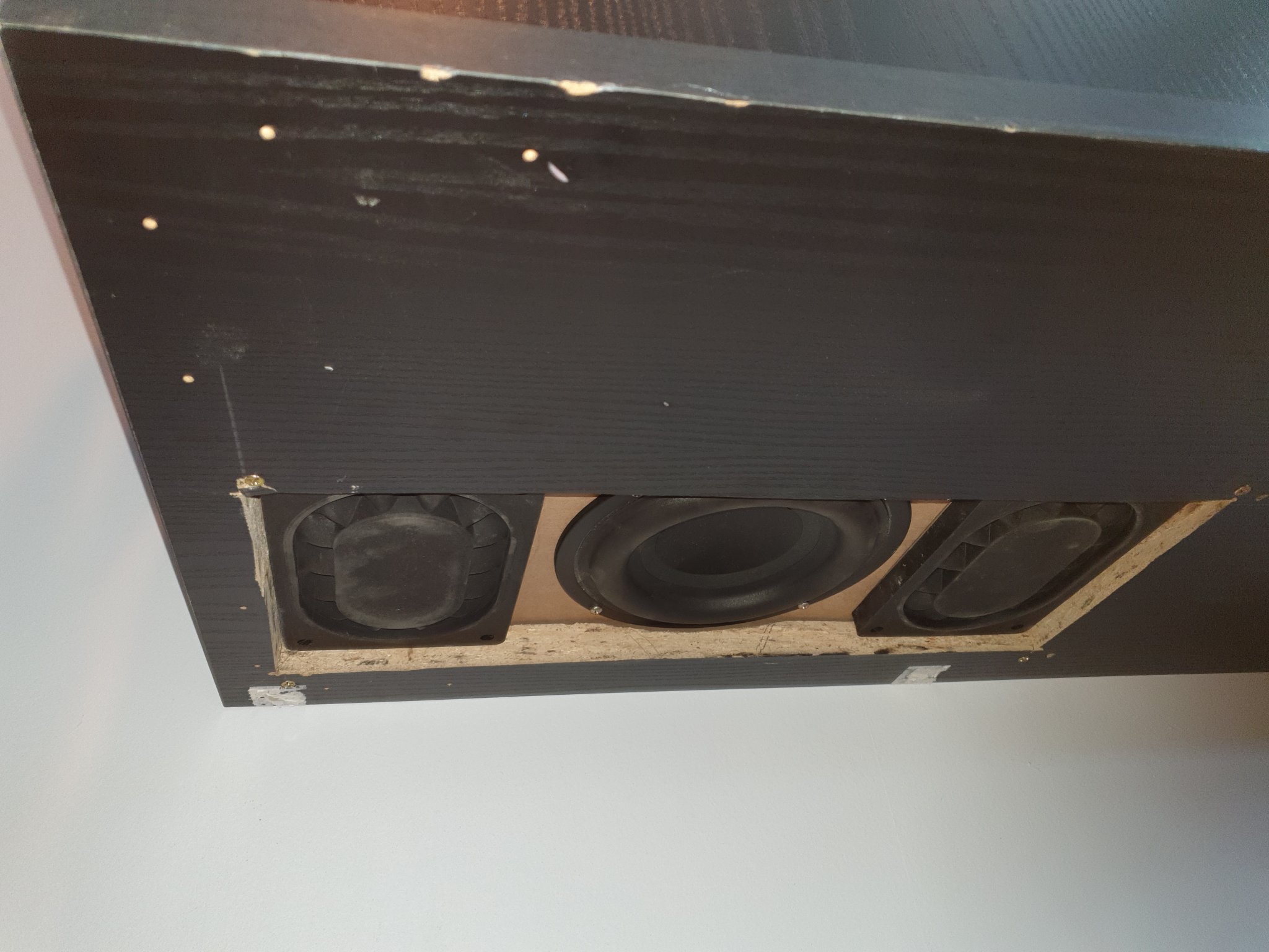

I've used it for two projects, both of them stereo+subwoofer.
This is my first, subwoofer and the Up2Stream built into my TV bench, also driving bookshelf speakers:
Not the nicest subwoofer box, but you have to lie on the floor, looking up under the bench to see it... so I really do not care.
The amplifier and power supply is hidden inside a drawer.
Out of the box the Up2Stream 2.1 is 2x50W (4ohm) with a 100W (2ohm) subwoofer output.
There is built-in DSP, so with additional PC software (ACP-Workbench), you can make various filter, change it to a 3-channel mono setup with active crossover etc.
If you ONLY want a subwoofer amp, they have a card with only the 100W amp and a low pass filter also, called the Up2stream AMP SUB.
