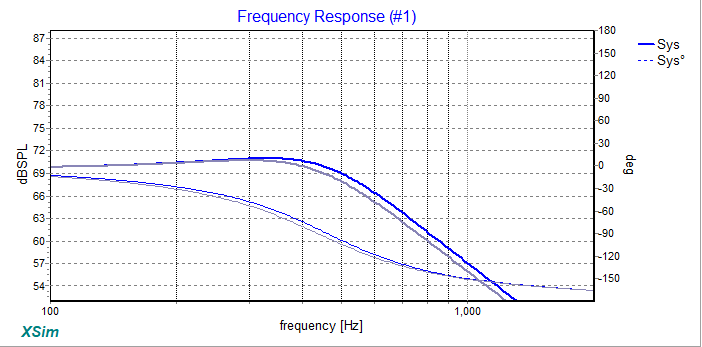

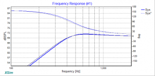

To give you a visual, here is a 2.7mH vs 3mH inductor as typically used in a two-way high pass filter, and a low pass filter. The gray line is the 3mH inductor, the 2.7 is the blue line.
You might see 1dB difference at the crossover point. That's just the most basic idea of what happens. An inductor impedes the passage of high frequencies. The larger the value of the inductor, the lower the frequencies that it impedes. So in a high pass filter a 2.7mH inductor with allow slightly more highs thru than a 3mH inductor when connected to the same speaker driver.

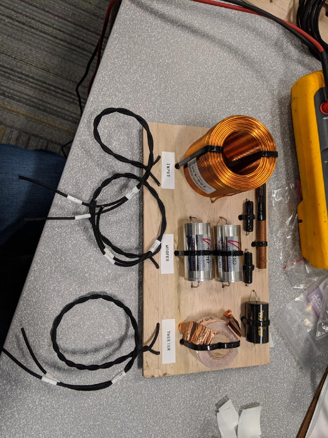

You guys are awesome. Thanks for the education. I'm going to try and attach a pic of the crossover and parts list that's been made for my friends set of speakers. They are a simple two way bookshelf. Fwiw they are ported which isn't my favorite. Honestly the mid bass was every so sightly strong. If a different value inductor will lower the mid bass then it might be advantageous. I was actually going to experiment with plugging the port to see how it changes the sound once the speakers are finished.
.3mH 16gauge inductor
3.0 mH 16 gauge inductor
6r ohm 10w resistor
1r8 ohm 12w resistor
6r2 ohm 12w resistor
6.2micro F cap 400vdc
12 micro f cap 250vdc
6r ohm 10w resistor
Thanks for the photo. I can't quite make out all the values, but the woofer inductor is a 15 gauge 3mH inductor. It look like the tweeter inductor is a 0.3mH foil? The tweeter cap appears to be 5.6uF. Your list helps.
Those values seem unusual for a normal two-way woofer/tweeter crossover, but it might have to do with driver impedance and attenuation.
I've sent my buddy a link to this thread. He actually knows and understands this stuff. Hopefully he'll chime in. I'm just trying to use the best parts that are within reason cost wise. The goal is to have two sets of like speakers with some small differences to see if we can hear any difference. I've never done anything like this so I'm really in the dark. The initial set of speakers he built were surprisingly good and not even broken in!
