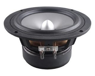

I choose for the mid-bass the Fountek FW146 : good T/S parameters, flat response low distortion low cost (about 30€), and good looking 😀

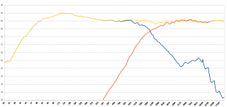

Then i started to design the filter, i choose a 2° order one.
After spending hours to try to optimize it, i think it's the best compromise. In fact the flattest i can do...

you have great computer skills, im makig a pair of three ways, i like your modeling, looks better than my pen drawing with webcam pics.... you also seem fairly good understanding how to cross over speakers,
i must say that woofer looks good. however i must also say, that tweater looks like a piece of junk. i mean it has a hexagonal grill thing (bound to mess with the sound....even if not on paper....) but im sure you can remove it if needs be

I'd cross the tweeter over higher, you're a bit close to it's resonance freq;

@ PeteMcK I know that it's very close but in fact i want to be as close as possible of the line array configuration at the cross-over frequency.
Thanks to sreten i found that http://www.humblehomemadehifi.com/download/Humble%20Homemade%20Hifi_Extremon_copy.pdf
they cut the same tweeter at only 1750Hz... so 2K it's not that bad finally.

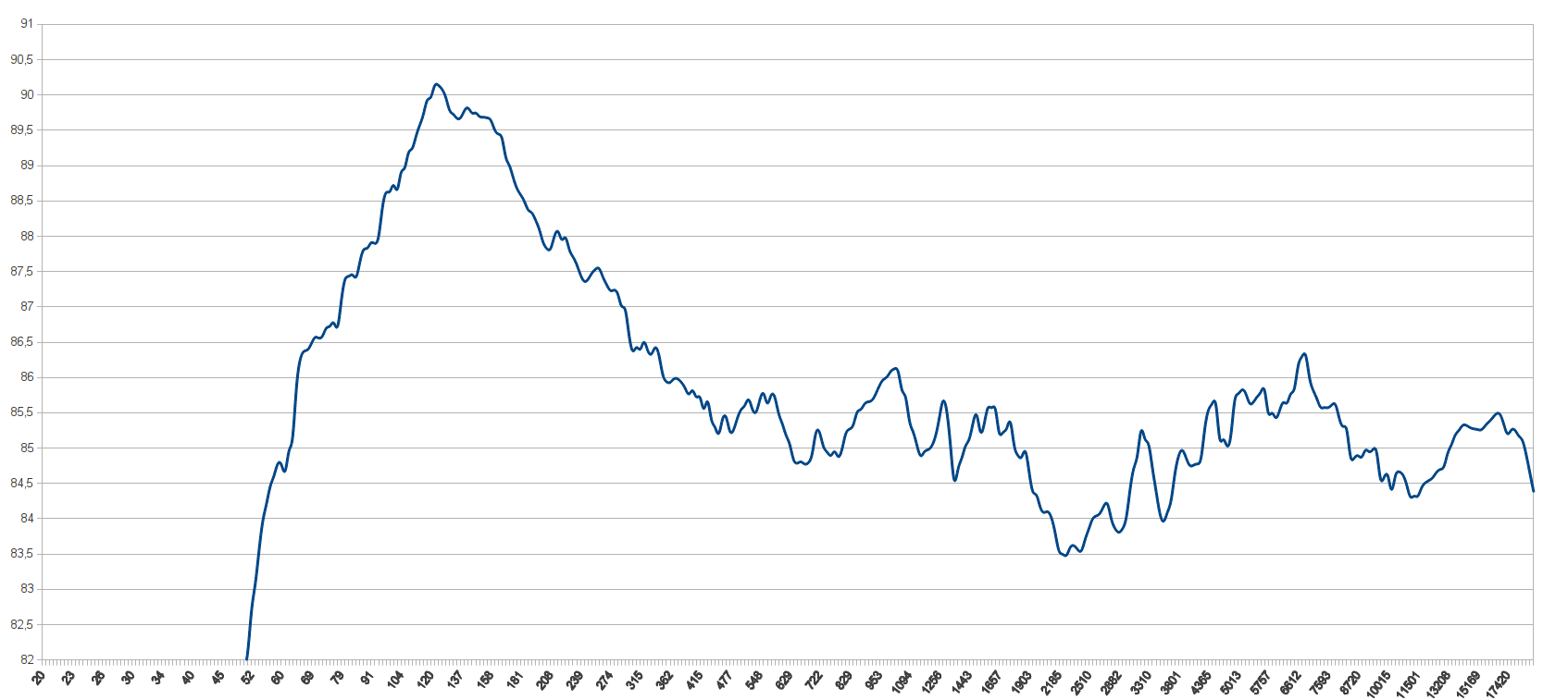

For the metal break up peak i think it not will be audible because it's rejected to -35 db with my cross
-over and then -35dB(filter)+15dB(peak) is -20 and then on the graph -20dB+0dB= about 0.25dB
Probably right but it doesn't do any harm to look at the options.
A cheap highish resistance air core and capacitor across the
driver isn't expensive and can work with a single BSC inductor,
see Zaph's L18 design for the general gist of the approach.
The real issue is the peaks effect on distortion profiles and crossing
the bass/mid as low as possible for this reason is a good idea.
Note that you need to target the final acoustic x/o and slopes,
not electrical filter targets, though your doing far better than
most in modelling the driver impedance profiles. There are
other ways of doing it as described in the FRD tools links.
(zma files for impedance rather than equivalent models,
frd files for the drivers measured for given circumstances.)
rgds, sreten.

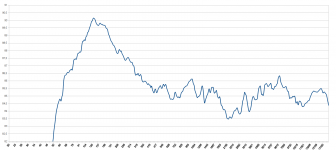

Hello !
This is my last simulation with the real speakers spl charts
i will not correct the baffle step because it's very balanced by the room gain for me (the enclosure will be right against a wall :/ )
It's not as good as i thought but but i will do with it...
If the result is bad i will correct it with the exelent JAMin equalizer while i know the response of the speakers
