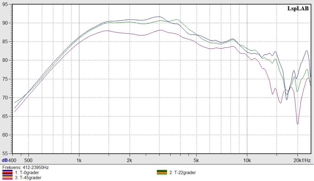

18Sound engineers designed the XT1086 horn for the NSD1090 and NSD1095N.
NOTE: From the datasheets, the NSD1095N "really" requires the higher(1600Hz) LR2/LR4 Xover more then the NSD1090.
-----(this is why you do not want to copy the 18Sound 12" 2-way design which uses the NSD1090)
18Sound engineers designed the XT1086 horn for the TiN coated NSD1095N.
--XT1086 and NSD1095N have a matching exit angle of 27 degrees.
--XT1086 and NSD1095N spec a 1,600Hz LR2/LR4 crossover.
----The XT1086 documentation polar plots provide strong data for using a LR2/LR4 1600Hz crossover.
The 18Sound SPL data shows the 12W40 does not have the correct 80-degree polar response at 1600Hz.
--The 12SW40 is designed as a woofer and not optimized for midbass performance.
The 18Sound 12NMB420 has a low inductance NdFeB motor and light cone and has good 1600Hz polar performance
**STUDY THE 18Sound 12NMB420 midbass as a possible purchase.
-----The Faital Pro data shows the 12FH520 is also a good midbass partner for the NSD1095N.
The XT1086 is 126mm deep, and the 12NMB420 is ~90mm deep at the pole, 126mm total depth.
--Probably ~10-15mm difference between the XT1086 + NSD1095N phase plug depth. The crossover needs to "fix" this time delay.
18Sound recommends a LR2 crossover frequency of 1,600Hz for the NSD1095N 1" compression driver. This favors 10" midbass with the XT1086 horn, but a FEW 12" midbass like the 12NMB420 approach an 80_degree polar directivity pattern at 1600Hz BUT probably also require steeper LR4/LR4 slopes.
----An LR4/LR4 crossover at 1600Hz can help smooth-in a 12" midbass 80_degree polar to match the XT1086 horn.
----There is a LR4/LR4 crossover spreadsheet which calculates how to cover a modest T-M time delay offset using a modest frequency shift on the tweeter.
Computer Model the NSD1095N on the XT1086 horn with an LR4/LR4 crossover at 1600Hz to the 12NMB420.
Google and Download "DRIVER OFFSET CROSSOVER SPREADSHEET"
---enter midrange LR4 1600Hz. enter tweeter LR4 (starting at) 1600Hz and make small frequency changes to reduce ripple.

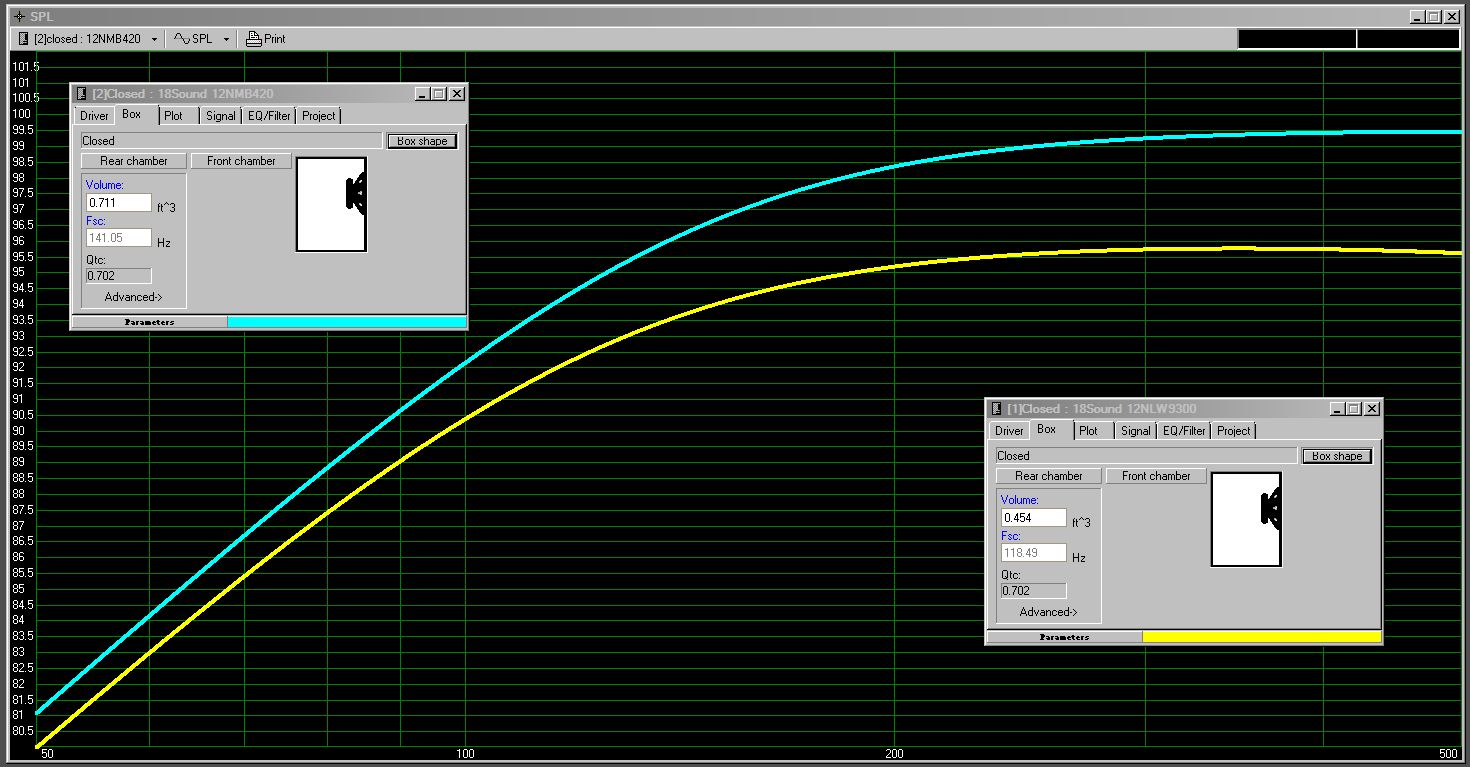

A sealed midrange alignment has superior sound quality over a ported midrange alignment....BUT very limited low bass extension below 100-200Hz.
The 1600Hz Xover demand for the NSD1095N on XT1086 requires a midbass with T/S parameters which cannot ALSO produce bass below 100-200Hz.
You need a 3-way design with real woofers crossed in around the 200-200Hz baffle step frequency.

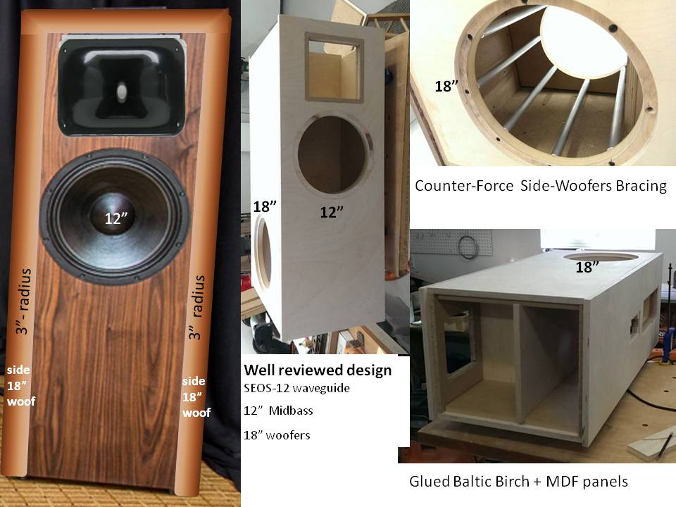

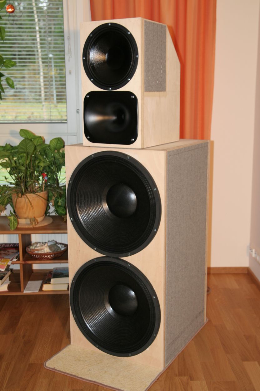

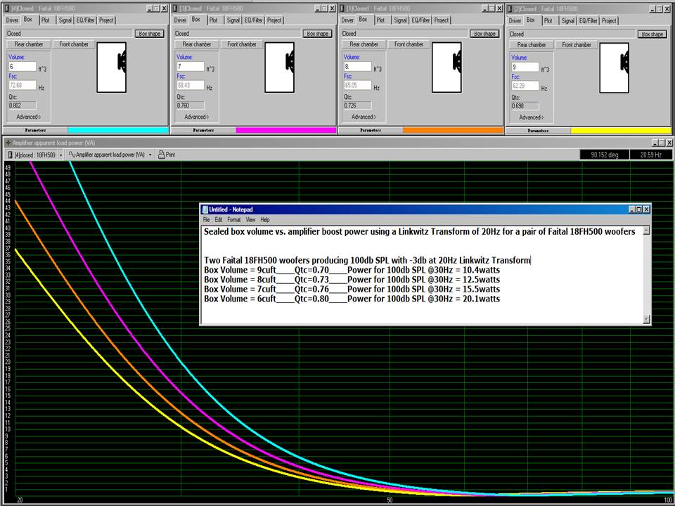

Pictures:
-SPL for NSD1095N on XT1086 illustrating why 1600Hz Xover is recommended by 18Sound
-example for 3-way XT1086 + 10" midbass + two 18" front woofers to match high SPL/watt
-example for 3-way XT1086 + 12" midbass + two 18" side woofers.
-----Few 12" have 80polar @1600Hz. 18Sound 12MB420 midass looks good.
Pictures:

* Which system is it that you show in the picture Linesource? The one with the 2 side mounted 18 inch woofers? Do you have a link? Is it a reflex cab or sealed?
My sketch of a high efficiency, narrow box 3-way is similar to the Tweek Geek BMF-1 design(which uses 12" side woofers) that you can study at:
BMF-1 - 98dB, 4x12 powered subs, 12 in Midbass, AMT HF driver - Tweek Geek

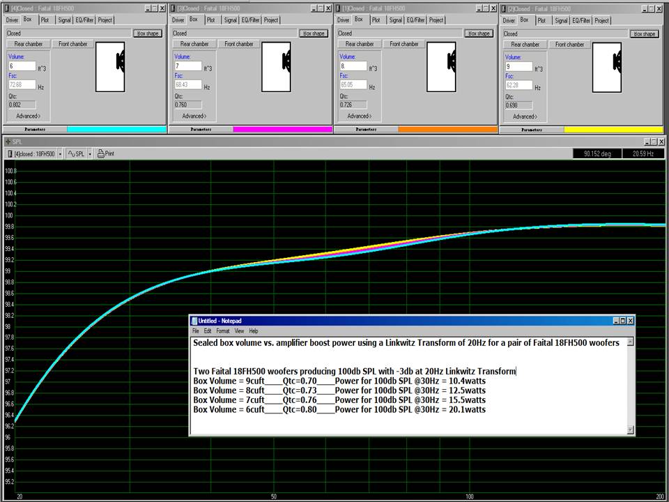

Sealed box volume vs. amplifier boost power using a Linkwitz Transform of 20Hz for a pair of Faital 18FH500:
Two Faital 18FH500 woofers producing 100db SPL with -3db at 20Hz Linkwitz Transform
Sealed Box Volume = 9cuft____Qtc=0.70___Power for 100db SPL @30Hz = 10.4watts
Sealed Box Volume = 8cuft____Qtc=0.73___Power for 100db SPL @30Hz = 12.5watts
Sealed Box Volume = 7cuft____Qtc=0.76___Power for 100db SPL @30Hz = 15.5watts
Sealed Box Volume = 6cuft____Qtc=0.80___Power for 100db SPL @30Hz = 20.18watts

Because of the design of the towerspeaker, which will have bended sides, i cannot place 2 18 inchers per channel i think. What do you think if only one 18 inch unit per side is used? I'd guess it will funcion also?
Is the plateamp gonna be good enough, up to 120hz. Can de 12 inch mid (which i still prefer better dan usig 8 inch) go low from 120hz and up, in sealed enclosure?
(seperate chamber in the enclosure, something like the BMF-1)
So thanks again Linesource for your thorough look into this new speakerplan. Hope that you can help me with these above followup questions. I like the tip you gave about the BMF-1 because this is something i would like to build.
However, a cabinet in BMF dimensions is way to big for my livingroom.
Btw: The drivers i'm planing to buy for the 3-way bass is also probably gonna be Eighteensound. This brand is commonly available where i live, good prices also.

WinISD SPL plots for sealed 12NMB420 F3~140Hz and 12NLW9300 F3 ~120Hz easy crossover to most woofers. Note higher SPL/watt with 12NMB420.

If you want to stick with a 2-way and that 18Sound 12W500, have you looked at this:
Kaiutinrakennusohje - Dynamiitti - 12-tuumainen hifi-PA-kaiutin | AudioVideo.fi
It's from the same source as that Nitrosäiliö design you mentioned. I heard this one at the office when it wasn't yet quite finished, and remember enjoying it quite much. We blasted the bugger so hard with a pair of 700W monoblocks that it started farting damping wool out of it's reflex ports. They took it quite well. And they're not just for blasting Infected Mushroom at earsplitting levels.
Yeah, you'll get more bottom end with a 3-way with an 18" bass driver. If that's really necessary.
PA drivers can get quite addicting once you find the good ones. And after you've acclimated yourself to those, most of the usual crop made with a 6.5" "bass" and a dome tweeter start sounding very, very uninteresting.
