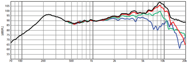

Your big issue is going to be directivity at the higher frequencies, in the range of 2-9K. The Neo 10 will beam very narrowly in both horizontal and vertical, It will make it difficult to get the balance right in anything other than a narrow window. You may be able to use absorption and blocking to widen the directivity, but you will give up a lot sensitivity in the process. Instead, you may want to use the less expensive Neo3, or now the GRS PT2522. Still a very good tweeter.
Neo 10 varies 30 db on-axis to 45deg. The notch filter you will need not help with the off-axis response.

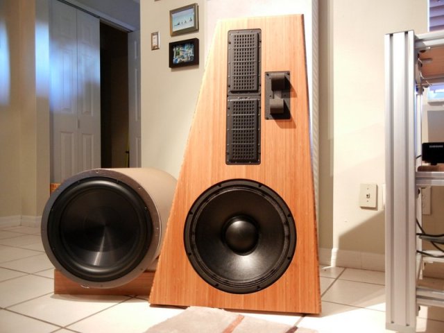

I haven't used Neo10, only Neo8 and Neo3 as dipole. The problem with Neo10 is it's width (radiating area and frame)
To get smooth directivity (to get even off-axis response) an OB (or dipole) speaker must use at leas 3 drivers and baffle shape that gets more narrow towards higher freq/drivers
Anyway since you have those drivers and dsp, first make simple and cheap test baffle, take measurements and modify baffle shape and see what happens and how it sounds. I you get annoying problems with sound, get a tweeter too and make it 3-way. And perhaps a sub...
Linkwitz and Kreskowsky as well as Finke went to narrow mid-treble baffles and 4-way designs for a good reason!

Back to your original about baffle size and shape, it will not have a significant effect on beaming of frequencies between 2-9 kHz. You would need to reduce the radiating area at high frequencies using foam or felt as Studiotech recommended. This will reduce efficiency at high frequency considerably, and you will still need a notch filter, although probably less dB.
I would start with thin melamine foam, as this material has high absorbance at high frequency, and progress to felt or polyurethane foam if the melamine is not sufficient.
