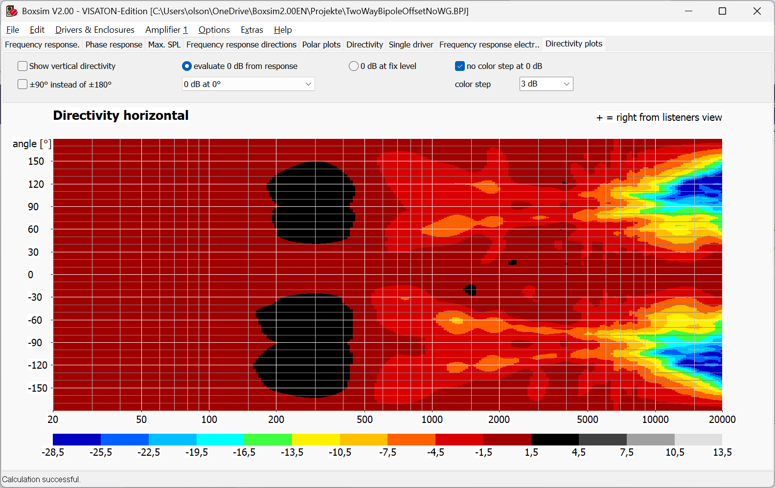

I have been looking for some time for an approach that leads to a loudspeaker with good omni directional properties as well as accurate stereo imaging.
I hope this can be achieved with the this concept:
note: for the simulations I used the possibility in Boxsim to simulate a rectangular enclosure. So, if practice and simulation disagree: blame Boxsim
The argument goes as follows:
If we tilt a conventional speaker 90 degrees backwards we hear at the listening position the signal 6 dB softer and high-frequency filtered.
The cutoff frequency in the listening direction depends solely on the cone/dome diameter of the speaker ( Fc Ξ 1/d ). For amplitude, box size, form and driver location don’t matter. For phase however it does, and that’s important.
This low-pass filtering is a sort of “free lunch”.
Woofers and tweeters can be placed on the cube. Below a possible configuration of 2 tweeters and 2 woofers is given with its corresponding spl at the listening position. Besides the cone/dome diameter, the drivers are considered ideal.
On top and bottom we have 2½-inch woofers and at front and rear ½-inch tweeters, all placed at the centers of their baffles. The tweeters are high-pass filtered (Fc= 4 kHz, Q=0.7). The woofers are not filtered.
The spl already looks reasonable and can be further improved.
After trying some placements for the drivers for a while I found a placement that gave a quit nice results:
The system distinguish from a conventional 2-way systems by a much better directivity.
In the simulation, this concept produces a loudspeaker with good omni directional properties and a fairly flat spl in the horizontal plane over a reasonable angular range, which should give a wide sweet spot and decent stereo reproduction.
The crux of the concept is that, for every viewing angle, never more than 1 woofer and 1 tweeter are in direct “sight.” This eliminates direct interference between drivers. It seems simple, or am I missing something ?

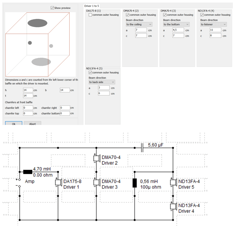

Chosen is for affordable drivers. The drivers proposed are:
1 x DA175-8, 6 in inch driver as subwoofer (in a 30 liter closed box)
2 x DMA70-4, 2½ inch full range woofers (together in a 1.4 liter closed cube)
2 x ND13FA-4, ½ inch dome tweeters placed on the cube
The optimized placement of the drivers on the cube is shown in the following figure.
It was just a matter of trial and error until finding positions giving a reasonable result. (probably, with some more effort, better results are possible).
Furthermore, the passive crossover can be very simple, note that the midwoofers are not filtered at all.
The simulation results were similar to those in the first post, so I don’t show them again here.
The cubes have to be placed at ear height. Because of the relatively high Fr of the cube, it is necessary to give each cube its own subwoofer. They have to be placed directly under the cube on the floor. The stand between subwoofer and cube should be thin so as not to stress the radiation pattern of the down firing driver too much.

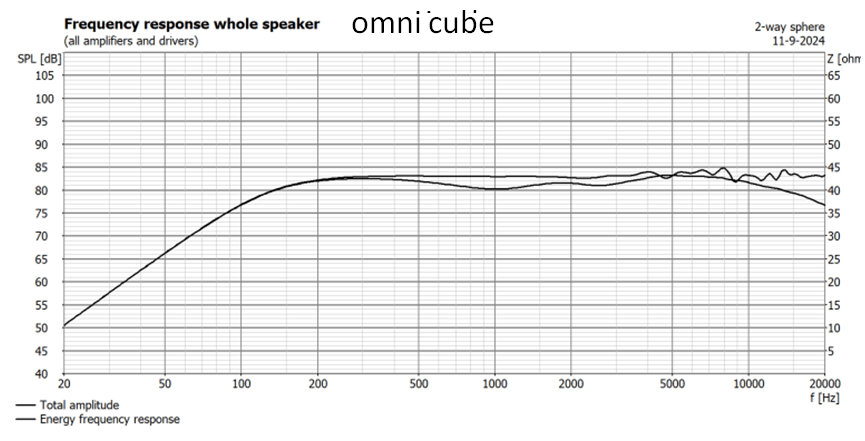

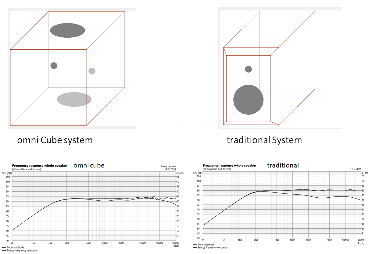

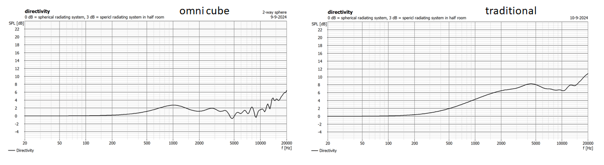

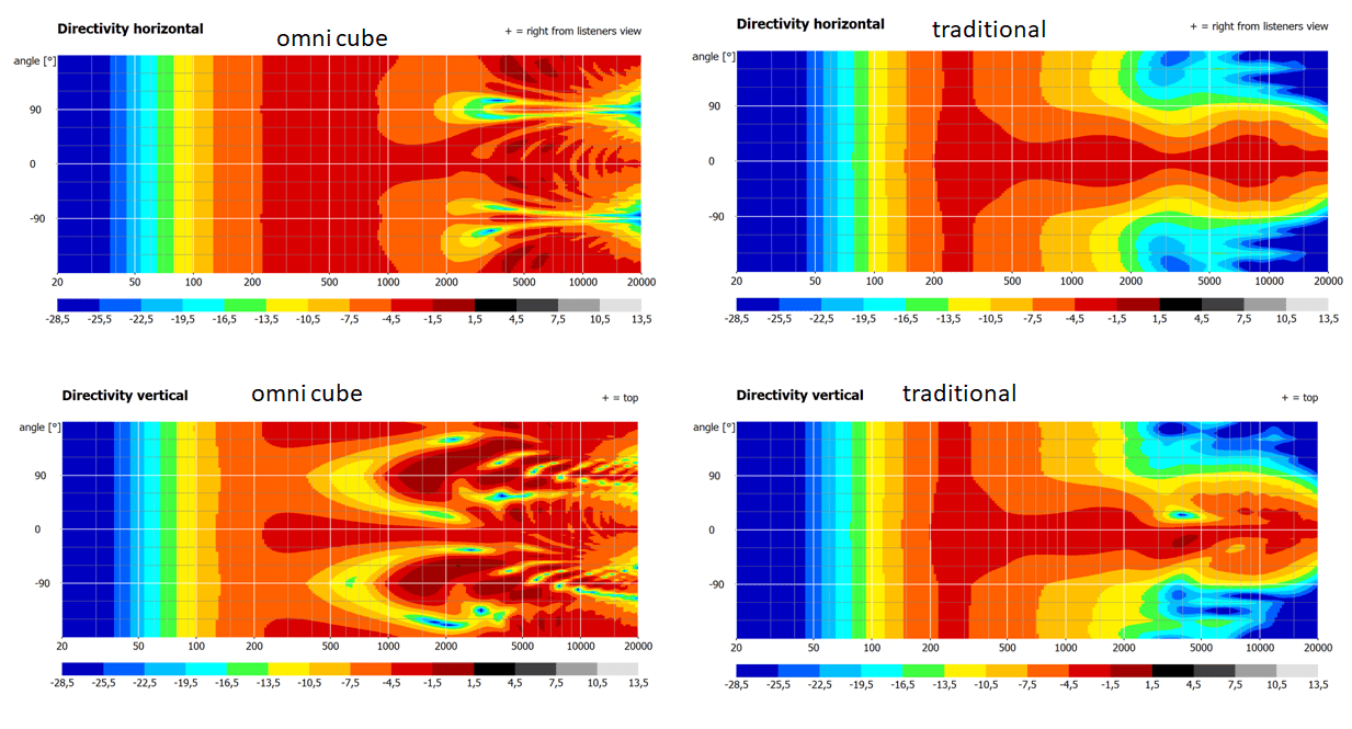

Simulated performance comparison between omni cube and a traditional 2 way system.
Both systems have the same drivers, the DMA70-4 2½” woofer and the ND13FA-4 ½‘’ dome tweeter. Crossover was at 4000 Hz.
The traditional system was compensated for baffle step. Omni cube needs no baffle step compensation.
The subwoofer was not included in the simulation.

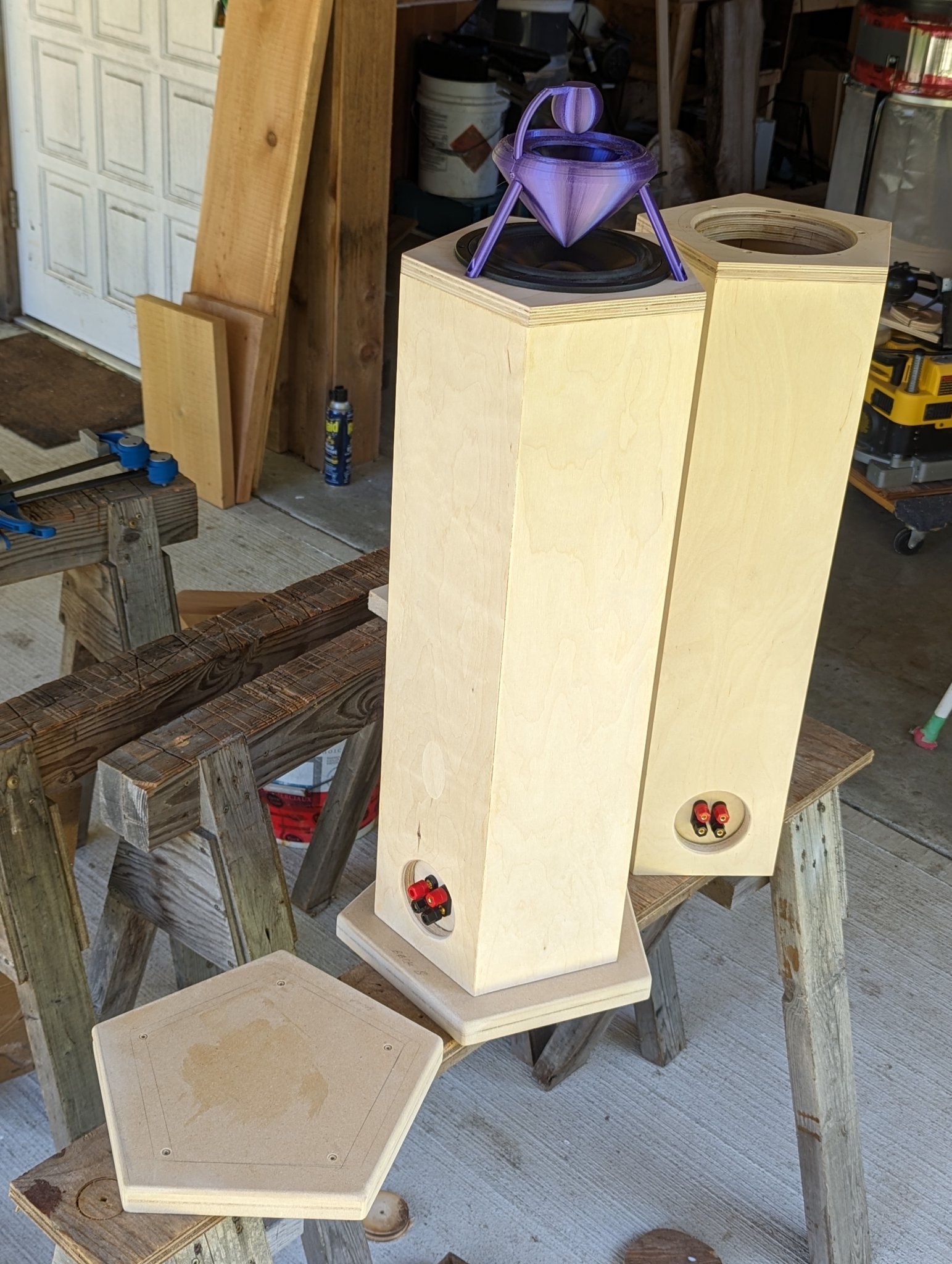

Reading through this I got inspired to give it a try. I also was looking for a way to make an economical two way bipole speaker with a nearly omni pattern. I just took the example design in Boxsim and doubled the number of drivers, putting the second set on the back panel. The crossover isn't right yet, but it looks like this could work. The wide and shallow cabinet seems to be the way to go. So it's sort of a cube that got run over by a truck and flattened.
- 2-way omni cube speaker
