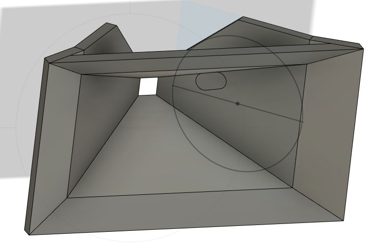

After long reading and considerations, I decided it would be good to find out if I was able to build a small Synergy horn using CNC and 3D printing. There are many designs floating around, but most of them just do not fit my idea of size and complexity of build. SPL Runt looks like a good candidate for such a project, so I will use it for inspiraton.
The target is crossover to bass at 135 Hz and 120 dB / 1 m at full power. Or as close to this as practically possible. Crossover via DSP, option for passive would be nice. Speakers to be used - most probably BC 8PE21 and DE500 for the prototype. Most probably, other CD will need to be used (e.g. BMS 4550). Prototype will use 18mm MDF, since that is what I have at hand.
Step 1 - 3D model - is done (well, without some details depending on step 2).

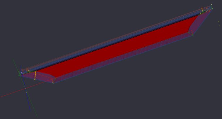

Step 2 - Hornresp model to tune the design. Attached. Not sure, if this is good, bad or usable. To me it seems I can reach my target with a bit of EQ.

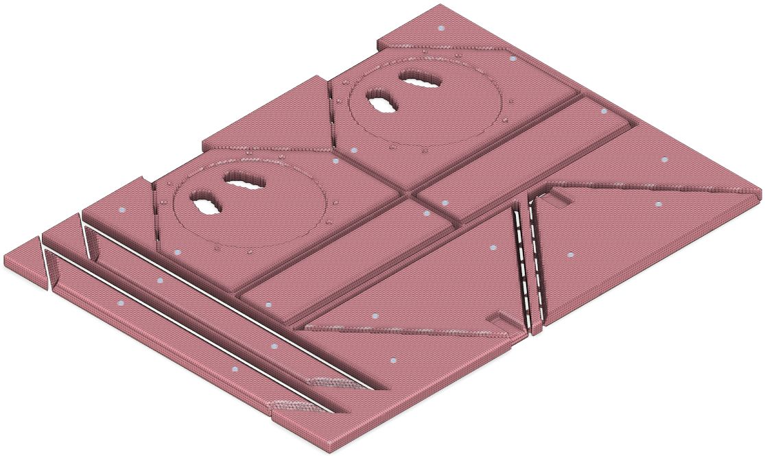

Step 3 - prepare CAM files - WIP.

The horn parts should fit onto a 600 x 800 mm plywood sheet. No box designed yet🙂

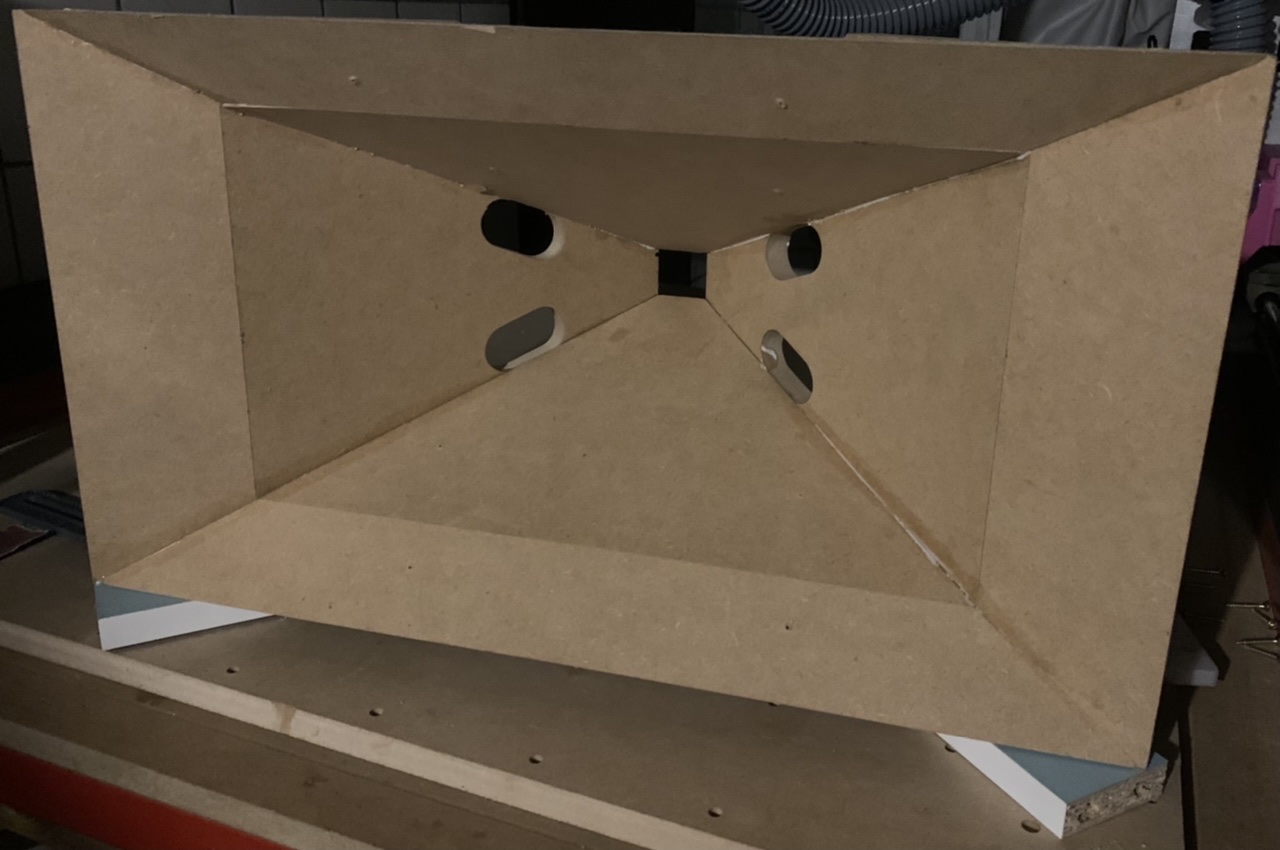

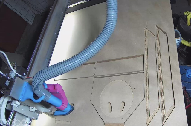

So after some problems with CAM and also the router itself, all the parts are machined now. The final unit will for sure be in plywood. But even the MDF should fit together well after some sanding. I hope I will have a few minutes tomorrow to glue some of the parts and I will also print the throat adapter.
Once cut, this thing is really tiny🙂 Definitely a good learning step before trying to build a large 2 way box in future.

Primary and secondary flares are being glued together. In dry fitting, there was some slight misalignment due to machining errors, but it seems the result will be usable. I wonder how difficult it will be to glue together🙂 The driver flange is just being printed as well. The last things to sort out are the insert nuts and making a cone plug for the 8PE21s. Pictures will follow later.

Dry fitting has shown that gluing these together will not be that easy. Any tips or ideas?
Screws. Ratchet straps. Bar clamps.
Kreg pocket hole jigs make putting the screws in at the correct angle easy, though you may still need to use wood filler to cover some heads.
Since the sides are square, I will mount some scrap pieces to the bottom, align with the top and bottom and use tape ratchet straps to hold all together. And maybe a screw here and there.
It did not work really as expected. Next time, I will route some jigs for gluing everything together. There is still some free space on the board for them. I tried to align as square as possible and hope that gravity "clamp" will be sufficient.
Conical horns are easy they say. Well,my first one is definitely not perfect, but it will work. I need to buy more wood filler🙂
And I will try a different way of gluing next time. I need to figure out how to drill holes at the correct angle for fixing the panels.
You could try packaging tape for difficult to clamp areas like the secondary flare to the main flare.
IIRC, Bwaslo recommended dots of superglue to hold horn pieces in place while the wood glue dries. I used his method and it worked for me.

I think it will look OK when wood filled and painted with a textured paint. Any plans for the round to square transition and mounting plate?

I filed and sanded it a bit and it does not look that bad at all. Now wood filler is drying. The round to square plate is 3D printed. I filed the throat flat and it is almost a perfect fit. Since this is just a prototype, it will be fine.
