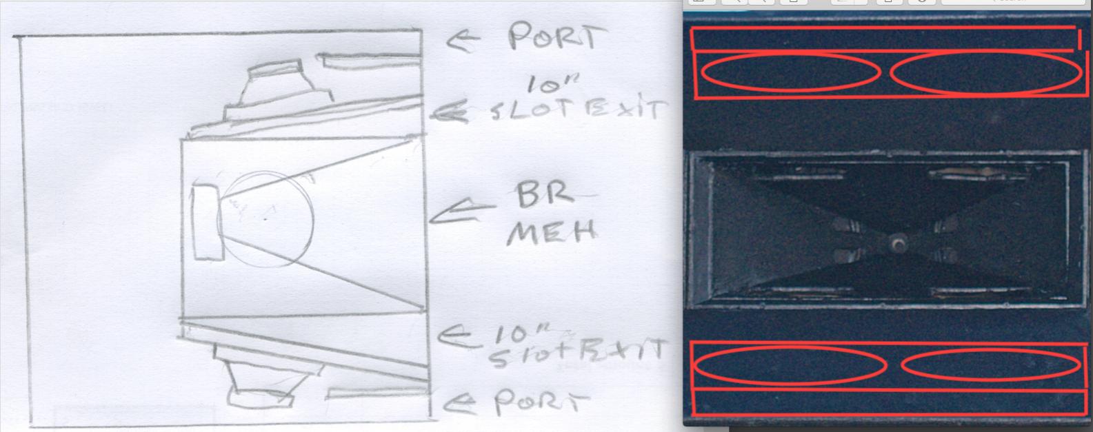

My question was just general, but a particular project I'm dreaming of would literally have a big horn in front and woofer(s) hidden away. Ideally this would be on the back of the enclosure, which would require a horn and driver to go quite low, a woofer to have a robust power response, and the gods to smile on the slot loading happening against the walls behind. Failing that I suppose some kind of slots could be employed on the front, engendering other resonance problems. Basically I want to make something different looking.

Hmmm...so yes ideally you would have opposed push-pull for distortion and vibration cancellation. However if I try to cross over to a horn, that means something like 400-800 Hz. At that point, resonances in a slot are most likely not ignorable. And I'm not sure how I could do the push-pull...I guess if I had one driver on the front below the horn, and another at the back facing the same way. It would kind of waste some cabinet volume which I probably have enough of.Push pull, slot
The bigger problem is it will look like a horn with a big woofer underneath; I'm dreaming to make something different looking. I've considered a vertical slot under the horn with woofers facing-that would look unique but is not push-pull. Or I could try to flip around and mount one woofer magnet into the cone space of the other however I suspect the resulting cavity would resonate a lot and quite possibly act as a significant unpredicatable lowpass filter.

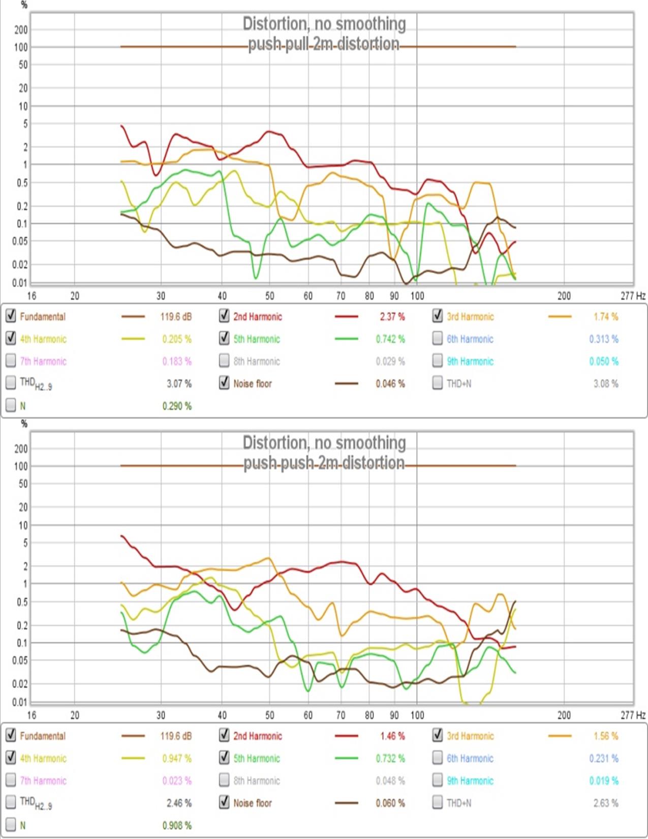

I tried the sub both as push-pull, and push-push.
THD wasn't really much of a difference between the two.
Whereas motor vent noise from push-pull with one coil hanging in the slot, was clearly worse with push-pull.
Here's a THD comparison at 125dB SPL /1m level.
I believe THD reduction with push-pull is a benefit with some drivers and not with others, depending on how well behaved they are at excursions. (i used bms 18n862 which are supposedly well behaved.)

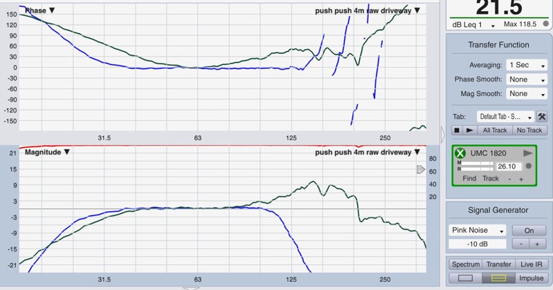

My dual 18"s have an 11" slot. You can see the slot boost in raw performance in transfers below...raw and processed shown.
As sound pressure is not function of speaker cone displacement, but cone acceleration, so distortion reduction is not so obvious with push pull configuration.How about a 30db reduction of the 1st harmonic distortion ?

On page you linked can be seen that 2. harmonic is reduced significantly, but 4. is reduced only very little. Can be that for images 30 Hz is selected because it has big reduction on 2. harmonic but on other frequencies reduction is not significant?
You illustrated also my point in last post very well with measurements.O
Just as Nick McKinney said a couple decades ago, a crappy woofer will benefit from push-pull (those usually won’t have a pole-piece vent) and if decent woofers go push-push.

Head_unit,However if I try to cross over to a horn, that means something like 400-800 Hz. At that point, resonances in a slot are most likely not ignorable.
Using a two-way bass reflex multiple entry horn (BRMEH) between two slot loaded dual 10" woofers, you could build a three way cabinet 24" wide with crossovers in the 80 and 800Hz range, and also satisfy your "different-looking dream".
