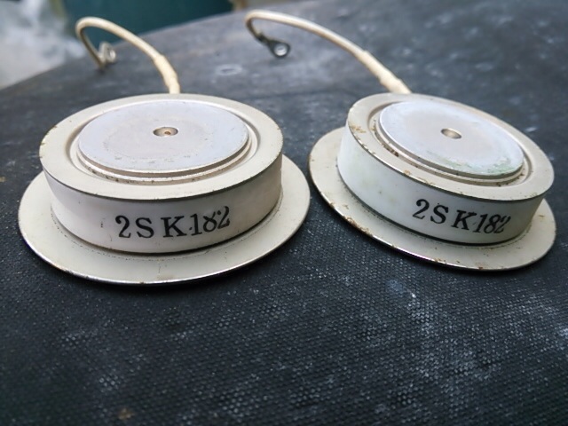

- By the way other Tokin SITs such as the THF-51S or 2SK182ES may be used in place of the 2SK180 in this amplifier.

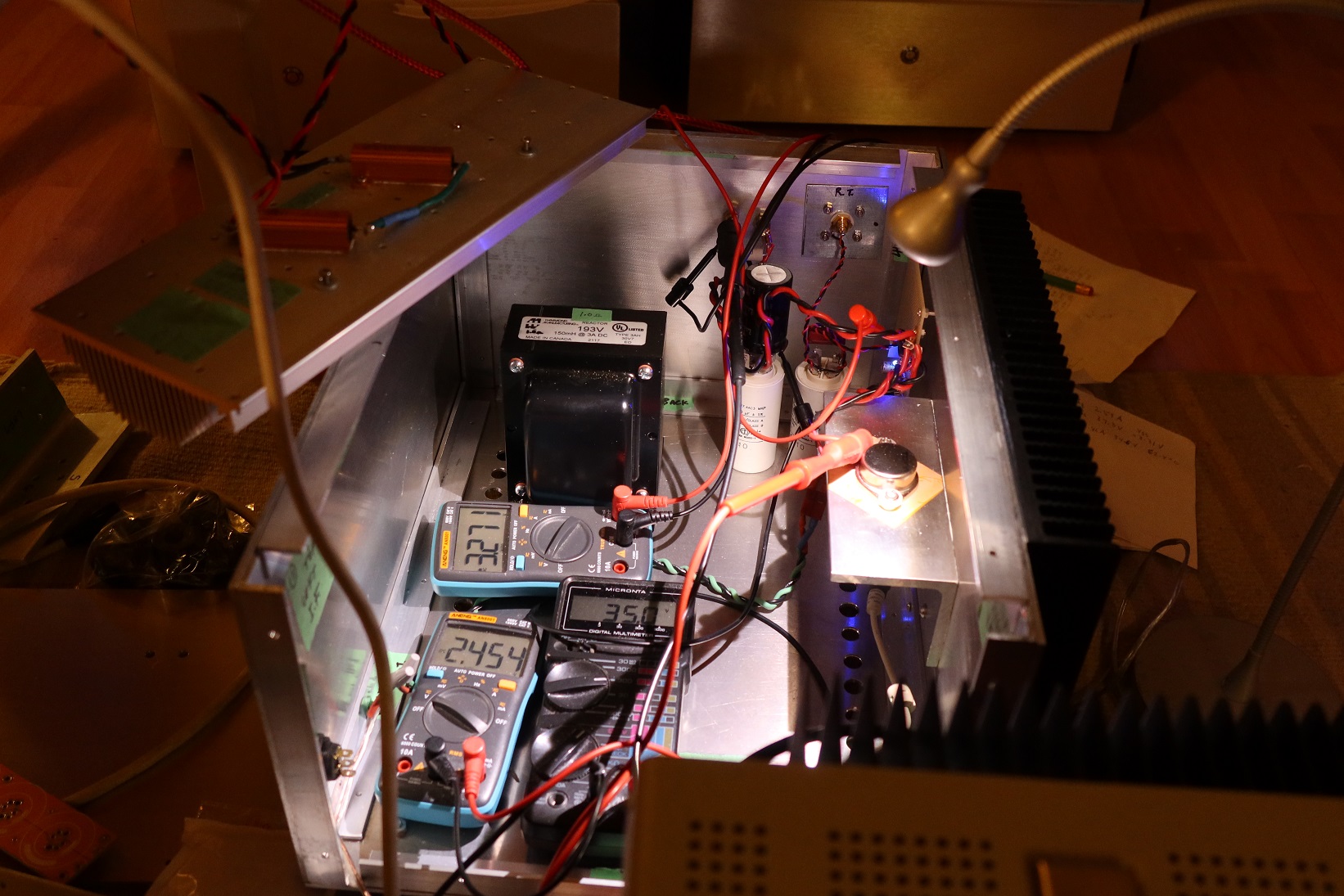

Testing

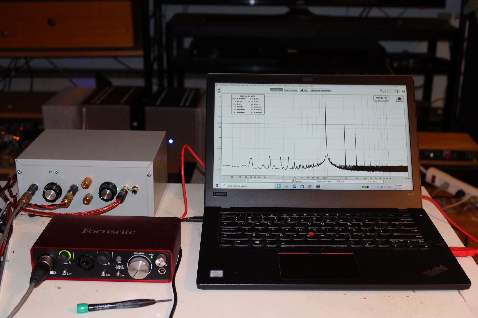

After putting together the bias supply and amplifier circuit, I powered it up with a lab supply, and did some FFT runs at various operating points.
For those of you who are not familiar with how easy it is to do distortion measurements:
Howto - Distortion Measurements with REW
My equipment:

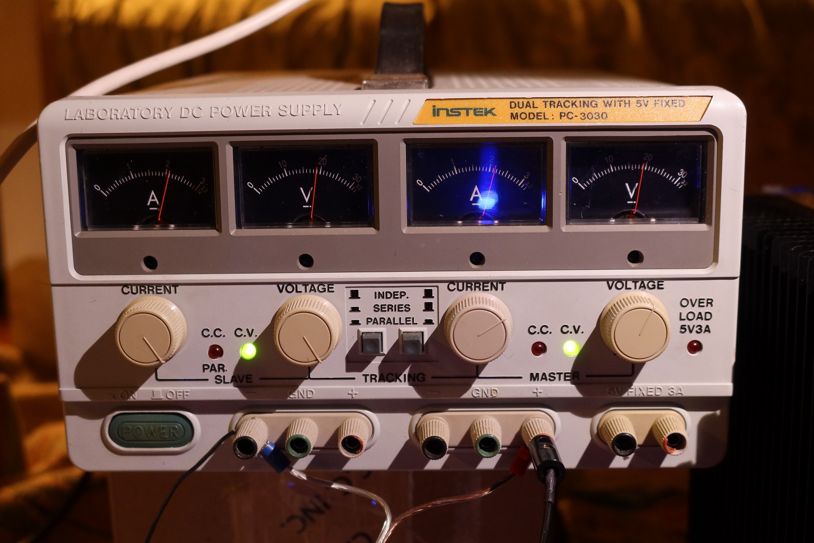

-Instek PC-3030 linear power supply, well used, that I recently purchased on ebay, for V+
-old 19V computer power supply for bias V-
-Focusrite Scarlett 2i2 Gen 2
-REW software
-diy voltage divider/attenuator https://www.akitika.com/documents/BuildingTheAttenuatorRev4.pdf
-Victor 1kHz oscillator (diyAudio member vicnic)
-8 Ohm amplifier load (2-4 Ohm resistors on heatsink)
The 2SK180 is a 300W device. I tried to keep the maximum dissipation to about 90W to hopefully allow the devices have a long life.
The operating points that I investigated:
V+ (V) Vds (V) Iq (A)
37.5 34.7 2.8
37.5 35.0 2.5
40.0 37.7 2.3
40.0 37.9 2.1
37.5 35.5 2.0
42.5 40.2 2.3
31.25 28.25 3.0
35.0 32.3 2.7
The V+ were chosen based on available Antek tranformer voltages, assuming a final rectified and filtered supply voltage equal to 1.25 x (transformer secondary VAC).

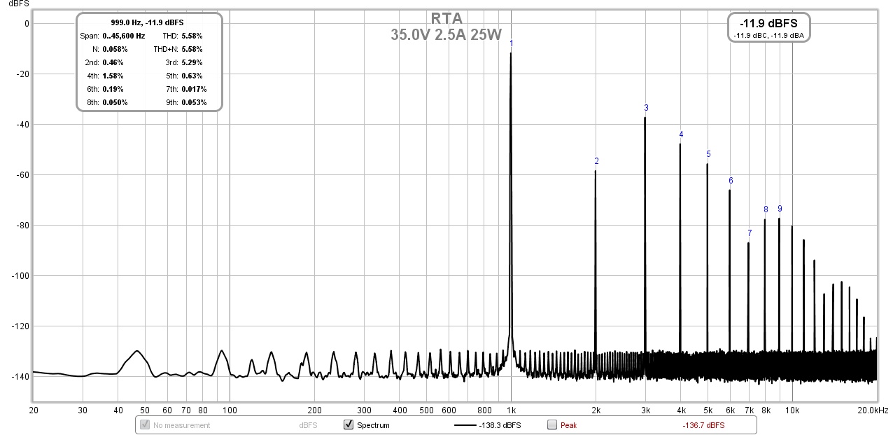

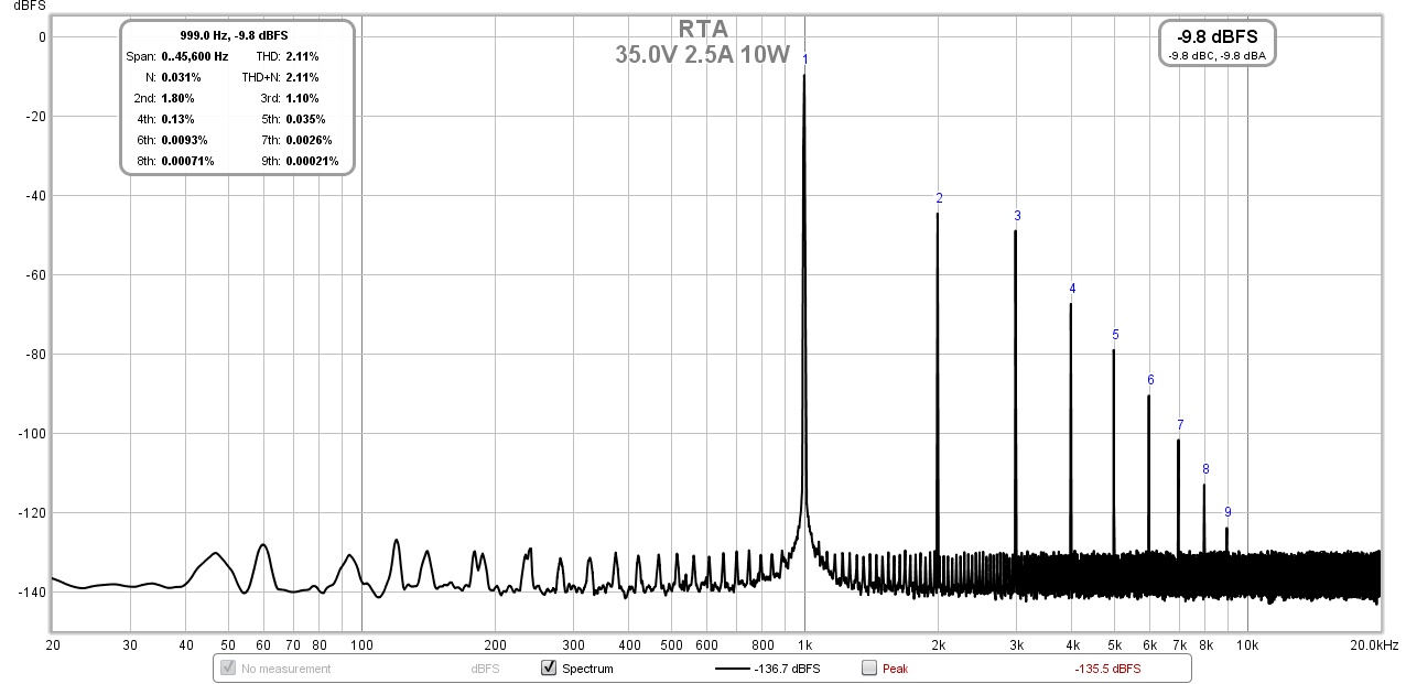

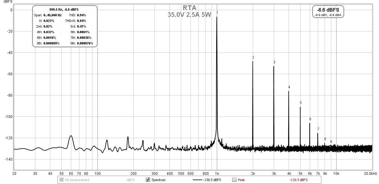

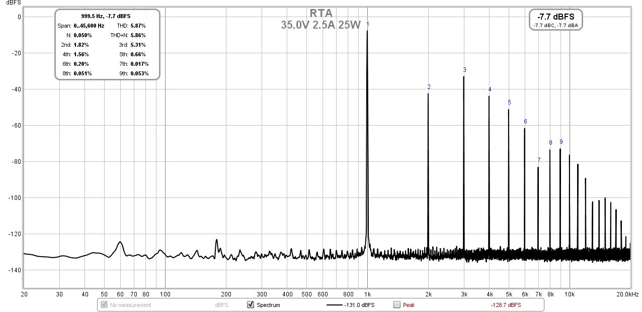

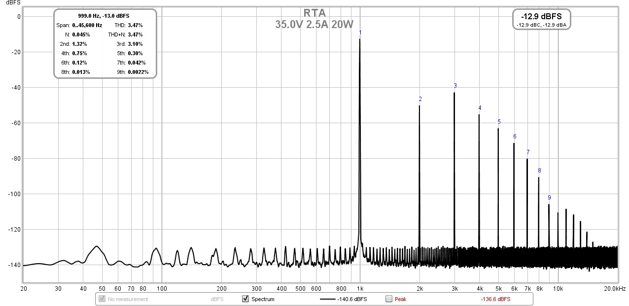

My goal was H2 dominant at lower power output, less than 1% THD at 1W (preferably much less than 1%), 5% THD maximum at 25W.
When I was researching the 2SK180 for purchase, I had read that "C" and "D" graded devices were most likely to have tightly grouped Vgs and curves. So when I purchased my untested "D" grades, I asked the seller for two devices with serial numbers that were close together. I ended up with serial numbers 130103 and 130110.
I built and tested the right channel first. V+=37.5V Vds=35.0v Iq=2.5A had the best results. I then built the left channel and tested it. The results were similar to the right channel, although not exactly the same. At the chosen operating point the left channel serial #130103 Vgs=-3.51V and the right channel serial #130110 Vgs=-3.23V. The FFT results for the right channel are shown below.
So with the operating point decided, two Antek AS-3430 (30VAC 300VA) tranformers have been ordered. I have been waiting for nearly two weeks now. USPS is slow. Power supply parts ordered from Mouser and were received two days later, shipped by UPS.
I also listened for three days with the right channel in my system, with the BAF2015 THF-51S in the left channel. I don't think I noticed much difference if any with the 2SK180 channel in place. That is a good thing. It may have even sounded a bit better. However I will not be able to listen to both channels together until I have the power supplies built. But I think this will be a very good or great sounding amplifier.
To be continued.

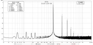

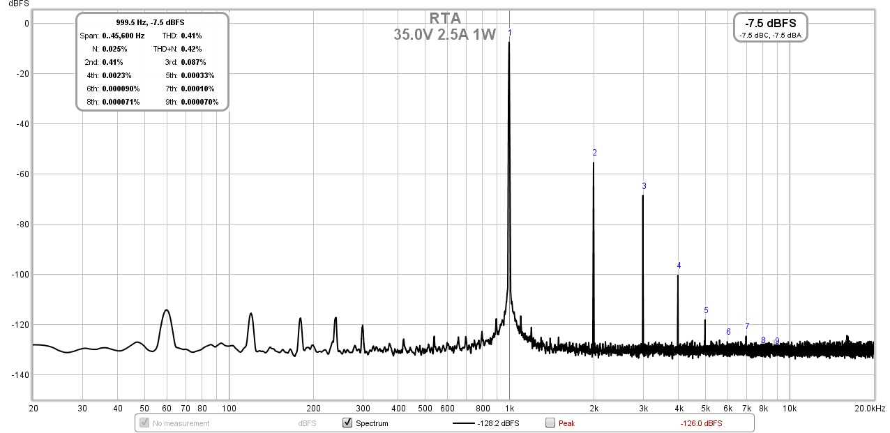

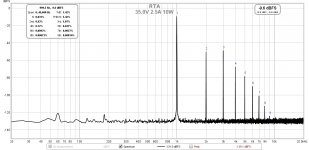

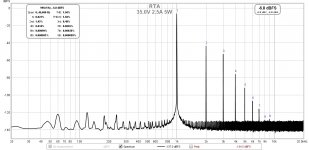

Joined 2012

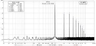

Right channel FFT results:

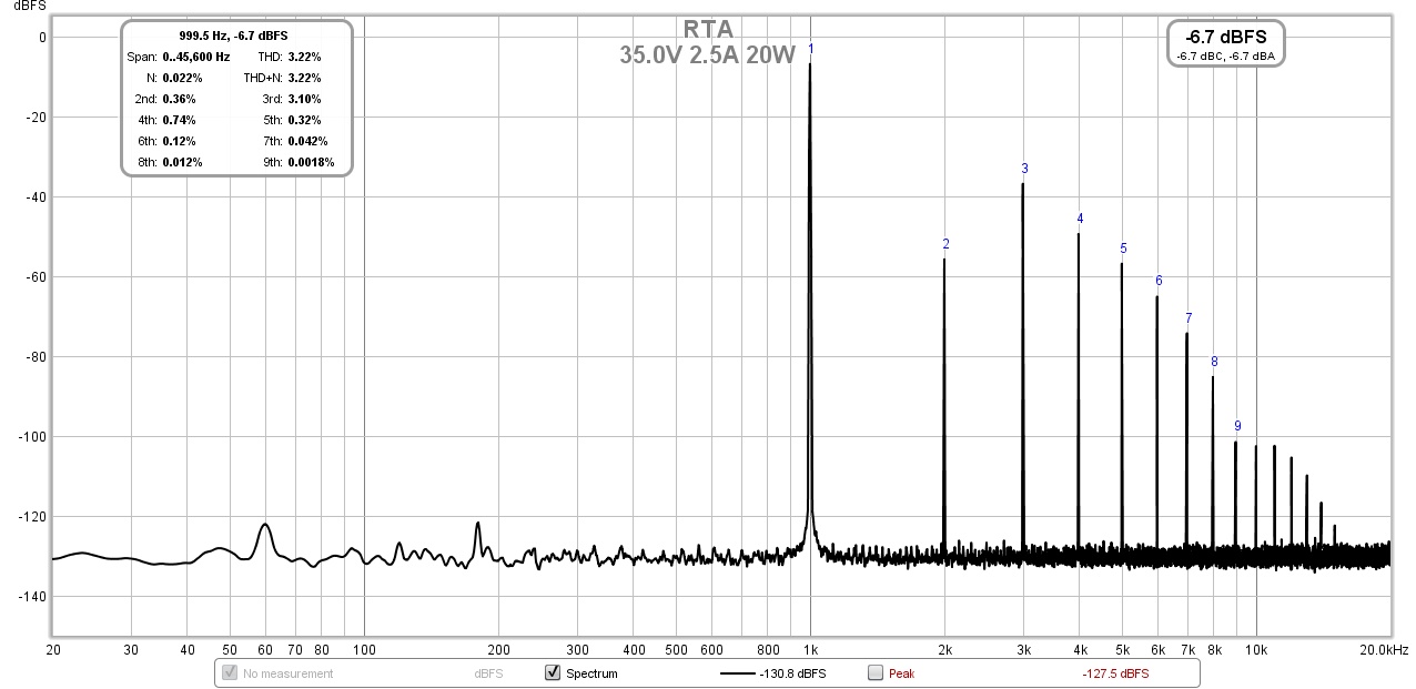

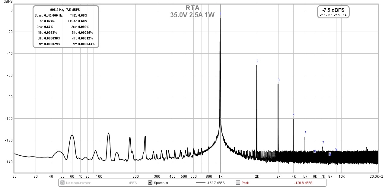

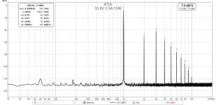

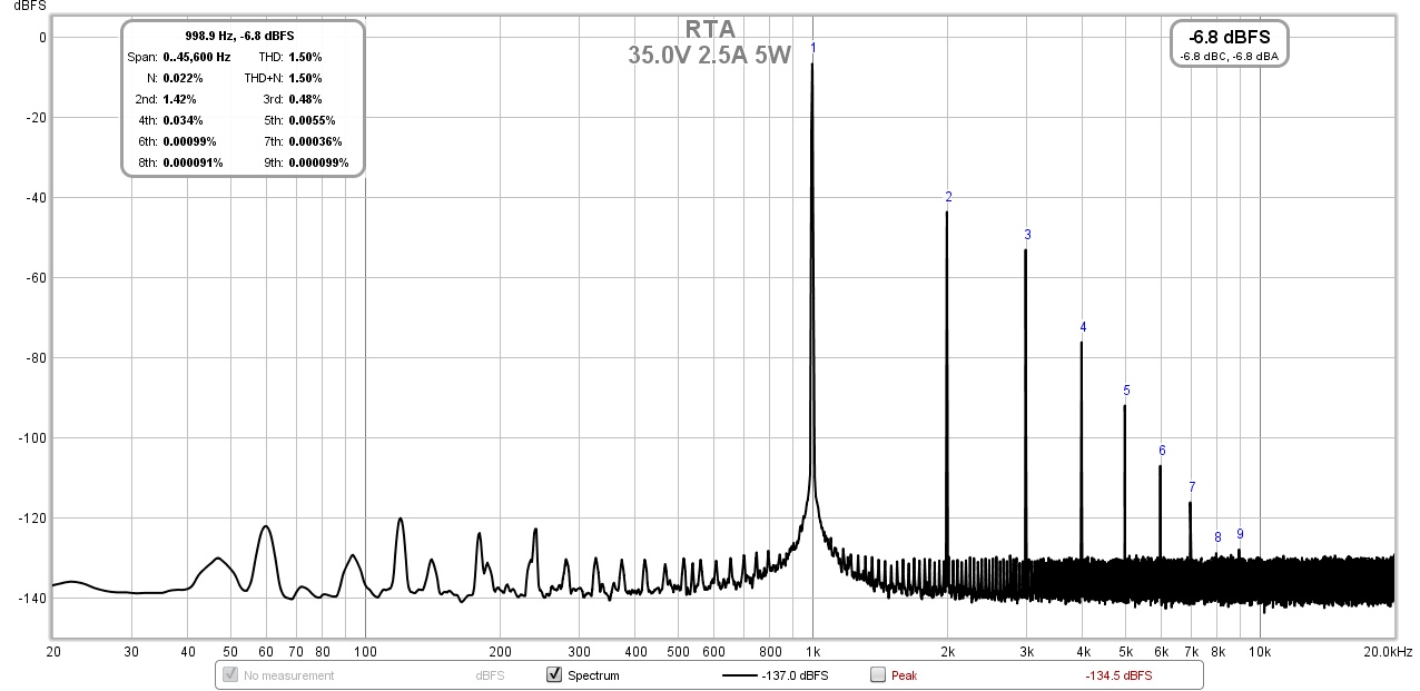

Joined 2012
Left channel:
I think listening is very important to optimize amp-speaker-room interaction. Perhaps it is a good idea to try bias at 2.1A & 2.3A. In this topology different bias would yield different THD and H2/H3 ratio. :)

Despite the left channel not measuring quite as good as the right channel with respect to the amount of H2, I have no complaints. The H2 is still dominant at lower power output, and most of the time the amplifier does not leave that level of power.
