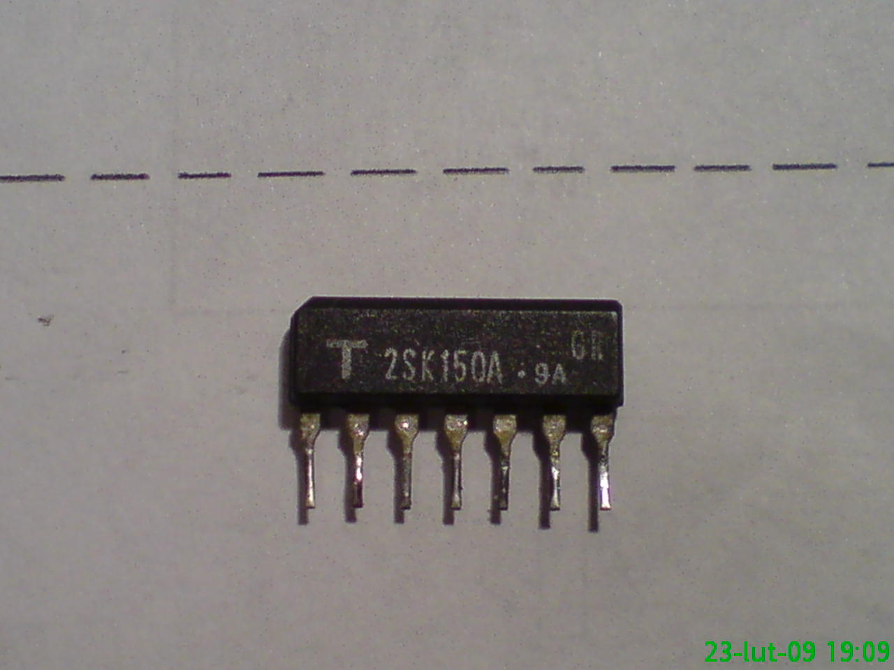

Hello guys I have an old Toshiba SC-665 and I want service I want to replace all 2SK150A "two of them", what equivalent can I use to replace them? :D
Regards
vargasmongo3435
2sk109
I have used 2n3819 as a direct replacement for the 2sk109. use 2 and they will work. they are N-channel JFET type. the basing for the transistor (from front) is D,G,S. the IC pin out is 1=D, 2=G and 3=S and then pin 7=D, 6=G and 5=S for the other side. pin 4 has no connection.
