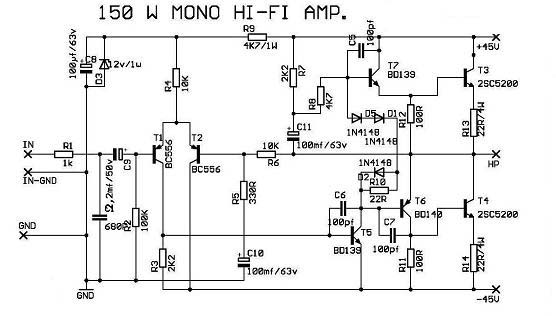

But you MUST use a temperature compensated Vbias to keep the output bias correct for all operating temperatures.
Just noticed the claim for Pmax=150W.
A single pair output stage using 150W devices should give a reliable 70W to 80W into 8ohms if you keep the amp cool.

Hi Reji,how can i set the Vbais?
wow it is 150W is identical to OCL150W that so many building here in my country.
I guess it is 150W stereo anyway (75+75).
To set V bias you must change 3 diode strings with VBE multiplier you can see what AndrewT want you to compare, don't you?
From the OCL 150W that very popular here there is no VBE multiplier,
only 3 diode 1N4148 + one 100 ohm resistor just like your schematic.
And that OCL 150 very easy to built with standard parts & no need to set anything it is work quite fine 😉, so many built it include me 🙂
First time I build it using 2N3055+MJ2955 (fake one) & smoke everywhere, so be aware of your parts selection.
A lot - too many compromises there
. It seems aimed at lowest parts count which doesn't make sense when that also means compromised performance and taking needless hits to the safe and low distortion working limits. If that is driven at full output into 4 ohms, it will not only sound mediocre but have a short life. A bias scheme like that, without specific details for construction is going to be disaster for control with a Quasi-comp. design.
OTOH, using the smaller transformer for ~40V power rails would probably save it from an early binning. For the cost of 2 or three more cheap transistors and maybe 5 resistors, you could have a great, stable amplifier that really kicks at good, safe power. Visit The Avondale Audio site for a schematic and details of what a Quasi of this size can really do.....😉

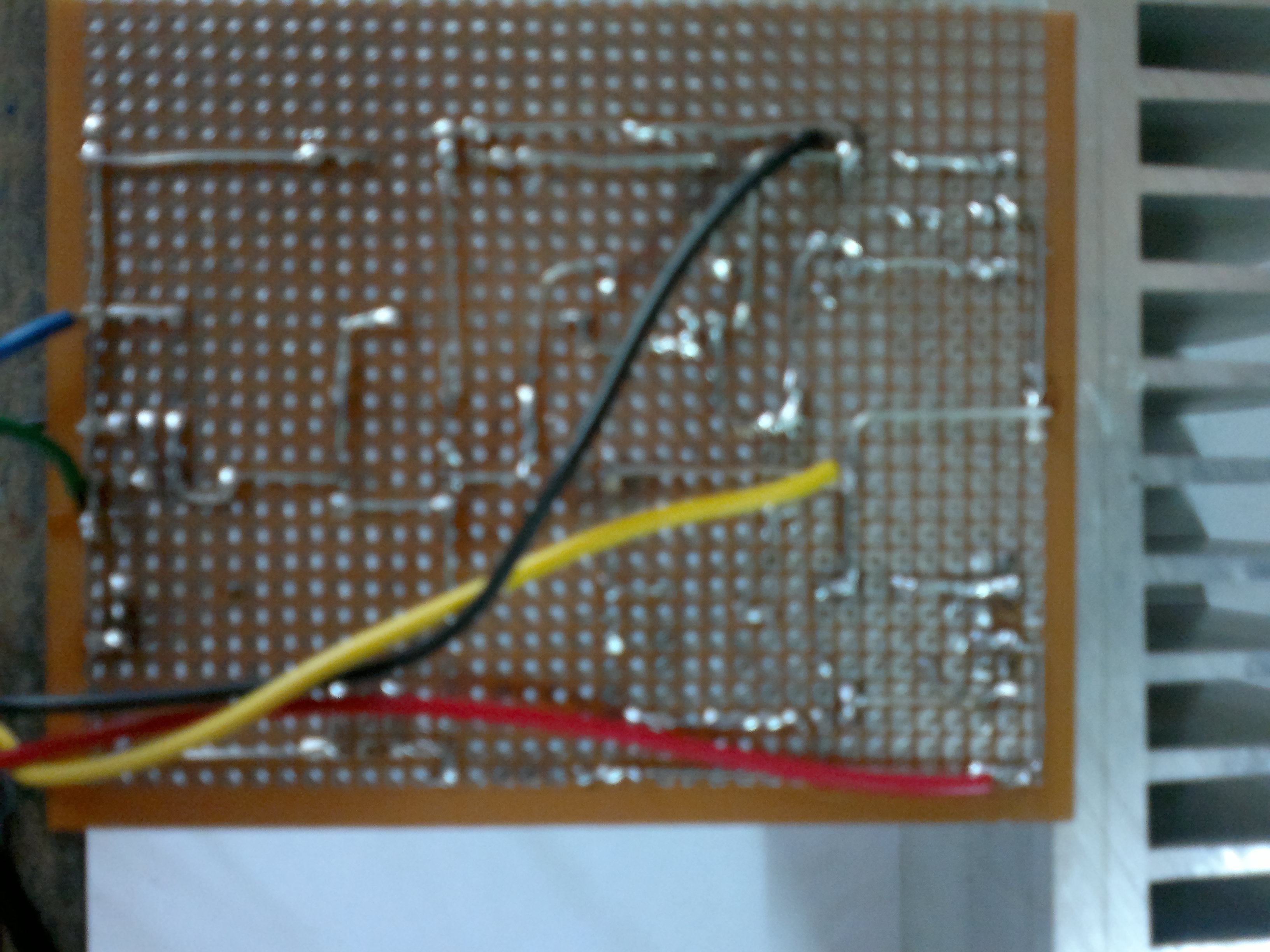

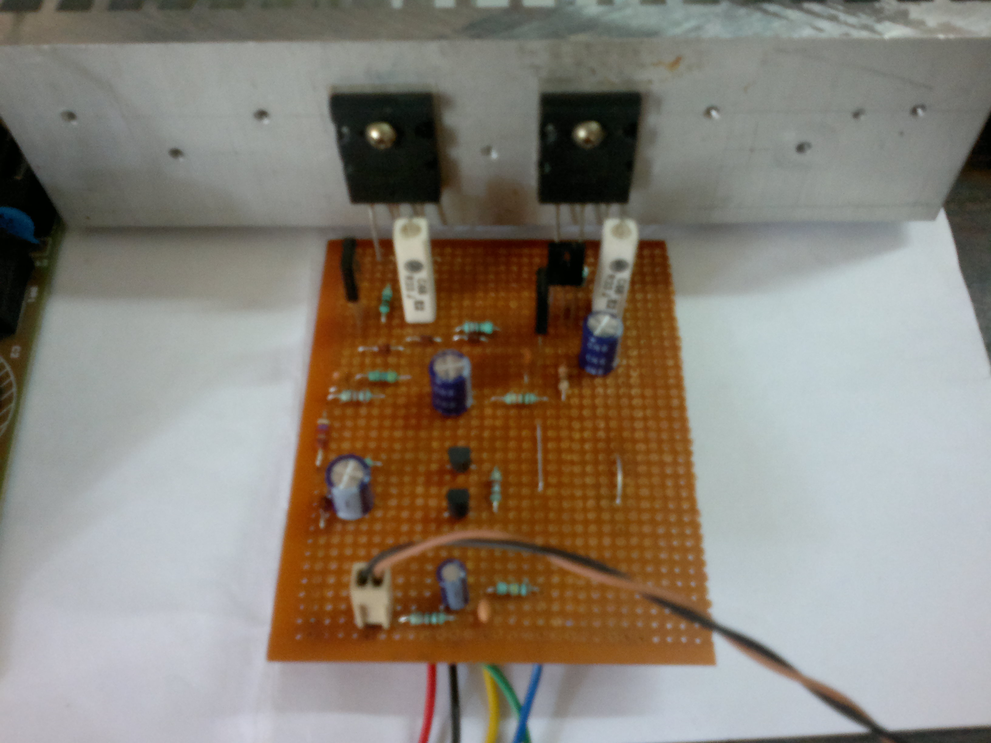

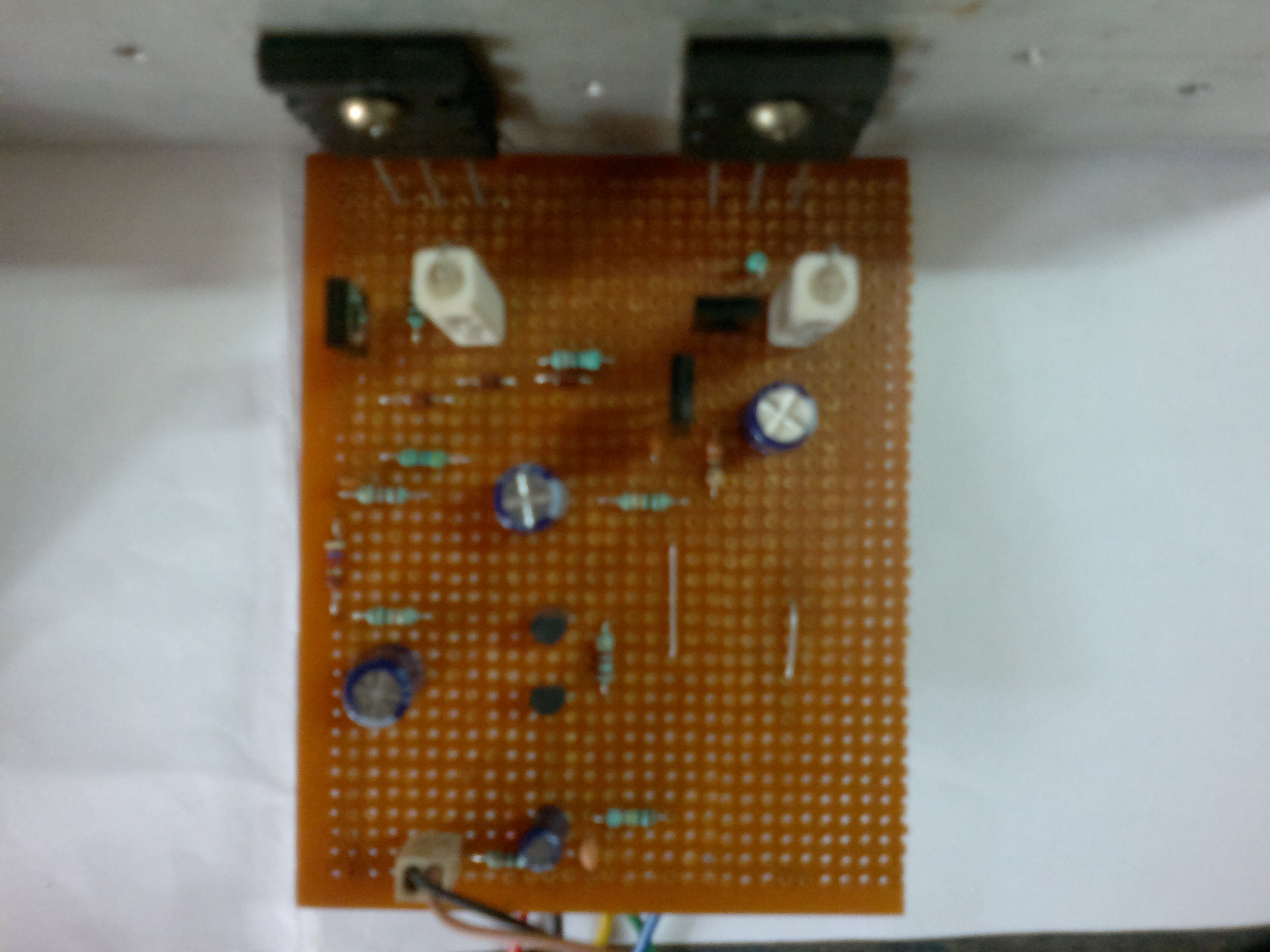

i built this yesterday and i connected power (DC 35+/-), speakers, ipod and start to play music but sound is distorted and T5, T7 gettin hot. output transistors are warm. 😕😕😕

It's difficulty to see smoke in transistor amp. blown fuse first.

Hi andrewlebon!MAX DC SUPPLY 35 O 35 DC
transformer 24 0 24 ac max
A display schematic😉

This amplifier is based on the Digi125 designed by Graeme Dicker and published in the Australian version of ETI magazine as project ETI1430. There are changes to the choice of some components, most notably the transistors and the 5W resistors. The capacitor across the power rails has been omitted so a well filtered supply would benefit.
I have built a number of the original version and the results are surprisingly good. Output transistors included 2N3055/2955, MJ802/4501, and MJ15003/MJ15004.
There are also a few threads on this site regarding modifications that can improve the sound, just search for Digi-125 or just Google it. I haven't tried the mods but the author Tomcat was quite impressed with his efforts. From memory the original schematic is in the thread.
