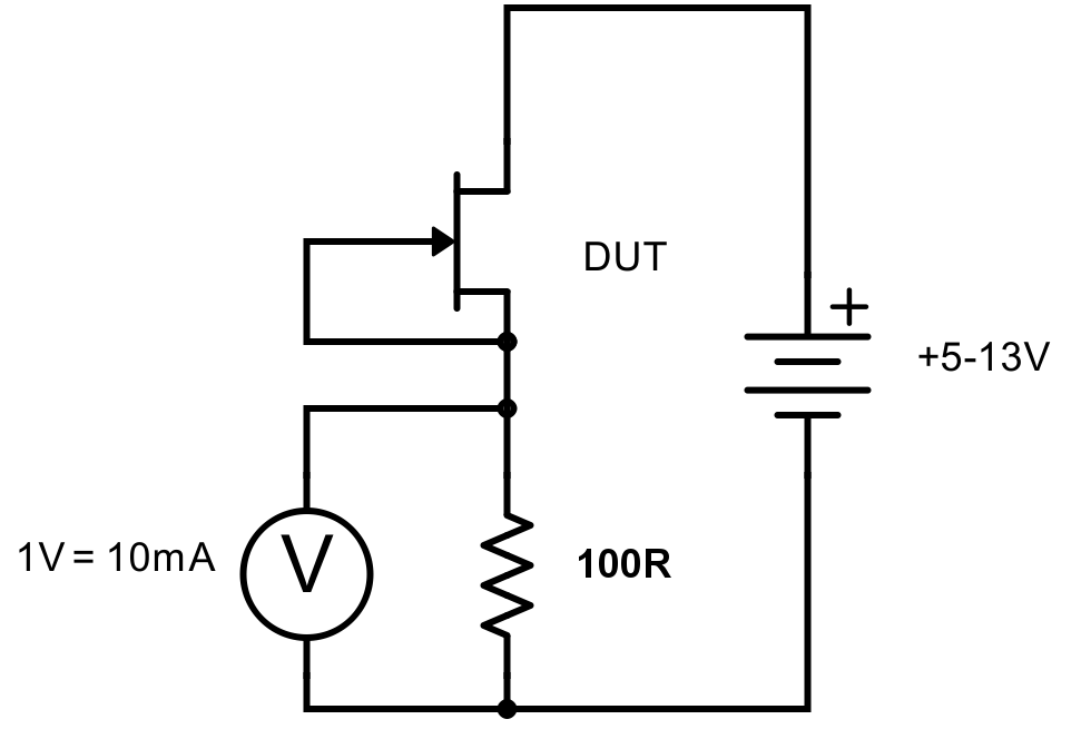

Get a 5 to 13 volt supply and a DC voltmeter. Connect the +V to the
Drain, connect the Gate and Source together to a 100 ohm resistor,
and connect the other lead of the resistor to ground.
Measure the voltage across the resistor, which gives the Idss. 1 volt
= 10 mA of current.

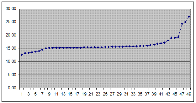

BF862 Matching result
I just bought 50 BF862's (see also the B1 Turbo on a chip thread http://www.diyaudio.com/forums/showthread.php?threadid=140488)
and the result is that at least 30 are very well matchable in pairs and even one almost perfect double quad.
You don't need to buy big numbers to get decent matching.
Rick

Real matching may not be required. But it does not do any harm if you have both channels very close in overall Idss distribution, so do not put all 6mA Idss devices in one channel and the 12 mA devices in the other.

Mr Pass,
I know this is an old thread but would you mind checking the attached circuit to see if this is what you mean in the post regarding checking Idss?
Thanks!

trick question - what is voltage between gate and source , on that picture ?
ZM,
Not a trick question, only following papa's instruction as highlighted above in his message.
circuit is good , but I was (sort of ) replying on vdi_nenna's post .....
ZM,
Thanks for the confirmation. I will go rig this up.
I don't know. 1 volt?
