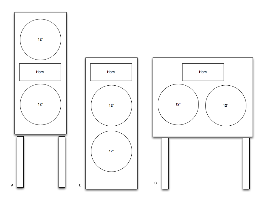

2x12" horn speaker design
I'm trying to design something like mini JBL K2, 2x12" + compression horn type of speaker. I'm wondering which speaker placement is better, WTW or WWT for this type of speaker. Crossover Frequency will be around 1k.

It will be best if your woofer to woofer center-to-center distance is a wavelength or less at crossover (about 13" for 1kHz) for MTM. MTMs can certainly work with greater spacing, but the vertical dispersion lobe can get very narrow at crossover. Here's a nifty calculator so you can play around and see the effects yourself:
Tolvan Data
One way to alleviate the vertical dispersion problem is to use 3rd order Butterworth filters. The 90 degree relationship between the woofers and the tweeter helps the situation. The calculator will let you try that out, too.

I'm quite surprised that the conventional woofer-compression horn design, such as Altec A7, the vertical directionality should be consistent only +-10 degree at crossover.
Since I'm not familiar with 18bB crossover, now I'm wondering what kind of "audible character" of 18dB filter compare to conventional 12dB horn design. No difference if the ears are within in-phase position?
Since I'm not familiar with 18bB crossover, now I'm wondering what kind of "audible character" of 18dB filter compare to conventional 12dB horn design. No difference if the ears are within in phase position?
Some Altec crossovers were 18dB/oct on the horn, and 12dB/oct on the woofer to achieve phase alignment in a particular application. The question of crossover audibility vs. order is a rather contentious subject in general. Opinions vary, all the way from those who insist on first-order networks, to people like Siegfried Linkwitz who have done testing that suggests that a 4th order Linkwitz-Riley crossover is inaudible. So, YMMV, and all that. For myself, I've had good experience with an LR4 (24dB/oct) crossover between a woofer and horn. I suspect the real "secret" of good crossover design is a lack of frequency response ripples in the crossover region and phase coherency between drivers.

Yes; and successfully integrating a horn with a woofer is one of the more complicated tasks, because of the driver offset (among other things). A DSP crossover can make the job easier because the necessary delay can be dialed in, instead of using the relative phase of the low and high pass networks to achieve phase alignment.

The minimum horn size makes it difficult to smoothly cross over from a double woofer to a horn.
A WHW has the woofers too far apart and HWW has a directivity anomaly too.
The old DMS-1 monitors used WHW layout and problems are visible in the DI curves.
They have dropped the idea in the new, presumably improved, M2 monitor.
Horn above side by side woofers will need a low cross over frequency and bulky horn.
JBL themselves seem to have found 2 woofers problematic and dropped them for the latter version K2, the s9900.
You would be better with one woofer and a true sub-woofer if you can fit it.

with this configuration and 2 x 12" and let's sau a E-JMLC 600 horn it should be possible the have the correct c to c distance.
Yes, this is a better way to do a double woofer. But to match the horizontal directivity of the double wide woofers means the cross-over frequency needs to be lower and the horn becomes wider and bulkier too.
Ok for an "ultimate" $42,000 system like the Everest but a smaller system I think it is not the best way to allocate the limited space, or the money.
I really wrestled with these possibilities in my own JBL system before I went one woofer + subwoof and still feel it is the optimum choice.

No disrespect to the DMS-1, lovely drivers, the horizontal pattern is excellent and the horns themselves are fine, I even have a couple.
But if you look at the beam width curve there is a fairly bad kink in the vertical directivity at 600Hz to 1kHz.
This is due to the separation of the 2 woofers plus horn that makes it too directional just below crossover, then the horn is too vertically small to maintain directivity at crossover and just above..
This is the problem with the WHW layout and it is more or less inherent.
Any attempt to increase the horn size to control the pattern just spreads the woofers further apart so it doesn't help.
Their discussion of directivity is excellent but they just skip this bit.😉
I am a little surprised they choose this layout when they were obviously aware of the problem. Hence the layout of the new, improved M2.
