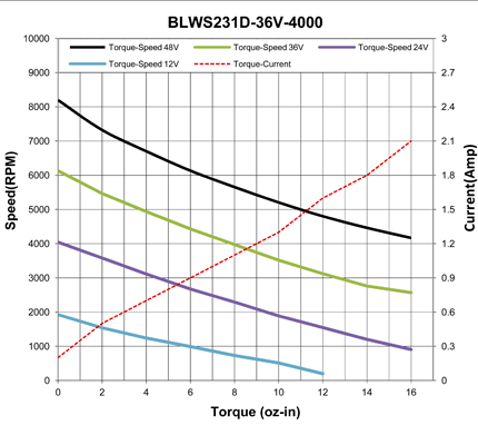

I like the Anaheim Automation motors. I use this one: https://anaheimautomation.com/blws232d-12v-500.html
It is only 4pole. But very smooth under operation.

Hi jayme, this is very promising. It is specified for low rpm also. The 12V curve goes really low.
To order from US is expensive, it would land 2x the website cost, but this shows that a suitable motor actually exists. I'm looking for a NEMA23 BLDC now from Europe. Worst case I can order from US.

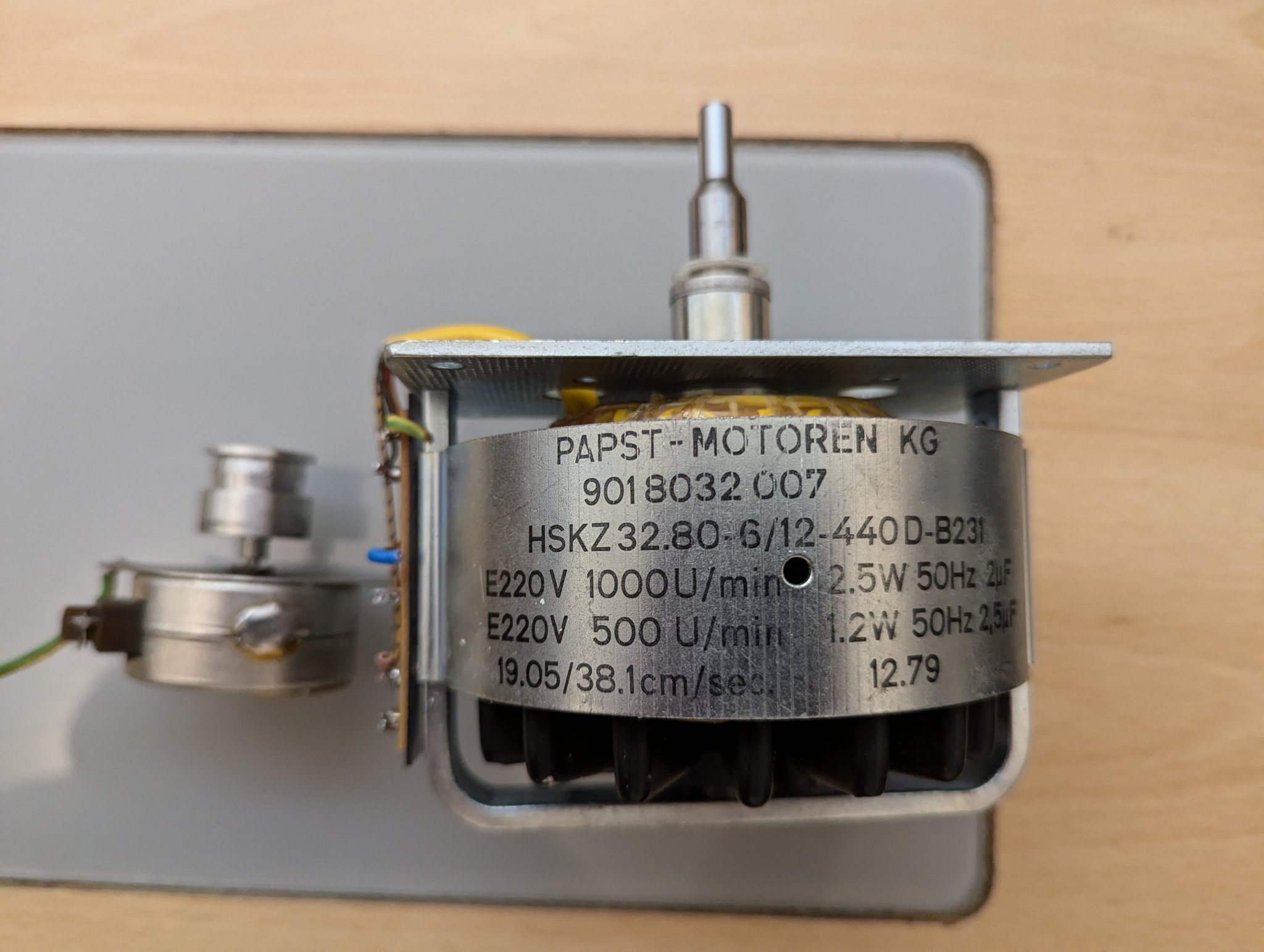

That's why I'm so in favour of the Papst Aussenlaufer; zero cogging, can be found with as many as 12 poles running as low as 500 rpm, but only available on the 2nd hand market and getting rather old.
Best would be to get the same Papst what is (are) in the Voyd, I was looking a lot, but could not find. I was told they do not manufacture any more. Do you have a concrete type to search for?That's why I'm so in favour of the Papst Aussenlaufer; zero cogging, can be found with as many as 12 poles running as low as 500 rpm, but only available on the 2nd hand market and getting rather old.

I am lucky enough to have one of the Papst motors that's used as the basis of that in the Techdas Airforce Zero, though without the air bearing or flywheel.

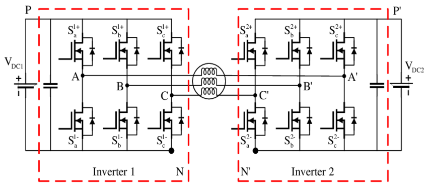

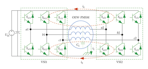

That's an open-end winding motor, but it has a large common-mode current flowing (labelled io in the picture below) directly across all 3 windings unless the inverter outputs are sinusoidal / LC filtered and sum exactly to zero.Another issue is that you need 'single ended' amplifiers in order to drive the motor....What I have done before is to find the 'common' point inside the motor and separate the wires and bringing out the additional connections, so that each phase winding is 'on its own'...
This is because the 3-phase motor has no back-emf for CM voltages and therefore the only impedance seen by the inverter is the leakage inductance. However, if two separate DC sources are used i.e. one for each side, the CM current cannot flow (as there's no path) and the motor maybe driven without LC filters directly from the PWM, also shown below.

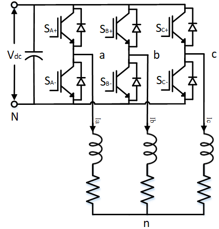

The solution for a non-zero CM voltage in a single-ended inverter is much much easier than that:Actually no, 3 phases are sufficient, the sum of the phases at any moment in time is equal to zero so theoretically there is no vibration. In practice imperfections in design or construction can allow for some vibration but this can be minimised by 'tweaking' the relative phase angle.
1) Connect the motor in the star configuration.
2) Remove the neutral connection through which the zero sequence current flows i.e. leave it open as shown below.
