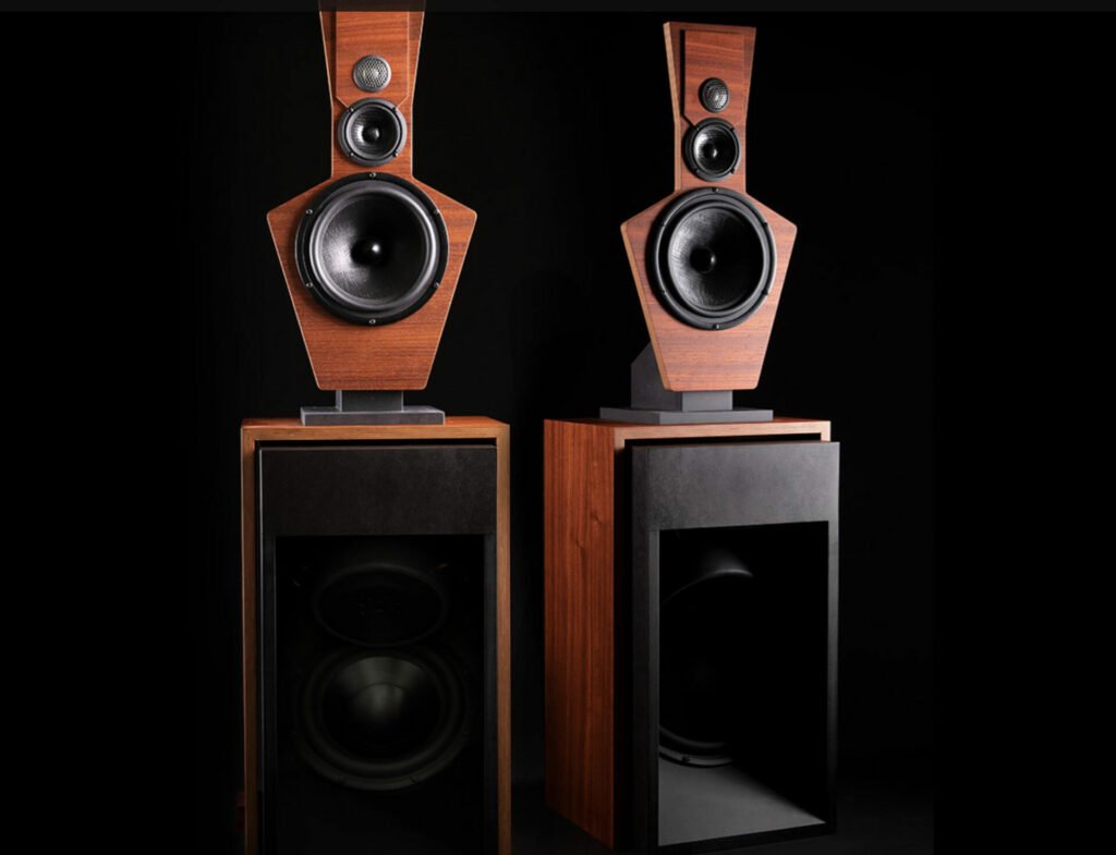

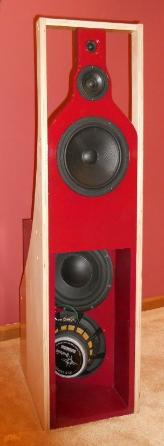

Why ?Best 3way is 4way 🙂
Do you see a 4 way like a 3+sub ? Or more like bass + lower mid + upper mid + tweet (and so will also 'need' a sub ? )
Why? Isn't it obvious?
Every speaker is a set of compromises.
Single fullrange is terrible compromise. Select big one with bass, you get no highs, beaming and breakups. Select small one with decent mids and highs, but you get no lows, or with terrible distortion. Such is physical reality. No need to get offended. Moderators!
2way is still terrible compromise, while some may be satisfactory. Select big woofer, and you get poor mids with early breakups. And you need very powerfull tweeter going very low. You get mismatch in directivity, just look at heat map directivity plots, see all those butterflies, instead of smooth transitions. You can do waw (woofer assisted wideband) but you get all the worts of fullrange.
Even 2way bookshelf is most common speaker in the world, its far from perfect.
In 3way you have compromise to make how big the mid you select. Select big mid, and you have to cross to tweeter low, making things hard for tweeter. Often big dome tweeter with terrible beaming. Did you notice how dome tweeters, even those in high end speakers beam above 10kHz?
Ideal mid for me is 4-5" with minimum breakups, which can be crossed quite high. But 4"mid will not give you midbass slam.
So between proper, say 15", woofer you better intoduce lower midbass. Less compromise than 3way.
So select big woofer, smaller midbass, even smaller mid, and perhaps nice ribbon on top. Smaller the range each speaker covers, more linear it behaves.
When i work on crossover for multiway speakers, i only deal with one at a time. First i measure mid and tweeter separately. Select crossover point to eliminate breakups of mid. Select steepness utilizing natural rollofs. Design as simple as possible for flat response and phase. Ones done with this ccrossover point, it becomes fixed. Then i work on lower midbass and top (mid plus tweeter just finished). So i am only concentrating on one crossover point, essentialy optimizing as 2way. And so on. You can work out 5way crossover without much issues.
Everything is compromise, but if you are happy with one tiny fullrange, or small 2way bookshelf, its ok.
I am only building 4way and up.
Cheers!
