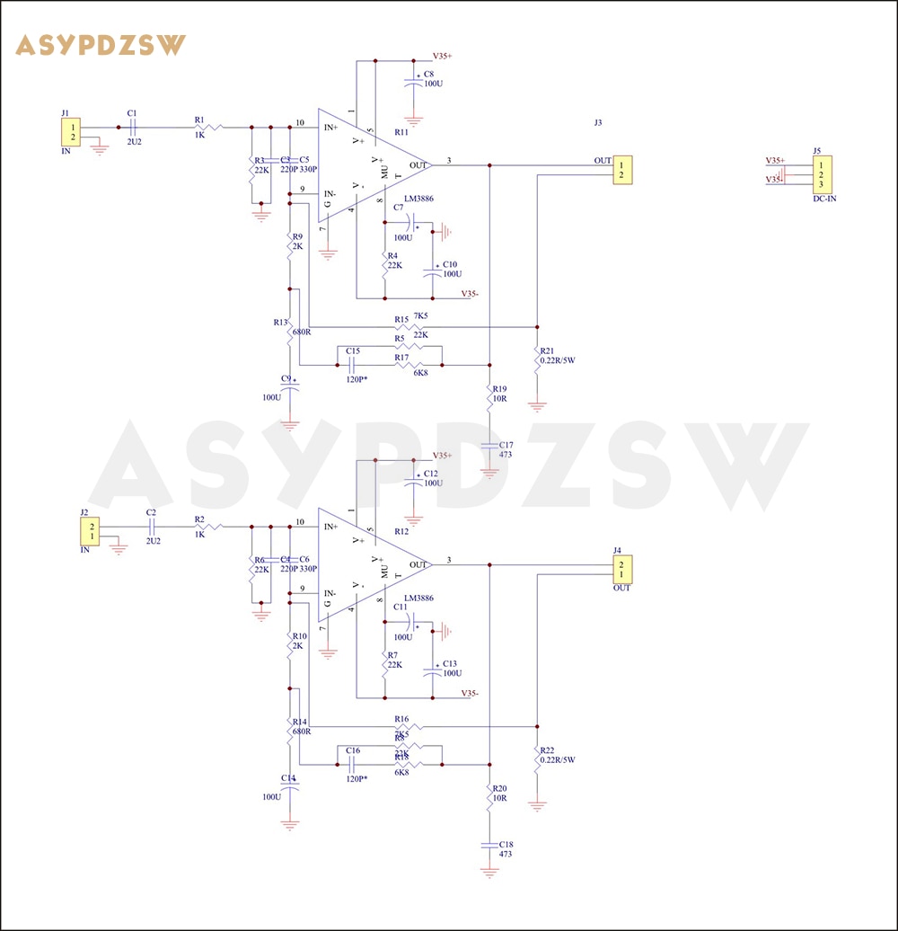

I started with an AB LM3886 50W/8 Ohms amplifier per chip. As I am using two ICs, I will have 100W in total.

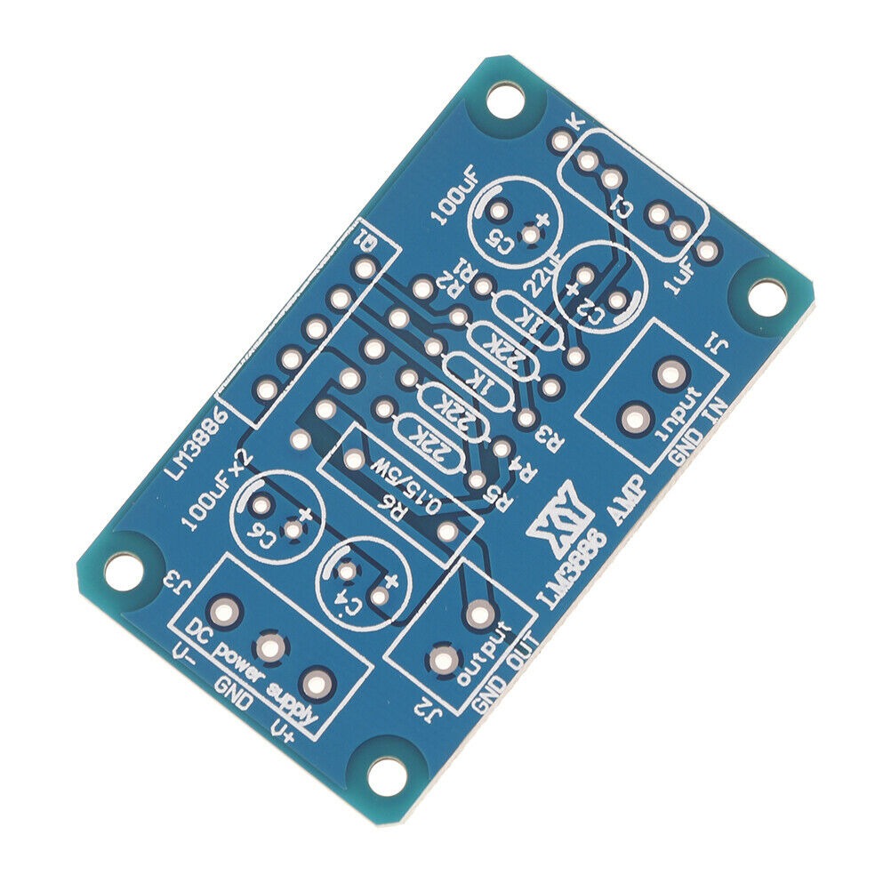

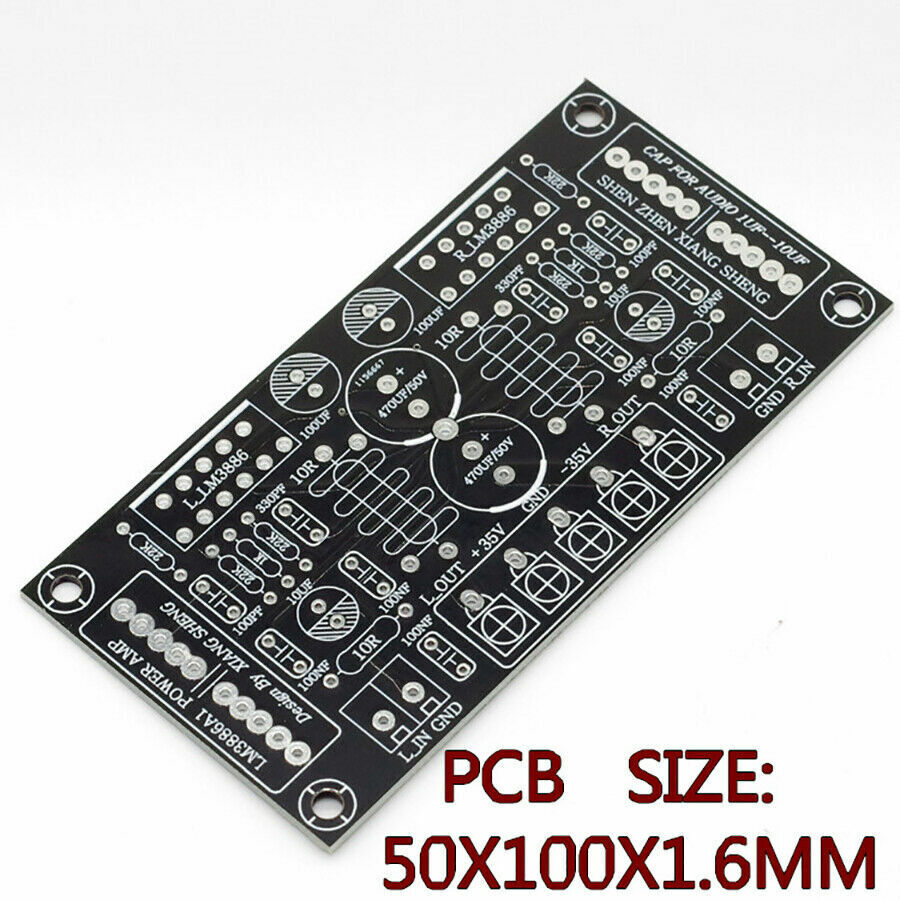

Bro, can I use just one board (same as you linked)? If the output is isolated, maybe it is possible to connect both channel is series to get +24 -24. I know that this is not the correct voltage as required (+28 -28), but I think it will work fine. What do you think?0. I was able to find the manual for that system. You don't have the surround speakers. For some reason the label on your speakers talks about the whole system. Those are the front speakers, and they are 6 ohms. https://www.manualslib.com/manual/3525/Aiwa-Nsx-Av800.html?page=4#manual

You need two of those power supply boards. Each board has a single 24 volt output. The second output is 5 volts, and that isn't useful for the amplifier. So two boards with the 24 volt outputs connected in series does the job. +/- 24 volts is plenty.
Hey Friend, thank you for your help! It worked fine.You need two of those power supply boards. Each board has a single 24 volt output. The second output is 5 volts, and that isn't useful for the amplifier. So two boards with the 24 volt outputs connected in series does the job. +/- 24 volts is plenty.

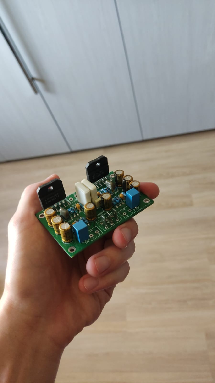

Unfortunately I had a problem with my left LM3886. I'm gonna test it in another board with a good osciloscope to see what's happening.
I made a power supply with my 12+12V transformer (2A), +-18Vdc with 2x 22.000uF capacitors. It is not a good voltage, but it was enough to feel the power of those speakers and amplifier.
Thank you for everything!
I hope you are able to figure it out. You can always post pictures of the PCB front and back on here and maybe someone will be able to spot the problem. The PCB you showed looked good, but I can't tell from that angle if everything is in place. If you have too much trouble, or your PCB gets damaged, there are many different circuit boards available for very low prices. Search for "lm3886 pcb" on eBay as the links to follow won't age well. I have built many of these XY boards and they work well. https://www.ebay.com/itm/295163098487 My son is building up one of these dual amplifier boards today. https://www.ebay.com/itm/224585497340.
I checked the PCB and found nothing. My only device to analyze it is a multimeter. At the afternoons I can use an osciloscope.I hope you are able to figure it out. You can always post pictures of the PCB front and back on here and maybe someone will be able to spot the problem. The PCB you showed looked good, but I can't tell from that angle if everything is in place. If you have too much trouble, or your PCB gets damaged, there are many different circuit boards available for very low prices. Search for "lm3886 pcb" on eBay as the links to follow won't age well. I have built many of these XY boards and they work well. https://www.ebay.com/itm/295163098487 My son is building up one of these dual amplifier boards today. https://www.ebay.com/itm/224585497340. View attachment 1083969View attachment 1083968
I hope I can find the problem too, where I live, the Lm3886 is very expensive nowadays.
