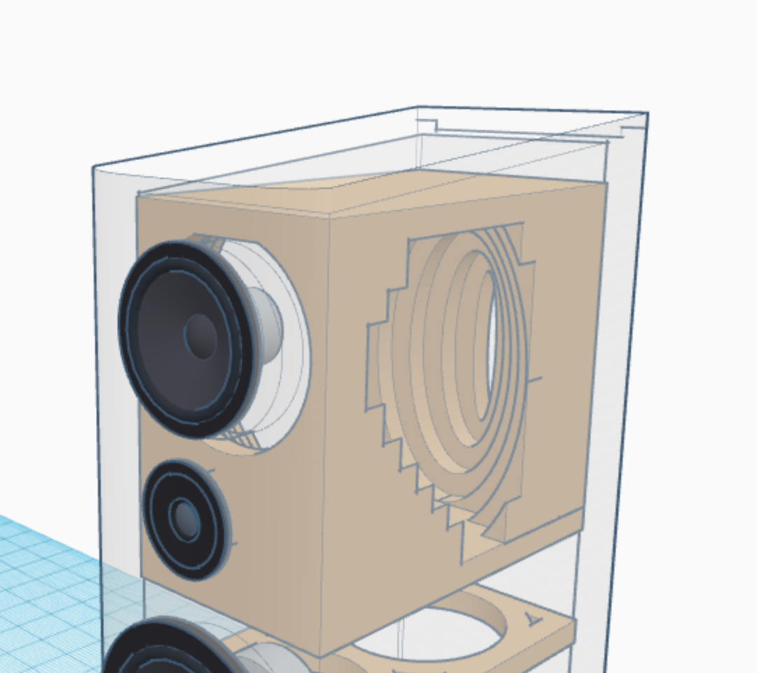

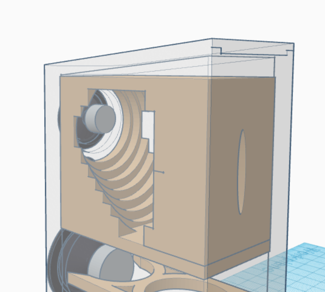

Here's what I did with the midrange chamber:

About the wedges: YES, YES YES YES! GOOD! The shape and acoustic treatment of the midrange chamber is something I pay HUGE attention to. If you have got the basics right, proper shape and acoustic treatment of the midrange chamber is key to great sound!
I think a wedge in the back would also make for a great diffuser. Also I would make a sloped entrance behind the midrange so the back wave gently travels along it's sides into the chamber instead of just falling of a cliff.
Acoustic treatment is important. The shallow angle of the wedges does absolutely noting because the reflection in that angle still returns to the membrane and it only takes absorption depth away from the wadding. To use heavy open pore foam on the back works a lot better than reflecting it in a that low angle. And since the angle doesn't change, it does not become more diffuse either. So the wedges are indeed a bad idea, at least in this enclosure layout.
A different approach would be much more promising, an angled board from the baffle towards the back/top. That would reflect the sound back into the wadding and on top of that it greatly helps against the standing waves in the bass compartment.
So if you're going for the single RS180, and believe me you should, I would make a ~15 L chamber with that wedge in the back with only the wedge and maybe just a bit of the side walls in the back covered with some damping material. Don't use too much. Using to much damping material in the midrange chamber to my experience makes the sound overly bright, lose all it's weight, snap and body/chestyness and it ruins the imaging.
I did not suggest press tight wadding. Your design of the layered boards of the mid-chamber is indeed a very promising approach since it diffuses the sound and the reflections get a lot of different runtime/distance, which scatters the resonances to a lower level over a very wide frequency range. Unfortunately that makes the relatively slim speaker very top heavy which I would strongly recommend to avoid because of obvious practical reasons. It's a good idea though and can be implemented with relatively low effort if no other arguments speak against it.
Also you should drill maybe three or five 5-8 mm holes in the midrange chamber. This way there will be no form of compression in the midrange chambers whatsoever even at high volumes. This way the midrange can breathe completely freely making for a nice airy unrestrained sound. It can also again slightly improve vocals and body to my experience.

Well obviously the RS180 can't go to 3 kHz. It should be crossed at 2 kHz. However the tweeter might not be able to handle that but again, the tweeter should be upgraded. I don't want to be annoying but using that tweeter in combination with all these other great driver is just ridiculous. In case of the RS180, cross it at 2 kHz and its dispersion will blend in just fine with the tweeter. And no it's not that much bigger in Sd, but it is bigger, but that's not the point. The way the midrange sounds is not determined by Sd. The single bigger driver will have weight, body and linearity to it that smaller ones simply won't, no matter how many you have ore how they are implemented. This statement is gonna be very controversial but a smaller number of bigger drivers is preferable over a bigger number of smaller drivers for a give total Sd.
Back to the acoustics of the midrange chamber. Yes, when using the wedge, it has to be much deeper with a much steeper angle, but if my suggestion of the much bigger chamber is being followed that should be possible. And thanks for congratulating my design of the midrange chamber. If OP is willing to implement it in his design and is willing to make the effort of eventually building, I think it's the best one could possibly do with the midrange chamber. It offers a soundstage and imaging that is just unparalleled, seriously. Here in The Hague we have a hifi shop called Chattelin. They are on of the highest-end stores in the Netherlands and have absolute top of the world gear including Wilson Audio, KEF (their high-end models like the Blade), Grimm and their signature brand is Kroma Audio. They've got their entire line in store including their €200k / pair Elektra. Even the best systems I've heard there do not offer the same soundstage and maybe even imaging as my speakers do, and I'm not exaggerating.
The holes in the back, they are not necessary and might not be favorable in every scenario. Just in my case they made it just slightly better. However they don't bleed midrange to the back wall and are not intended to. I've got damping in front of the holes to prevent midrange bleeding out of them. They are not meant to make the speaker a dipole, only to give the midrange chamber a slight bit of ventilation.
But if the intention is to limit the vertical dispersion to prevent floor and ceiling reflections, a MTM will indeed be the right way to go but then I wouldn't use a dome tweeter either. Again, this would narrow the vertical midrange dispersion but then the tweeter will still have perfect dispersion, the dispersion won't match. If I where you, I would use a ribbon or planar tweeter, there's some pretty good ribbon and planar tweeters for relatively little money. OR use two domes in a MTTM configuration.
A ribbon/planar tweeter will have a narrower vertical dispersion which I just understood in intended in this system, and it will match the dispersion pattern of the MTM configuration.
Then if you're going MTM after all, you could use smaller midranges, this way the centers of the drivers won't get to far apart.
I think you should use two dome tweeters in a MTTM configuration. There's ribbon like the Fountek NeoCD1.0 for €51 but these are so small and low quality that they have to be crossed at over 4 or even 5 kHz which unreachable.
I think you'll of very well using two of one of the tweeter I suggested.
Let me do a suggestion for a driver selection:
