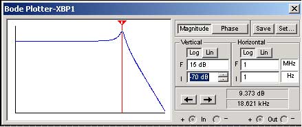

the problem with the circuit you've drawn is that there is a nasty bump in the response -- here's a bode plot --

Jackinnj,
The peak is there on purpose to counteract sin(X)/x rolloff when a nonos dac is used. This results in around -3db at 20kHz, that is why there is a peak there.
Cheers
