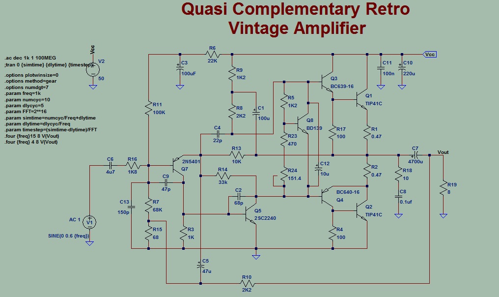

I have built Apex retro in the past but i want to make a low duty amp for my desktop speakersWhy not Apex retro?
The Apex retro (I assume the 50W design) is very retro. Here are some points to start with:
1. 2N3773 output transistors are very slow-worse than the old2N3055 (now H), with ft (min) of 200kHz. Not recommended, but the TIP41/42 are faster epi (3MHz) and OK.
2. The lower output stage can latch up. The key to avoiding this is to limit the current to the stage. One way to do that is to use a PNP VAS, so that the bootstrap resistors are on the low side, not high side.
3. Feedback from the LS is undesirable. ALthough this may have reduced distortion from the output capacitor, it can cause clipping at LF below the normal cut-off frequency. This degrades the signal at high output powers and low frequencies, that it is better to simply use feedback from the output rail and let the output capacitor roll off the frequency response. But at VLF square waves it will give a differentiated signal, though this may not be distinguishable acoustically (a square wave and its differential contain plenty of odd harmonics).
Modern capacitors generally have low impedance (inductance and resistance) and won't cause significant distortion, although sometimes they can (look up capacitor distortion).
4. Miller stabilisation does not help to reduce crossover distortion.
Depends on the 3773. On Semi 3773 and any of the myriad of 2nd source versions (Central, NTE, etc) are 4 MHz. The spec still says 200kHz, but the typical curves show 4 MHz. If you found an old RCA it might be the slower version, but in the 80’s GE/RCA/Harris switched over to epi-base too.
The On Semi 3773 is practically indistinguishable from an MJ15003. Today they are probably the same exact thing, tested to a different spec.
TIP 41 are just fine up to about a 48V supply. (+/- 24 in split rail terms). There is always the 33 or 35 if you want to go above that or run lower impeadances. Always just buy the 100 volt C version. They don’t cost any more.
Try a decent, fast audio transistor for outputs. Quasi-complementary designs can sound a lot better when the crossover switching is cleaner and using a single pair of old slugs for power transistors doesn't help with the sound quality we likely expect to hear now. Perhaps you want that olde worlde sound? Fine, but I'd begin by considering 30MHz 2SC5200 and think upwards from there.
5200’s are available in TO-220 - the Fairchild version is. There is also the MJE15030, which makes a fine low power output device. If you’re really wanting TO-220’s.

there are some points to consider.
Feedback from the output: this was common in the early days, but as your amp is capacitor coupled, this has an adverse effect at low frequencies and high volumes. If you are able to simulate this (there are some freebie simulators around, a lot here use LTspice) you can see the effects. The solution is to use feedback only from the output rail and rely on the capacitor having a low distortion.
Temperature stability: your feedback resistor controlling the DC point consists of a 10k and 33k split. As the VAS (2sc2240) warms up it will reduce Vbe by about 2mV/C, which will be amplified by the ratio of the feedback resistors to the 1k base. So you may see about 14mV/C drift. For a capacitor coupled amp this is not critical, but is is higher than desirable. Solution is also to use a lower feedback resistor directly from the output rail.
Quasi Original as posted

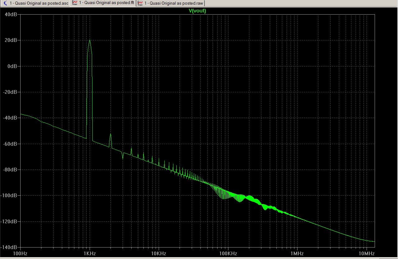

Dear all,
I took the liberty of simulating the original as posted at #1 as an exercise and obtained the following figure. Is it OK?

Dear all,
At #5, john_ellis commented :
" 2. The lower output stage can latch up. The key to avoiding this is to limit the current to the stage. One way to do that is to use a PNP VAS, so that the bootstrap resistors are on the low side, not high side."
How to sim for this effect ? Is using PNP VAS the only solution ?

Emitter resistor in the vas, base stopper on the CFP. Either/or/and. If you were going to add current limit transistors you pretty much have to.
The only way to sim for it is to have accurate models - for the exact transistors you have. Just grabbing any old model because it is on hand may or may not show it, or show a false positive when the real one won’t do it. The whole phenomenon has to do with what happens when the transistors saturate heavily. Sometimes you just get lucky and have no difficulty without trying, and that’s one reason certain transistor combinations got used heavily back in the day when these amps were common.

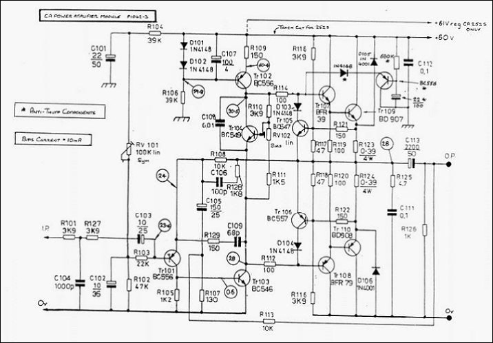

If you really want to go retro why not have a look at some of the old Nytech designs? They worked very well and had some interesting features.
Any suggestions or something to improve?
I usually use an emitter resistor on the VAS with two diodes to clamp the base voltage. Current limit is set to about 2.5x normal, but swapping the input and VAS around for their opposites tends to give the best results.Emitter resistor in the vas, base stopper on the CFP. Either/or/and.
