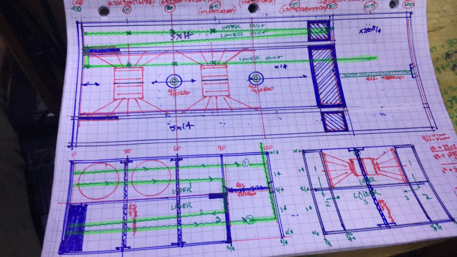

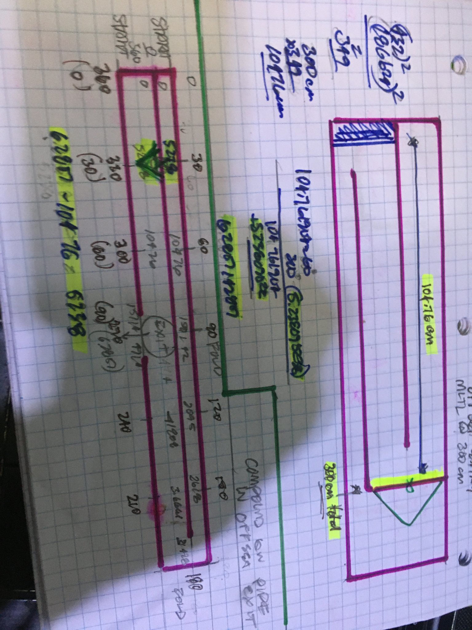

there’s all thread /Jam nuts at the center of the larger resonators in tension or compression and that works really good as soon as you hear any buzzing or anything, a half a turn at most and its gone . But without decent size fender washers that starts to get recessed into the plywood.

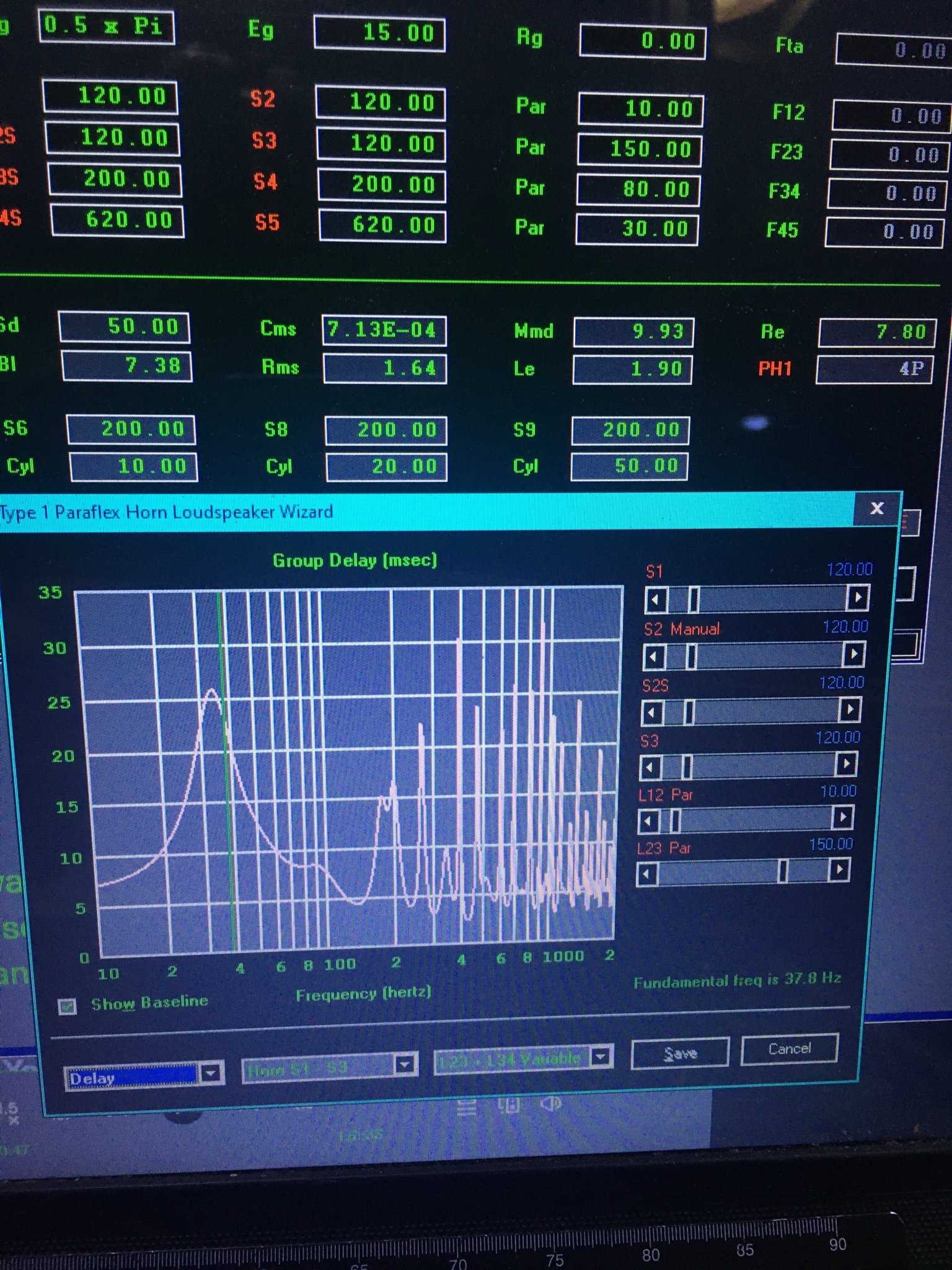

Gasket leak at Pmax in both corners of long side path.
.349 (offset driver entry to TL ) weird number..? 20degrees? .349206349 radians? Pi/9 ? 300x.349 is 104.76? 104.76x3 is 3.1428?This is a great idea . I need the magnets locked together And the pool vents are small, easy to keep breathing

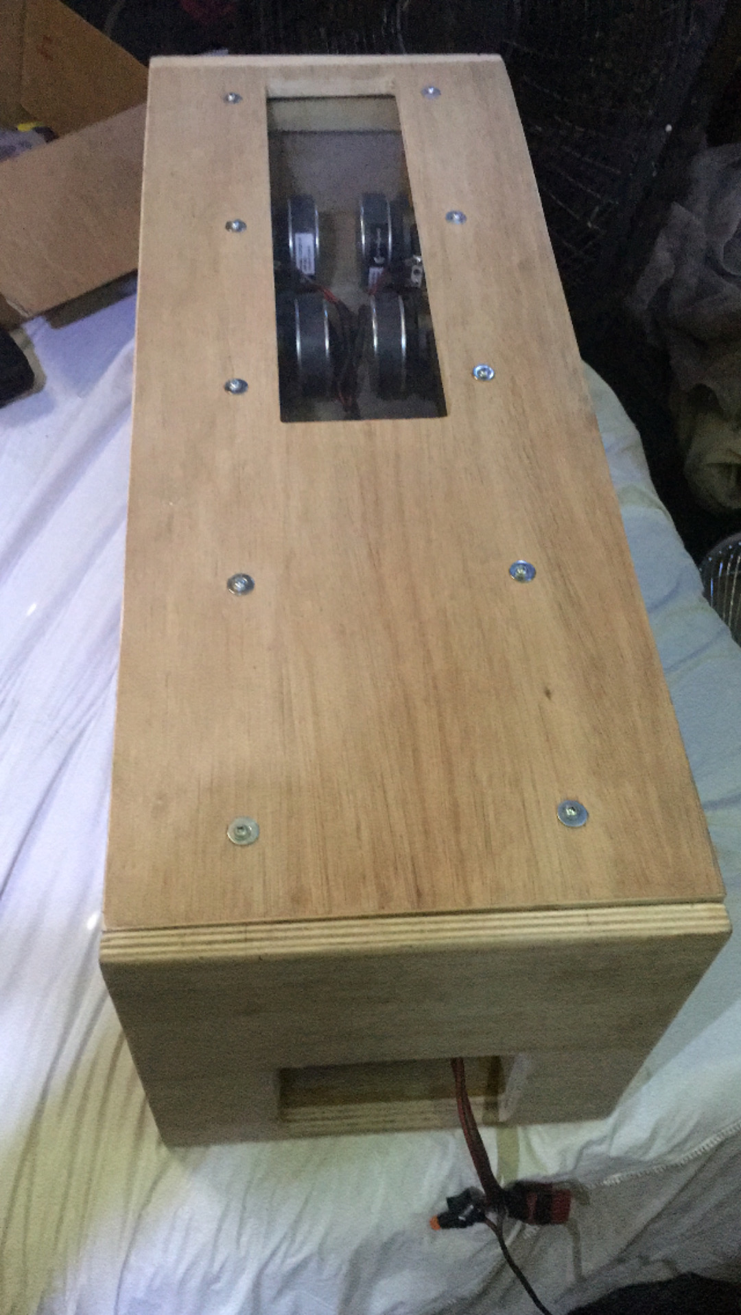

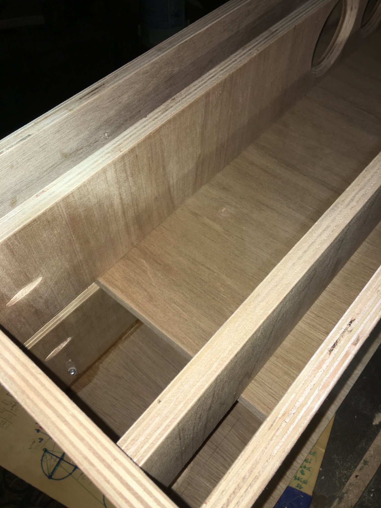

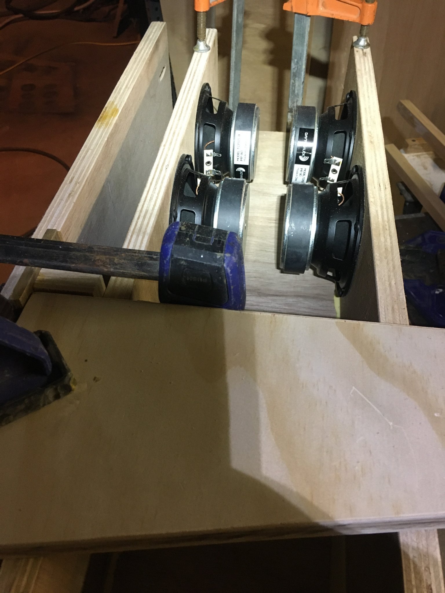

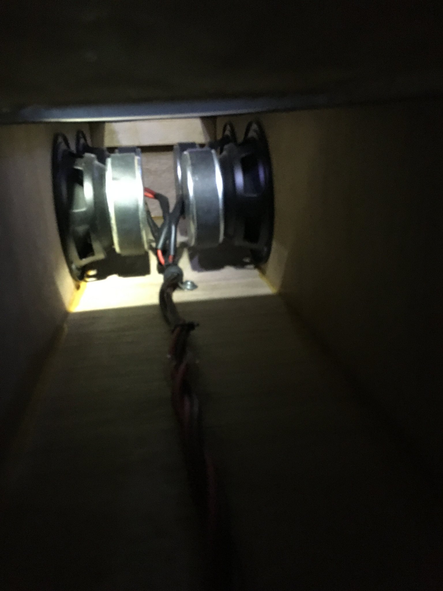

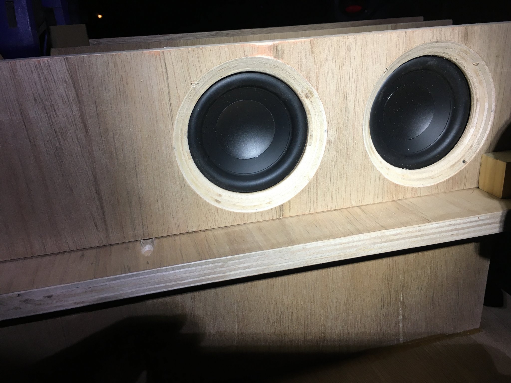

We have 16 more of these little 4” monsters. They need to go two enclosures(4x4” ) to compare against the parallel high order box design?
And suggestions or ideas it doesn’t necessarily need to be as loud. In fact a different delivery of bass or type of the sound woukd probably be the best? A RoaR out of pvc and nested sonotube? Or MLTL version ?

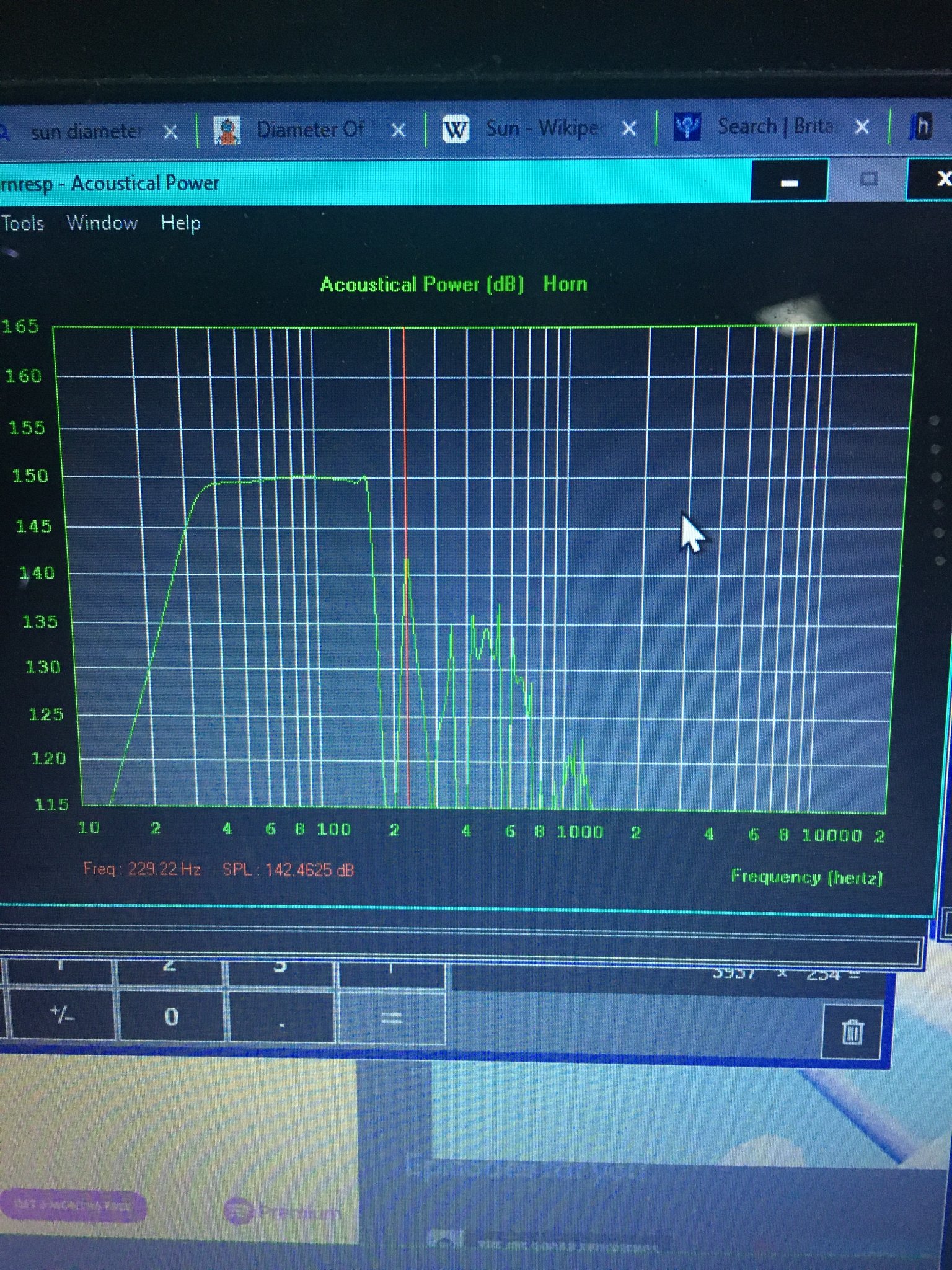

Are these input screen shots from an earlier version of HR? The new one looks nothing like yours, so can't replicate it and rhetorically wonder if you exported it, can I install/run it?😄$14.96/each. Instead of $732 the latest price increase of the B&C 18ds115🥲 I need one more of (back ordered) .

Freq scales but the bigger numbers are still the same when you turn them back down into smaller number just move the decimal.. this sequence of numbers is the extended much further or go back in the opposite direction to see what I’m talking about.
Horn response doesn’t even matter. At this point it’s a much bigger picture A concept that person must be grasp first. This is the big bang in chunks. Of number between it. Numerical reference to everything exist inside of that over and over again.
