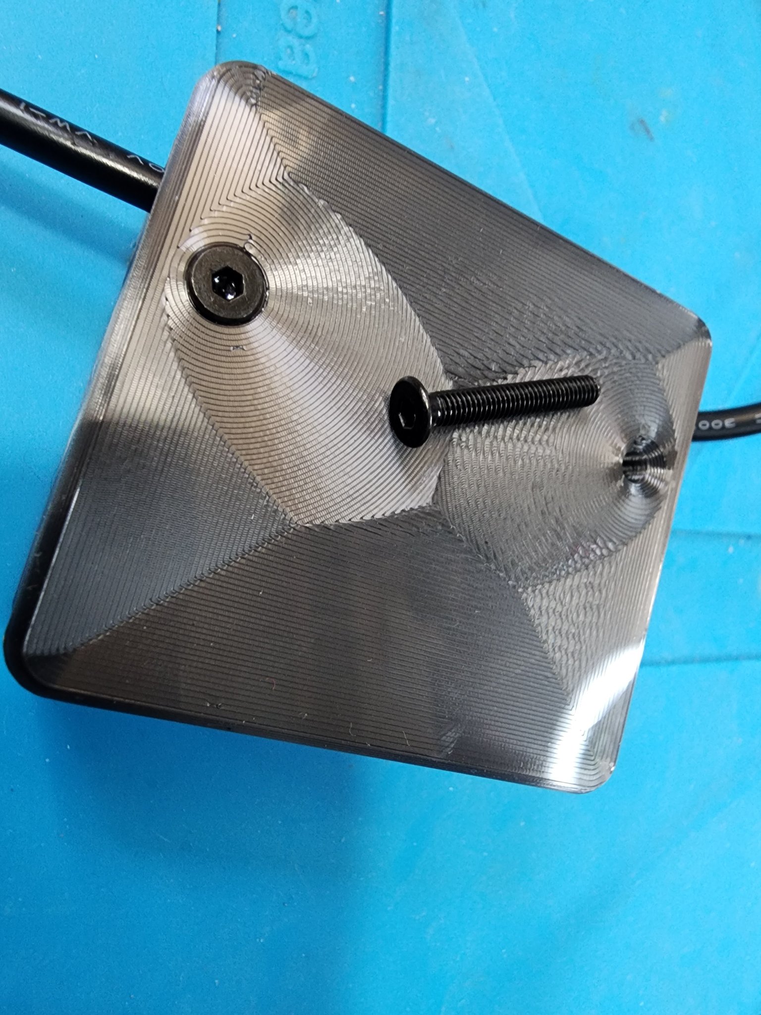

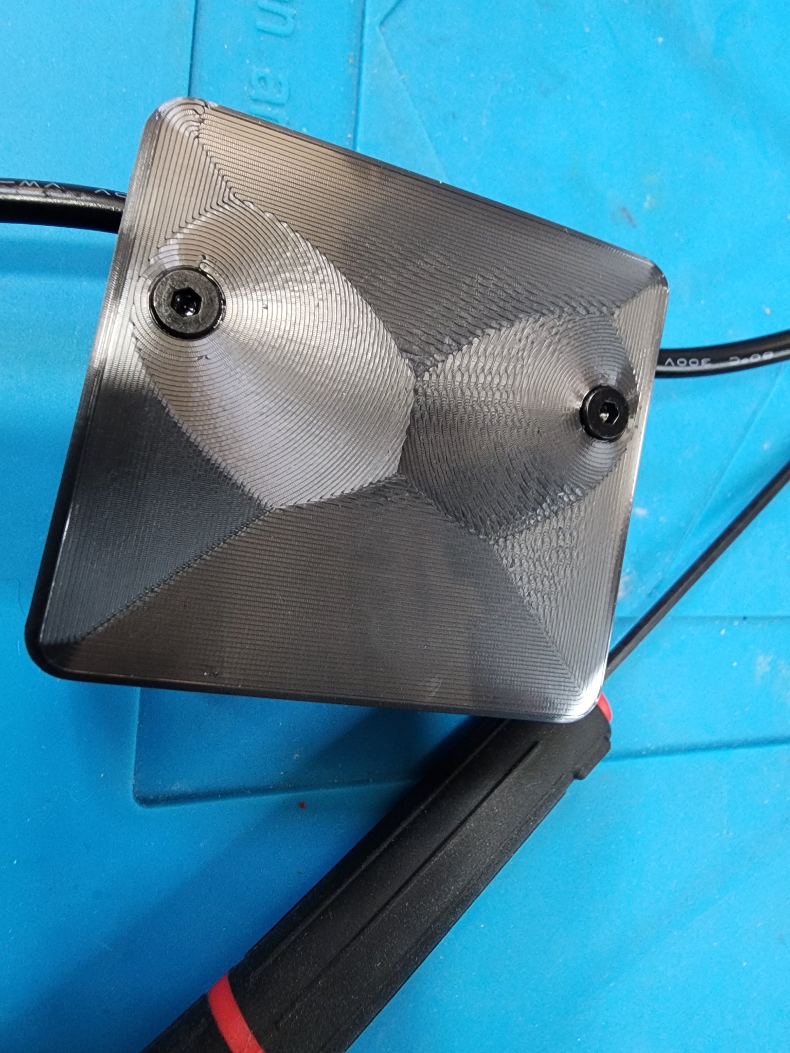

Use two tapered head M3 bolts (16-20mm long) to secure them top plate to the bottom. It's designed to tightly grip the barrel connector cable (little grip ribs are hard to see) so no stress is put on the solder joints.

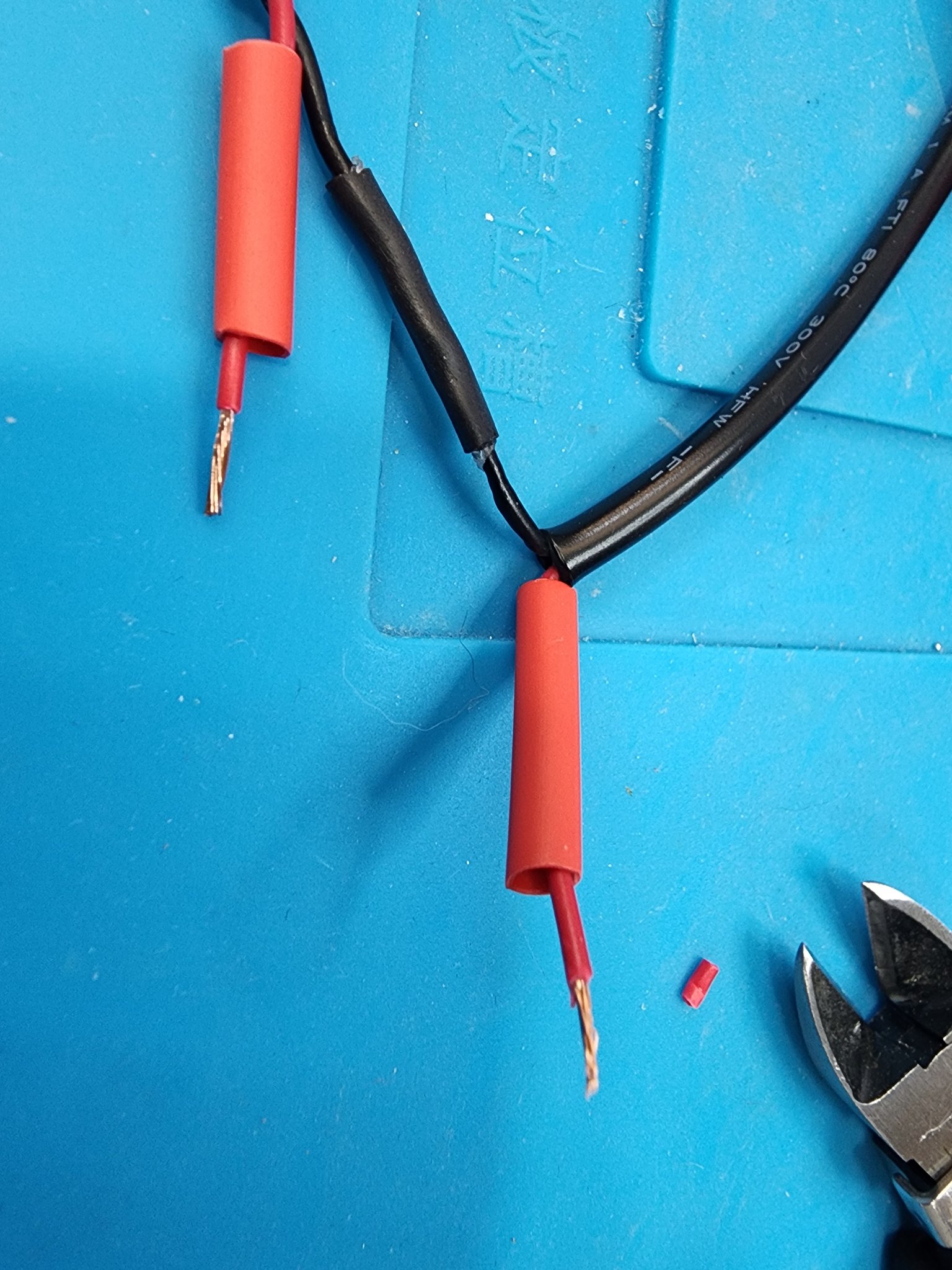

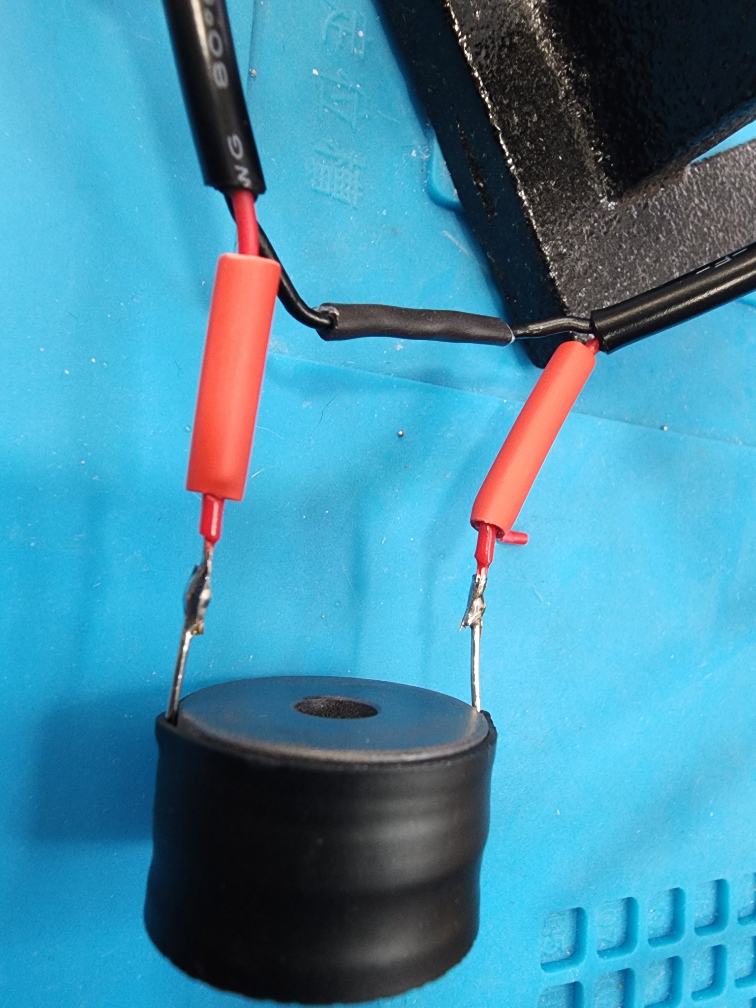

If you purchase a 1 meter 5.5x2.5mm barrel dc plug extension cable like this one, all you do is simply access the positive DC wire inside, snip it, and put the coil in series. Clamp the wires tightly with the top plate and you can add/removed the coil easily for A/B listening comparisons.

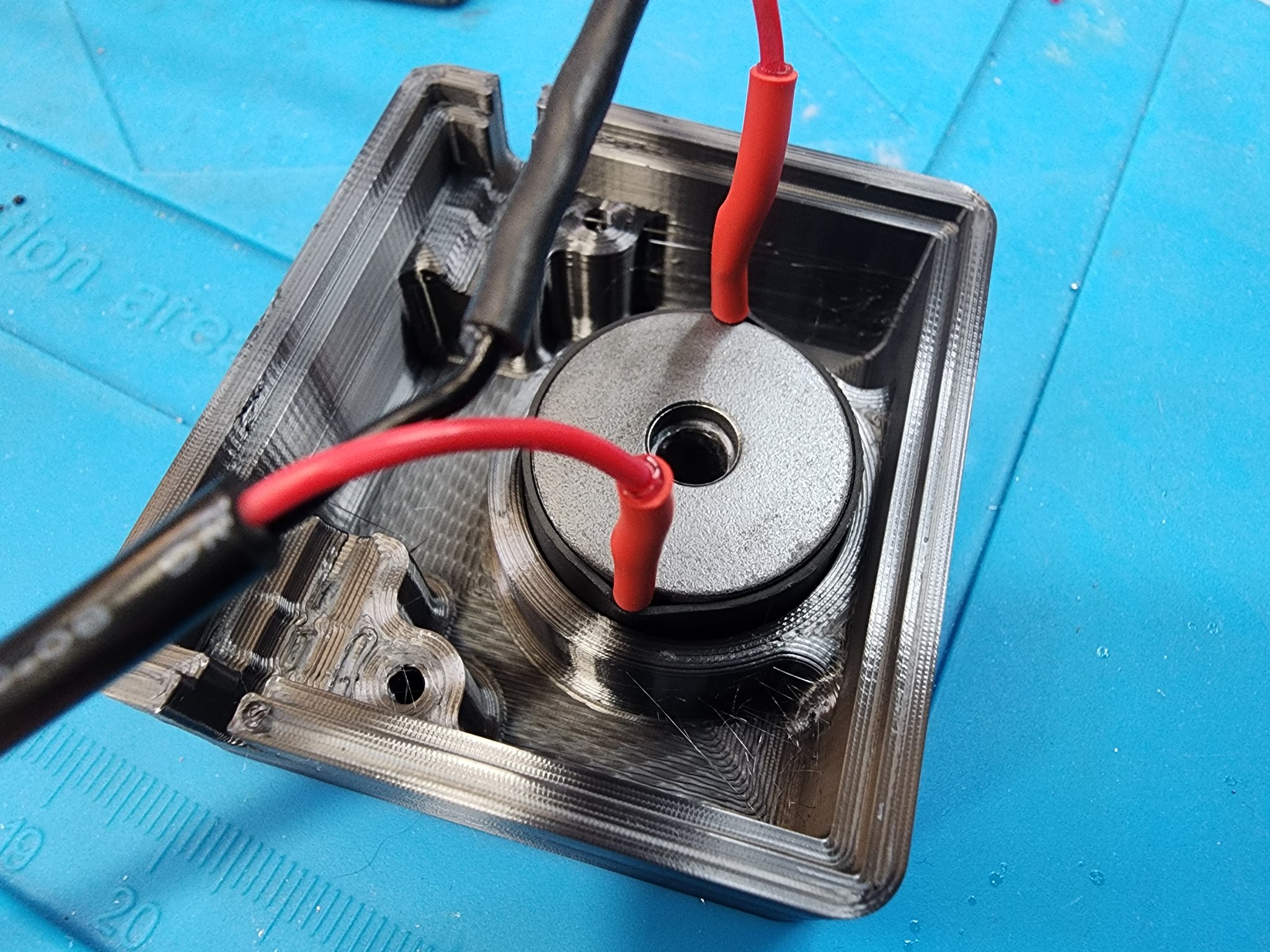

Here's the little mini-Build Guide for how to install the coil in the box.
